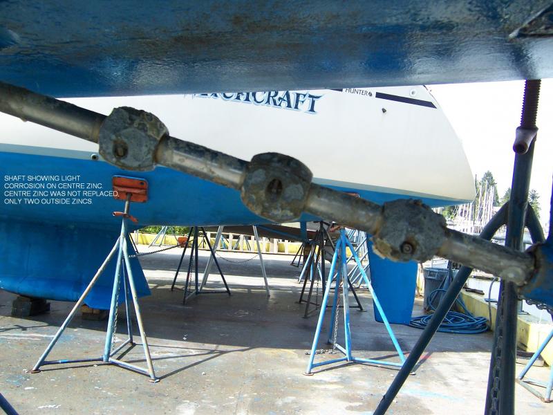

I can only speak for my area which is the cold waters of the Pacific Southwest on the B.C. coast.
I get a full year with three zincs on the shaft. I could probably get away with two but using three is a hold over from the dump I was moored in a number of years ago. There you needed three zincs AT LEAST :eek:.
The outside zinc loses about 30-50% while the middle one is hardly touched and gets several years use.
