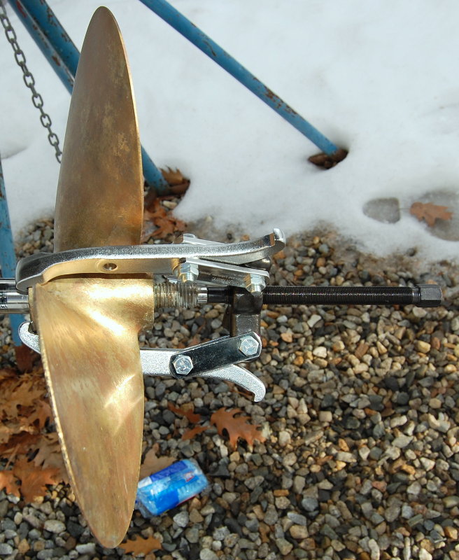

Proper tool for the job notice the nut still on shaft.

Have you seen props stuck so bad that a 3 jaw puller like in your other pic, won't pull it?
What is superior about the specialized prop pullers?
Feb 6, 1998
11,760
[They make prop pullers for a reason. In a pinch a large three jaw gear puller can work on shafts up to about 1"..
Maine Sail ! ! You of all people ! ! Where is the prop nut ?
I needed a shot of a three jaw gear puller (read inexpensive) that would pull most props up to about a 1" shaft but I forgot about the photo when I pulled the prop. After it was off I slid it back on for the pic but forgot the nut.:doh:I need to re-take that photo but ALWAYS mention it when talking about pulling a prop. No nut means potential stitches!! NEVER remove the nut completely when pulling a prop cause when it goes, it goes, POP!

"I needed a shot of a three jaw gear puller (read inexpensive) that would pull most props up to about a 1" shaft but I forgot about the photo when I pulled the prop. After it was off I slid it back on for the pic but forgot the nut.:doh:I need to re-take that photo but ALWAYS mention it when talking about pulling a prop. No nut means potential stitches!! NEVER remove the nut completely when pulling a prop cause when it goes, it goes, POP! "
OK Maine Sail
I will admit I was having a little fun at your expense ! ! Most times your "how to" descriptions and photo's are great ! So let me say thanks for your contributions and hard work that you do on this site ! !
However that being said I will tell you that the few times I have needed to remove the prop it is almost scary to think what would happen if the prop was not contained by the prop nut, They really do "pop" While I never have actually seen or know someone who got hurt doing this it is clear that it could very easily happen.
