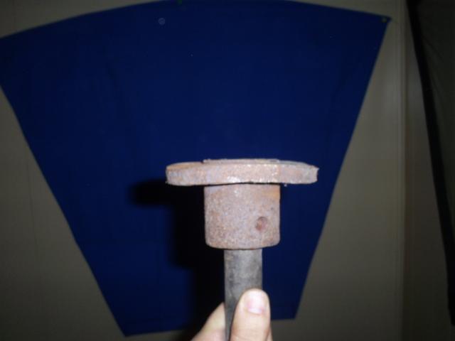

Sometimes no matter how hard you try it won't come off...
After this one broke it was ground/cut directly over the shaft key and then it finally came off..

You've been very, very lucky. I can assure you there are LOTS of non-split couplings that will NEVER come off in a boat. The one pictured above had been soaked in PB Blaster for over a week, heat was applied and the socket trick used. That is what broke the ears off the flange and it could have just as easily been the transmission end that broke which would have been a 2k repair. I watched my friend apply 8 tons of machine shop press to one before it finally broke free. Not going to ever do that inside the boat. If it wont break free be VERY, VERY, VERY careful using the socket technique that you do not break the gear box coupling.
Couplings that rusted should not be re-used anyway and cutting one off with a 4" angle grinder, or Dremel with cut off wheel, by slicing it right over the key way slot is easy.
