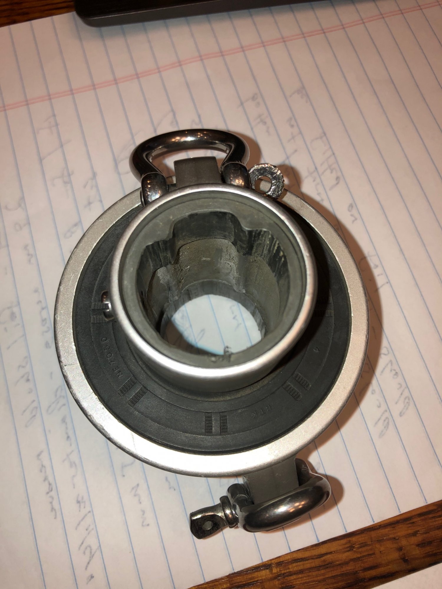

Here is the existing furler, the bottom side that aligns with the luff groove. Note the "shoulders" on the bushing and similar but smaller ridges in the inside of the furler.

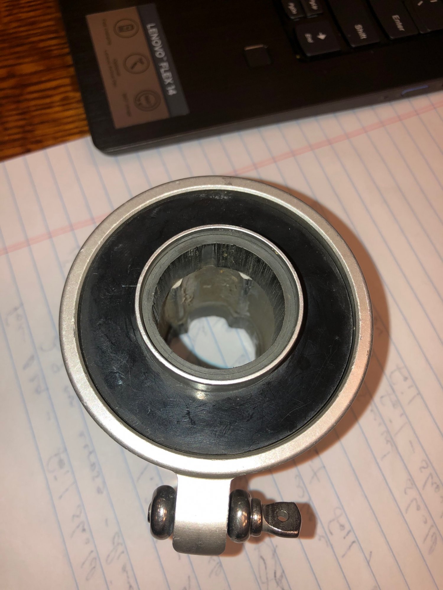

Here is the top of the furler, the part that is free to turn around the luff. This bushing is also free to rotate in its track. It does not have the same shoulders, but the metal ridges inside the furler are also visible in this picture.

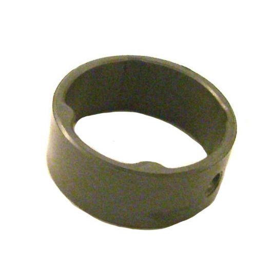

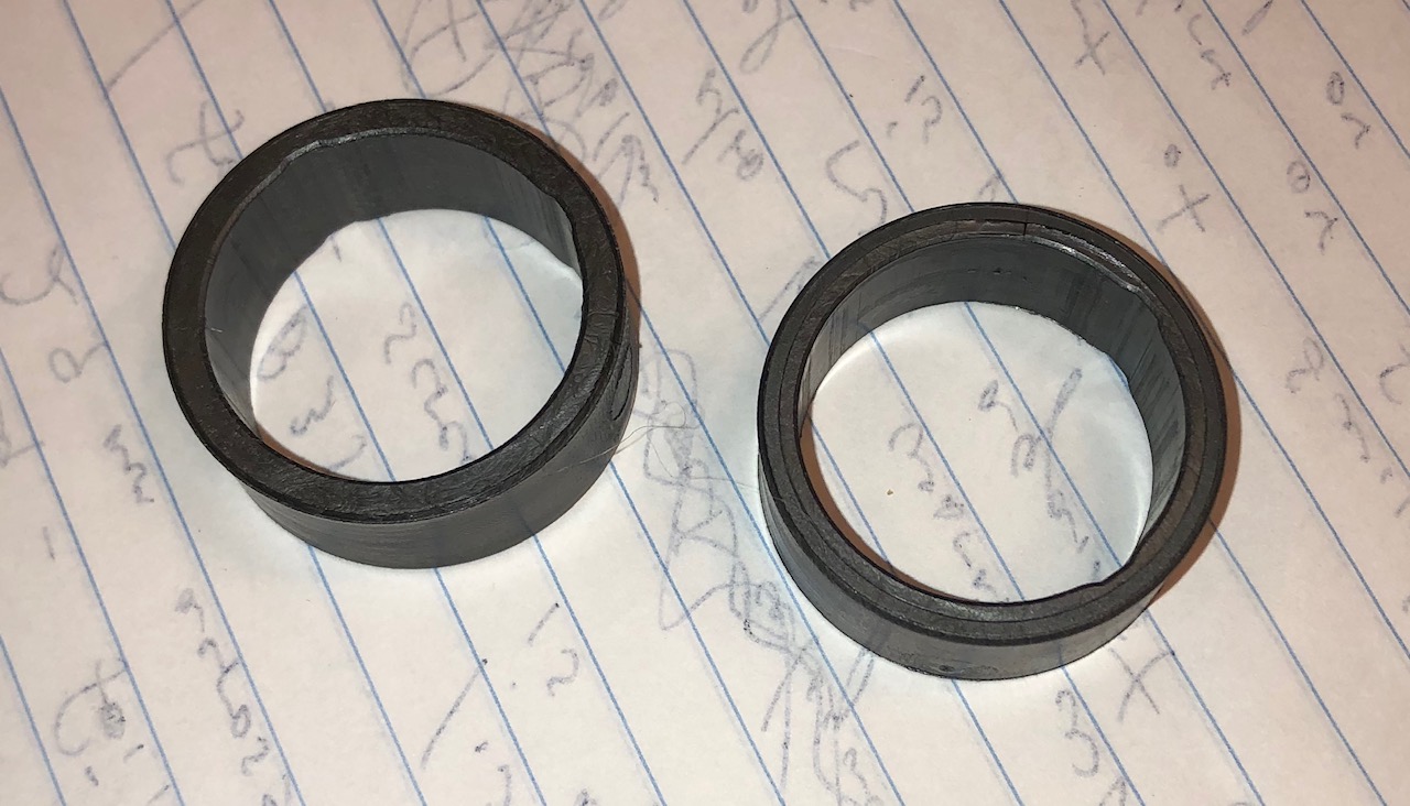

Below are the new bushings I was supplied. Note that they appear to be identical and neither has the "shoulders" to align with the luff groove and keep the lower part of the furler from turning around the luff.
I have two questions for the group:
1. Do I need the bushing with the "shoulders" to make the upper swivel of the roller furling work properly? I think I do, but I don't really know. I have called ProFurl (now part of Wichard) multiple times, and left three messages, but this year they will not return calls. Last year's service was excellent but the person I talked to last year is no longer with them.

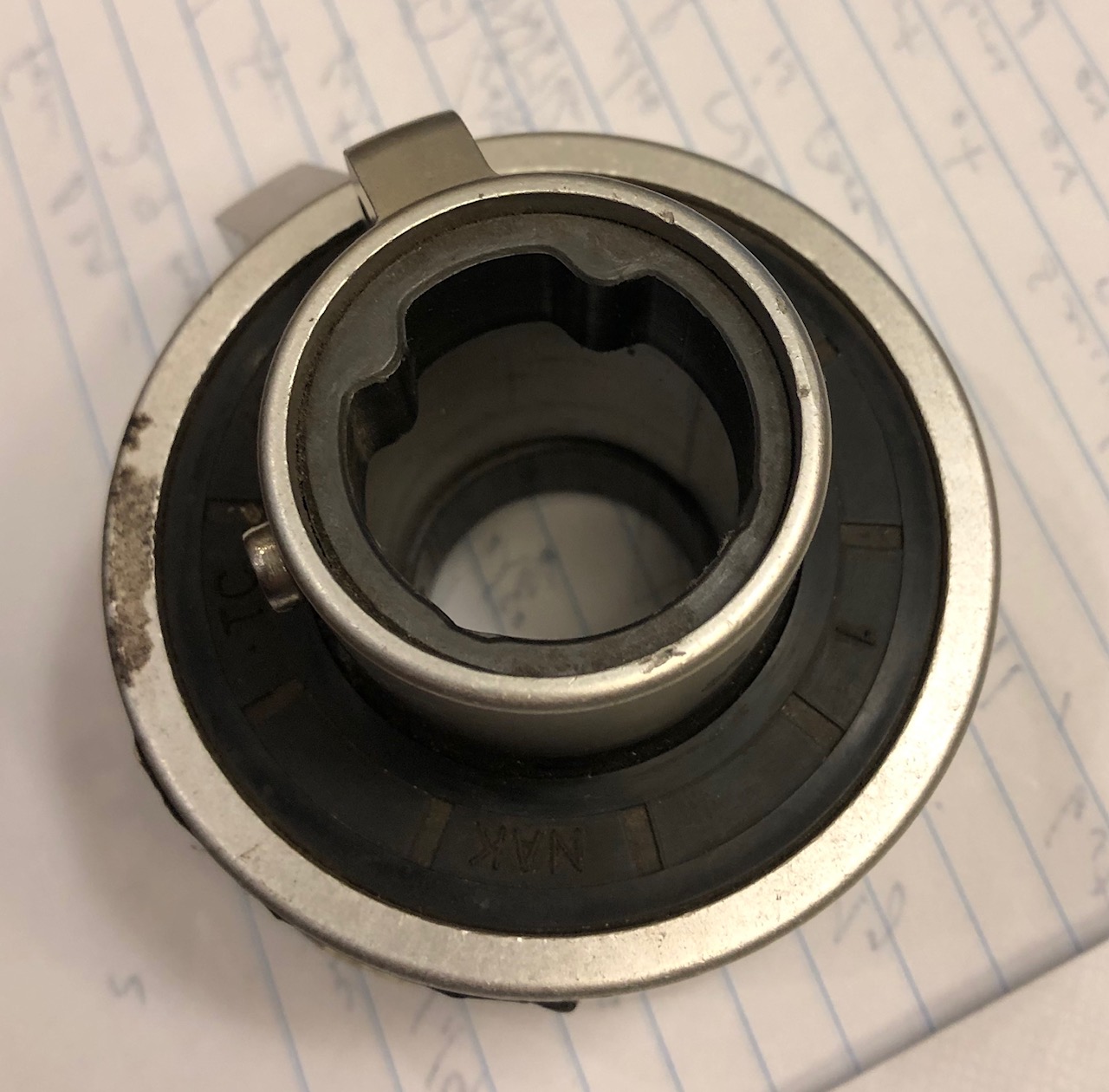

2. I have obtained a nearly identical upper swivel from a friend of a friend of a friend who changed his rig. This second furler looks the same except the inside metal part of the upper swivel does not have the raised ridges inside that my existing swivel has. The bushings in the second furler are in better shape and the swivel appears to less used than my current one. Will this second furler work on my boat? Below is a picture of the bottom half that aligns with the luff and groove.

I changed mine and the bushings without the nubs are the new replacements. The problem with the nubs version is when they wear, the swivel jams on the foil.
The swivel will still function since it will rotate via the bearing but you won't be able to lower the sail.

Just guessing here, it would appear the new bushings are just there to slide on the furler extrusion. Are the new ones a snug fit to the extrusion? Do they properly fit the swivel?
You might check to affirm that the bushings are supposed to be symmetrical. Could the tech guy have sent 2 upper bushings?

jssailem, it would be better if I could discuss this matter with ProFurl, but they have not responded to several calls and voicemail messages. There is no detailed information on their website to resolve the situation. Hence the need for a wide circle of potential advisors.
Both new bushings I have appear to be almost identical to the bushing in the upper half of the upper swivel. They are the same diameter as far as I can tell. I won't know for sure until I take the old ones out and replace them, but they require a press to get them in and once they go in and I can't take them out without destroying them.

I agree they look the same as the upper bushing. That is why I asked the question. Wish I had more info. Do you know any rigging professionals in your area? Perhaps they have run across this issue before and know the answer. Is there a Beneteau dealer in the area that might have an idea?

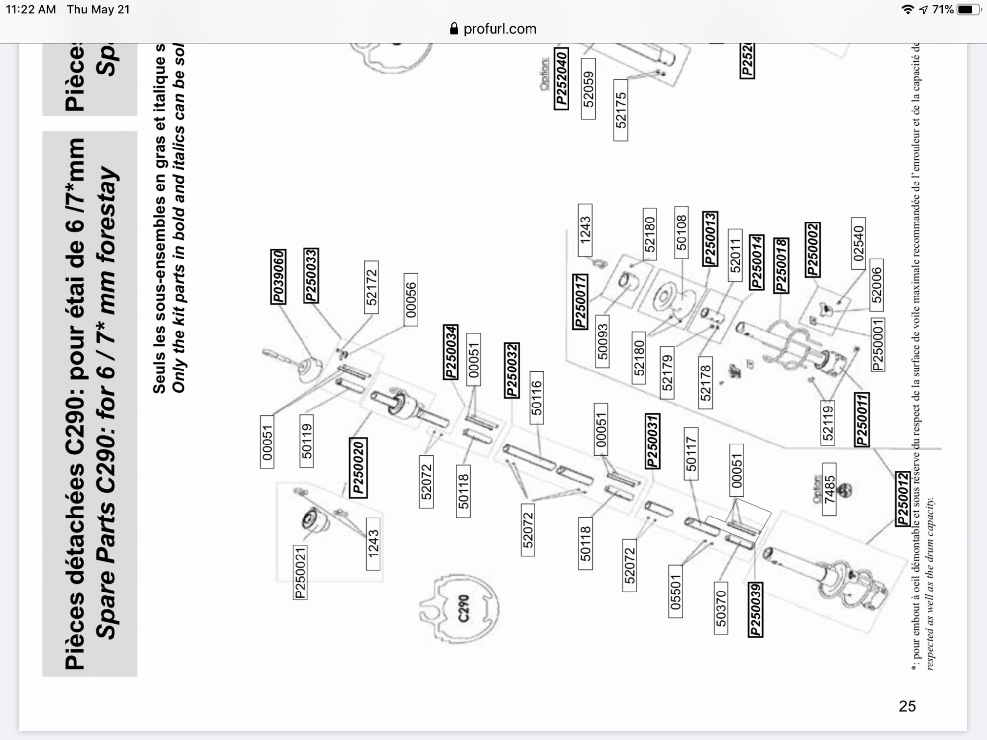

I looked up the manual on ProFurler website... It shows the following parts breakdown. Likely they want to sell you the complete swivel not just the bushings. My guess the lower bushing is a formed proprietary item. The swivel Part # P250021.

Joker460, I'm not sure what you mean. I think you are saying that new replacement bushings don't have the nubs or shoulders to ride on either side of the luff groove, but when you say I won't be able to lower the sail, using the new type of bushings doesn't seem to be a useful solution.
Correct, I was told by Profurl( Wichard) Quebec that the bushings without the nubs are the new style. It prevents the swivel from jamming.
I meant that the old style wears(with nubs) and allows the bushing to rotate and jam on the foil. The furling still works but you can't lower the sail.

I finally heard back from ProFurl. He said on the phone that replacement bushings no longer had the nubs or shoulders that align with the luff groove. After we talked on the phone, I sent him the pictures in the first post in this thread and a similar description of the situation. He wrote that after looking at the pictures and description that he understood the situation and advised me to give the second furler a try. He said he understood my concern about using the original furler that had the small ridges inside without a bushing with the ridges to align with them. So I'll drive out to the yard tomorrow and see if the second furler looks like it will work.
I wrote back to ProFurl that I would try the second furler, but what happens if everything seems OK with the mast, furler, and everything else lying on its side, and when I get the mast up at launch, what if the new swivel doesn't work right or hangs up? Can I take get the furler drum and upper swivel off from the bottom of the forestay and foil (using halyards as temporary stays) without damaging anything? I have some pictures of the furler assembly at the bottom end of the furler. I haven't heard back yet.
It would be nice to have a way out that doesn't involve pulling the mast if the new furler swivel doesn't work out.

FWIW, I had the same issue with my Profurl NC-32. Different design but same problem. Profurl had a design change on the bushing. New part received was completely circular inside and outside. The Canadian Profurl rep assured me it would work perfectly...and would not jam on the extrusion grooves in the future. My mast was down so it was a simple job to disconnect the headstay at the top, slide the swivel out, remove the worn out bushing and pressfit the new part in. A 4-inch vise was all that was needed for the press-fitting. And the rep was right. It now has been 5 years and it has worked flawlessly. Although I must admit that the last few years I have had to use the winch to hoist up the last 1/5 of the jib. My jib is a heavier dacron for higher winds and I am fast getting older, i.e. less muscular power LOL.

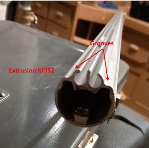

The bushing was a different design than yours but basically same principle. My NC-32 has 2 grooves for the sail luff and the bushing had 2 ''nipples'' riding on the extrusions on either side of the grooves (see pics). The new bushing does not have these ''nipples''.
