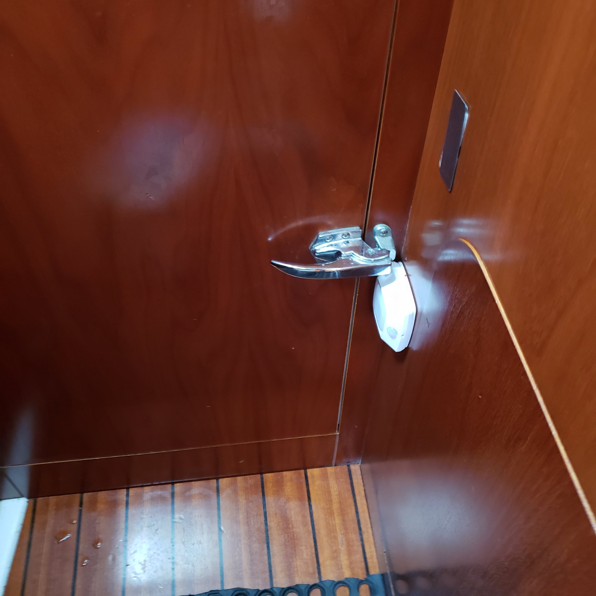

I need a door latch part for my refrig. Does anyone know where I can find that part? Also, my freezer is not freezing. What should I do?

Thanks for the suggestions. What I found was the latch doesn't have a catch to keep the door shut. That metal catch is a part of the door latch system. It should not cost very much. It is a stainless steel part. However, finding that part is the issue.

If the fridge runs but does not get cold at any thermostat setting, likely it needs a recharge. No help on the latch without a picture.
