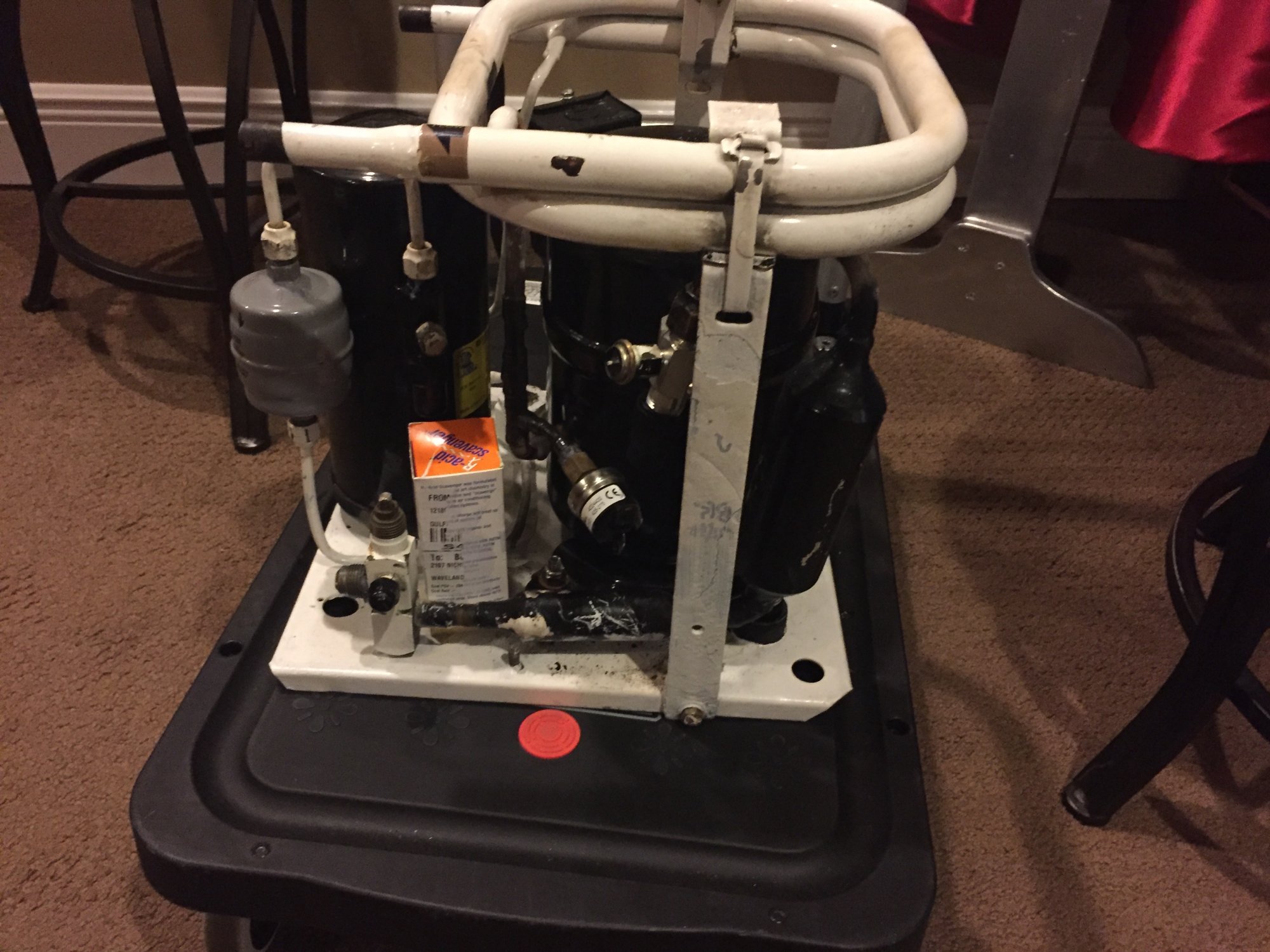

I had to raise my eyebrows a bit on reading this is apparently old school equipment
It is not OLD school at all.
The last Grunert Compressor used, came with 404r.
You can still get one made by a competitor, that the Grunert or Dometic People recommended.
Also Grunert[Dometic] gave me the newest 404r info [Since Freon® 22 has been abandoned from Bad info]
1) Tecumseh Compressor part number
2) Expansion Valves which mine has 2 ie. Freezer and Frig that are dual controlled.
3) The Freon® return filter.
There are sailboats bigger than 40 feet or even Power boats that use bigger Frezzer systems.
I have all that info, for Future Reference, if you need the Capacitor/Relay, in fact I bought a spare, if you need it
Part numbers direct from Dometic.:biggrin:
The biggest issue we had was the Relay had a required orientation in the Power box.:facepalm:
Jim...

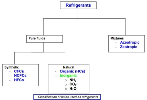

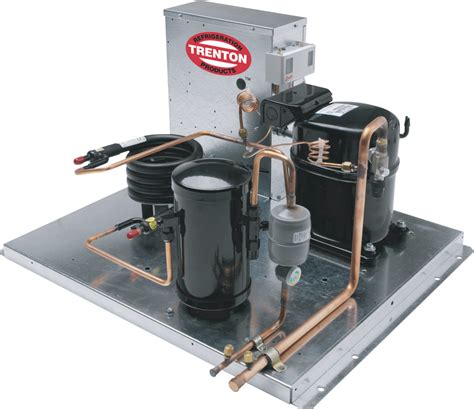

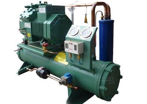

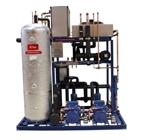

Ah, I should have said old school wiring it was not an inference that the equipment is old but apparently Grunert likes to use tried and true technology that's old IE old school which is okay
Me? I'm retired HVAC business owner 50 plus years and yes I realize on larger boats voltage is usually not
a problem,
12/24 volt systems are quite small
I've been on boats that have walk-in boxes and when my business was thriving we often had cranes lift HVAC units to roofs that are as big as boats !
404a, 134a, 410a, 407, 22, 12, 11, were/are fairly common refrigerants, we no longer call them freon but the name persists, there are actually maybe a hundred or more different refrigerants for diffearent applications
