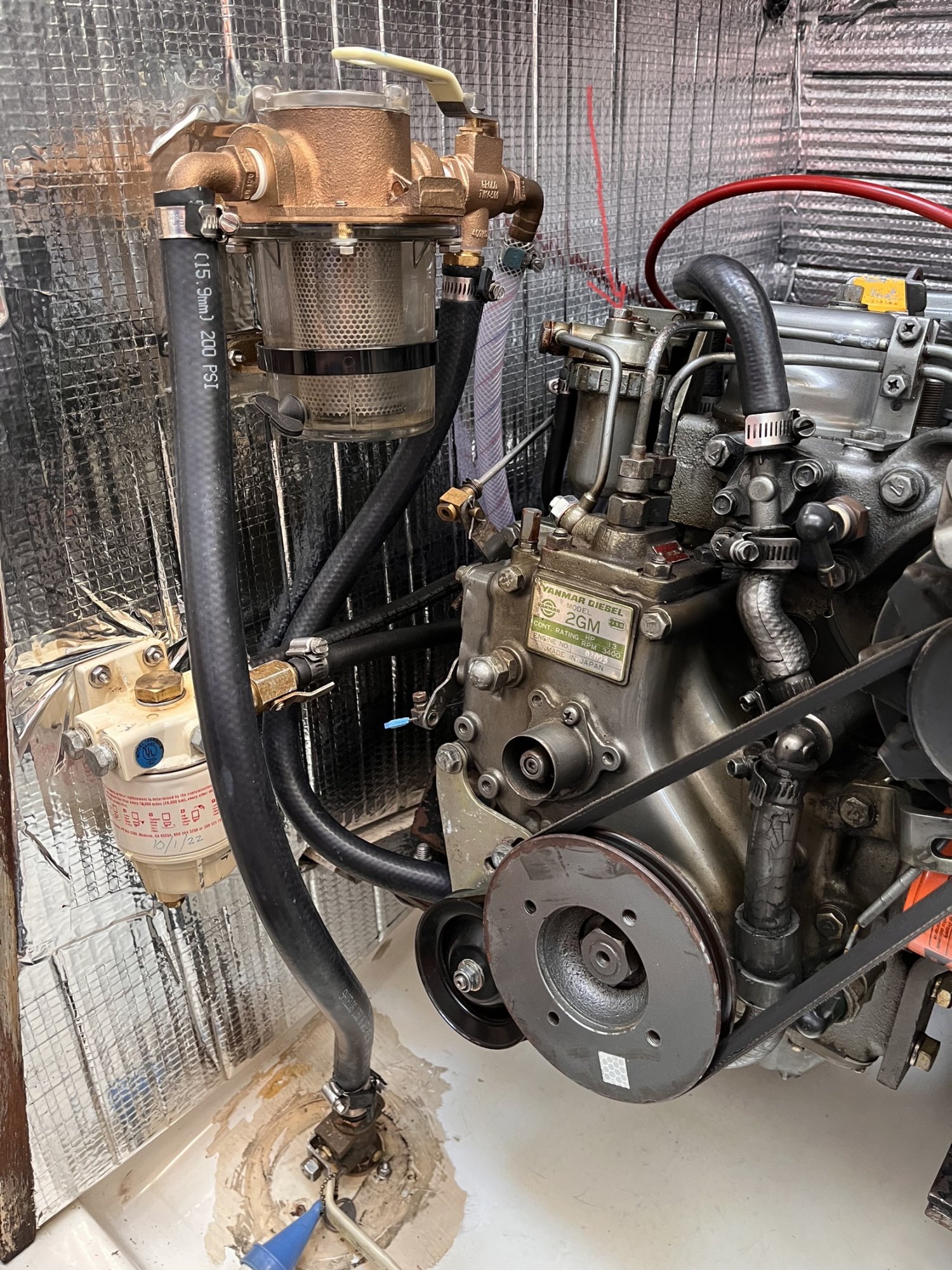

Oct 6, 2007
1,180
Hunter H30 1982 Chicago IL
I hadn’t thought of that. I don’t see how I’d attach the oil extractor to the bleed valve screw though. Does your bleed screw have a bead attachment on top? Do you happen to have a picture of your setup?
Not the ideal photo angle, but all I had on hand. It’s the air accumulator screw at the red arrow. I take it out completely and just the jam the small suction tube into the opening. Then finish with the screw back in and the manual pump. Just minimizes the hand pumping needed. Note also that I have an in-line shut-off valve right at the inlet side of the primary Racor filter to minimize how much line I have to bleed.
