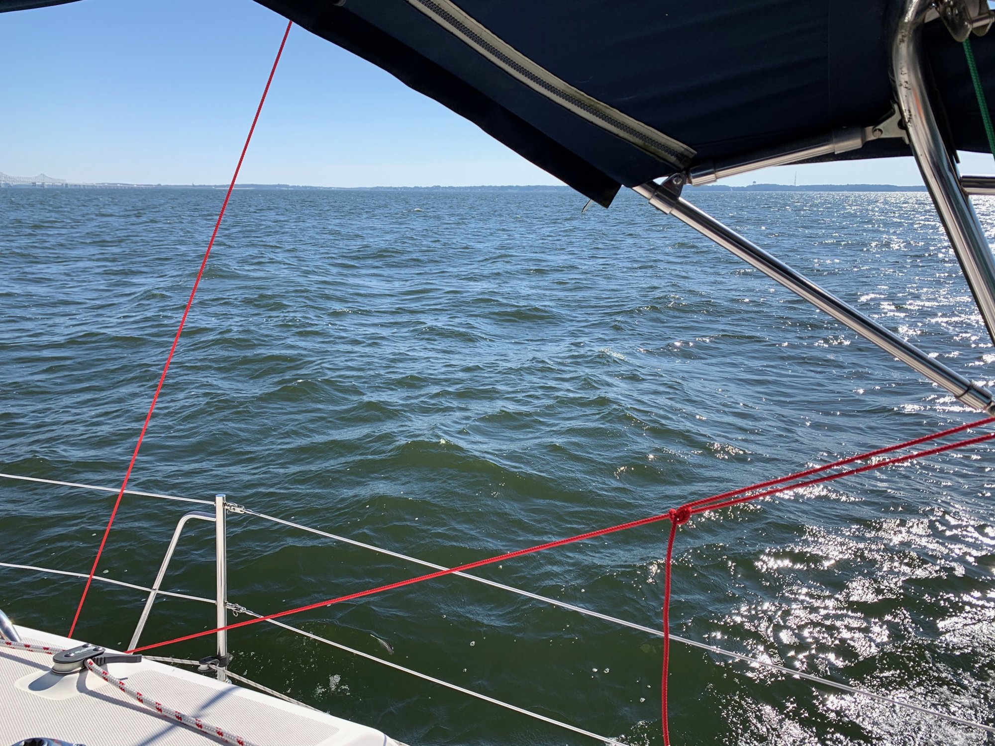

After reading about them for years, I rigged one for the first time on a solo trip last month when I had an all-day downwind run. It went from maybe 2/3 out on the boom, down to the mid-ship docking cleat (through the hole under the cleat) and back to the very sturdy arch. It has always seemed to me that the angle would be much better if it's run to the mid-ship cleat rather than to the bow cleat. Here's a picture. Comments?

Wing on wing? Just don't do it. Slowest point of sail and dangerous.
Unless you are flying a chute, I will bet spending money it is the best VMG downwind for your boat as soon as hull speed begins to limit reaching, if you can set the sails properly (whisker pole). This is commonly misunderstood and as a result, most people aren't good at it. Whether it is dangerous depends on many factors; as I said, for me is it something I reserve for rivers too narrow for jibing. It's safe for that.
