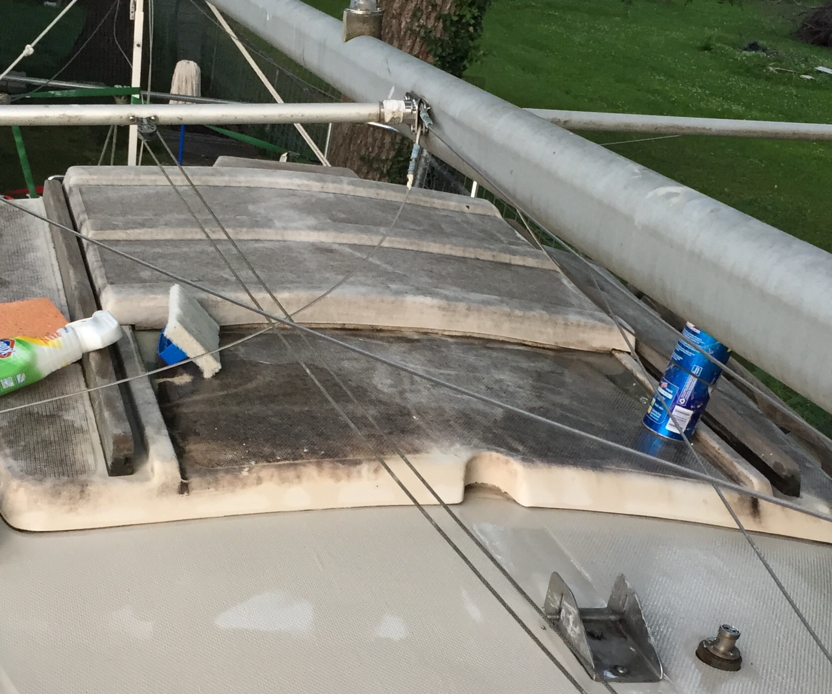

there is nothing on the boat that needs more than around 1000psi to clean it off.... too much pressure will damage the lines and canvas products, and has the potential to blow out the bedding compound of some of the mounted hardware. any of the mold, mildew, moss or black gunk that is growing is easily removed after wetting it and letting it soak for 20-30 minutes, and then a few hundred psi will easily remove it.... the small $79-100 dollar pressure washers are great for boat washing and are usually small enough, depending on the brand, to be stowed onboard.
After sitting under a walnut tree for a few months, all the soaking and scouring powder in the world didn't touch this. My 3100 psi power washer with a 25 tip, followed by a Clorox bath did. The 40 tip is great for lighter cleaning, but the 0 tip can strip paint, decals and skin. BTW, my electric 1200psi machine would only do it on a needle point stream, and that's like cleaning your deck with a pencil eraser.
