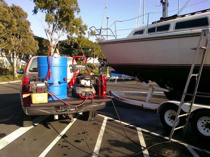

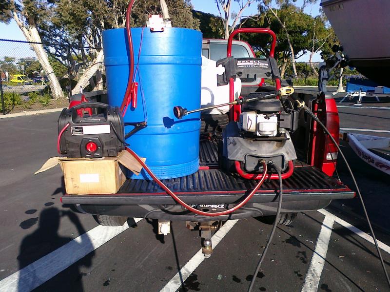

Go for it! I love mine. I have a 2500 psi gas driven washer. I has a 5.5 hp Honda motor. I lucked out at Home Depot. I bought it for $125. It was marked down about $100 because the box was opened. Someone bought it and returned it. Everything looked like it was there and the floor man reassured me that if it did not work I could return it. When I got it home I unpacked the box and found about $100 worth of accessories.
I bought it originally to wash my truck but found it works great on the boat. Like you I was hesitant to use it on the gel coat. I use the 15* spray tip and it cleans everything. I used it to strip the loose paint off the trailer and it remove all of the paint except the primer. I have used it to strip varnish off from teak after retreating with paint remover.
I especially have found it useful at the marina to wash the Cat 27. It has a 25 ft hose so I can do the whole boat without moving it. Our marina has coin operated wash stations that only take 1 quarter for 1 minute of water. I am able to fill up one of their 50 gallon water barrel that they use for trash cans. They put a liner in them so they stay clean. I can fill one up for 50 cents (takes it right to the brim. I take it back to my boat space in Mast-up on the tailgate. The first time I used an 12v water pump to supply water to the washer. The second time I used a sump pump laying around the garage to pump the water much easier to set up. It only uses about 2 gallons/minute so the barrel lasts about 1/2 hour.
