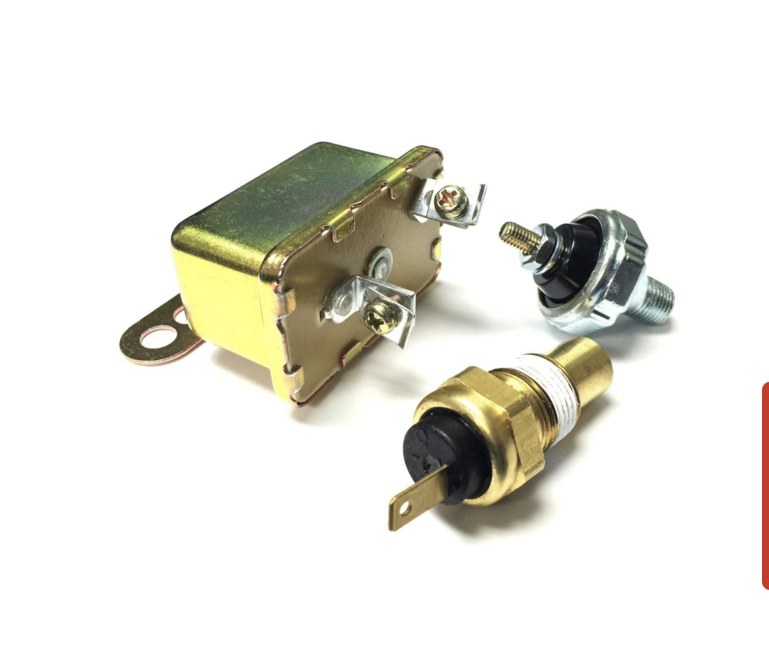

Is there any place to install a Sierra MP41400 Pressure/Temp Audible Warning Kit on a 5411 international diesel?

And here is what Catalina Direct says.
2) Universal never provided an upgrade to add a temperature switch to the early 5411 engines, so we do not have a ready-made solution for that engine.

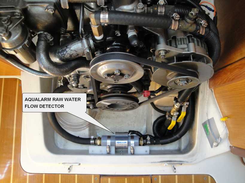

Something which beats an Aqualarm Wet Exhaust Overheat Alarm Kit is the Aqualarm Water Flow Switch which informs you immediately when sea water stops flowing :

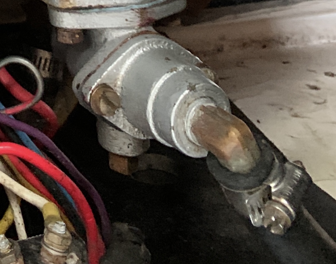

I have this female 3/8” mpt threaded port before the thermostat on the housing that I was thinking a that’s about using for the cooling water sensor. I am not at the boat so I don’t know where the existing sensor is located but I am assuming it is on the side of the engine block and might be a better place but worry about getting a air bubble in it at the tee if I would to add another sensor.

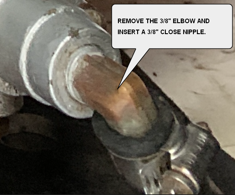

Hopefully you're on to something.
First question is "Where does that hose go to" and does it see a constant flow ? If it does, you're in luck.

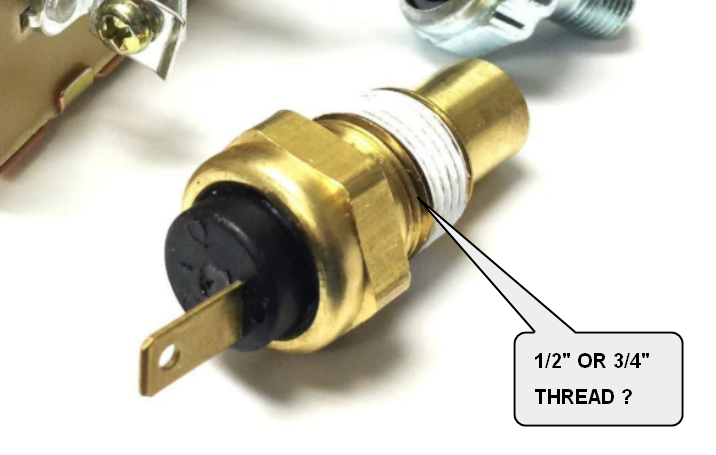

The next question is the thread size of your temp. sensor ?
If this is worth pursuing, insert a close 3/8" nipple into the fitting :
Using an appropriately sized tee (to match the temp. sensor) and reducer bushing, the whole mess of fittings could be made quite compact for the location.
Still a number of "ifs" to be answered if this is to work. Good luck.

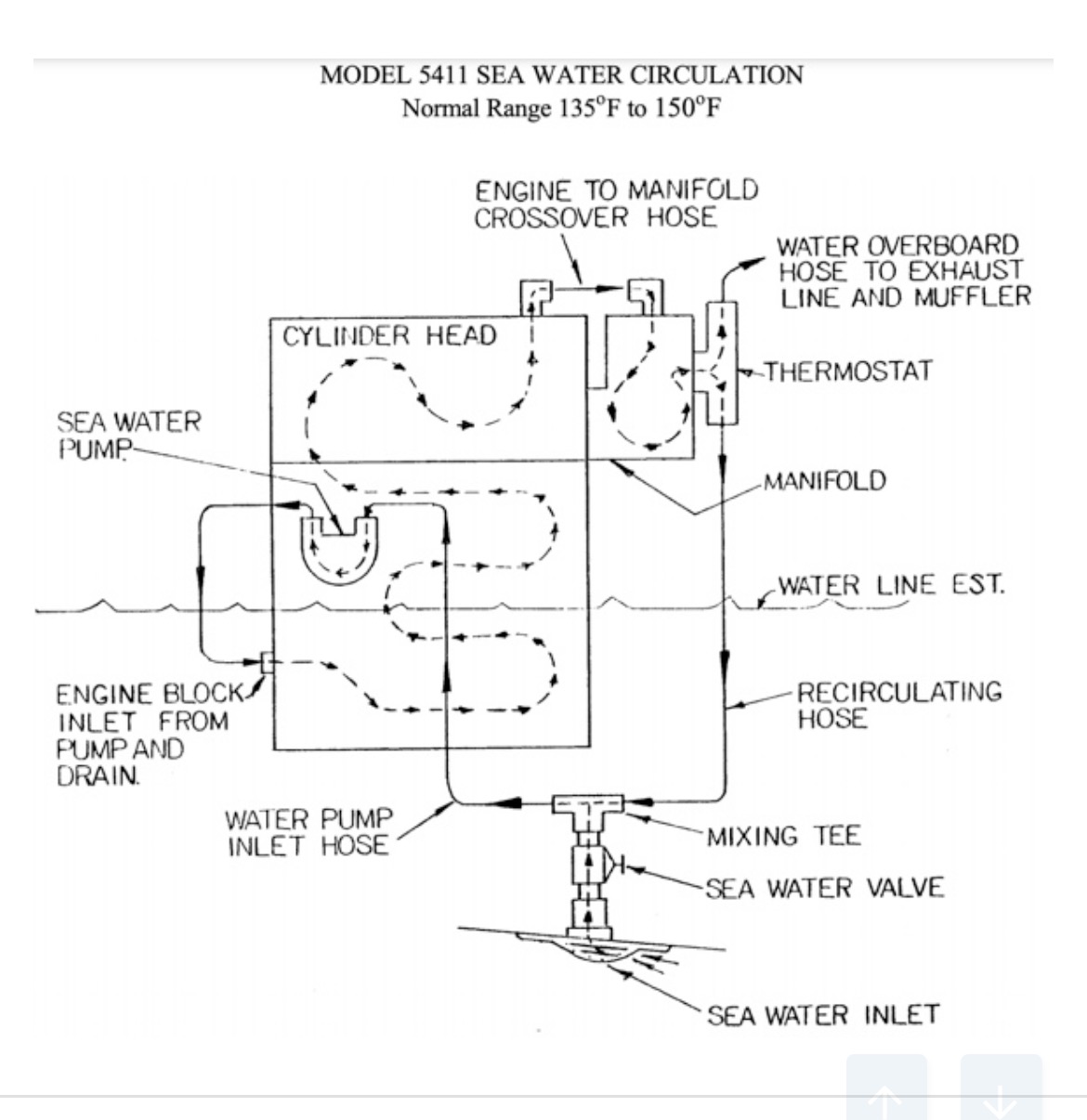

Oh, I was wondering about 4511 runs 135°F and 150°F and the sensor is set at 200° F I am in fresh water.
Sep 28, 2025
130
Catalina C 30 MK1 1983 Stockton Lake Missouri
Page 12 of owners manual
An alarm switch shouldn't activate at normal operating temps (135°F–150°F). It is there to warn you if the engine is actively overheating, so a trigger point around 200°F provides a safety margin before catastrophic engine damage occurs.

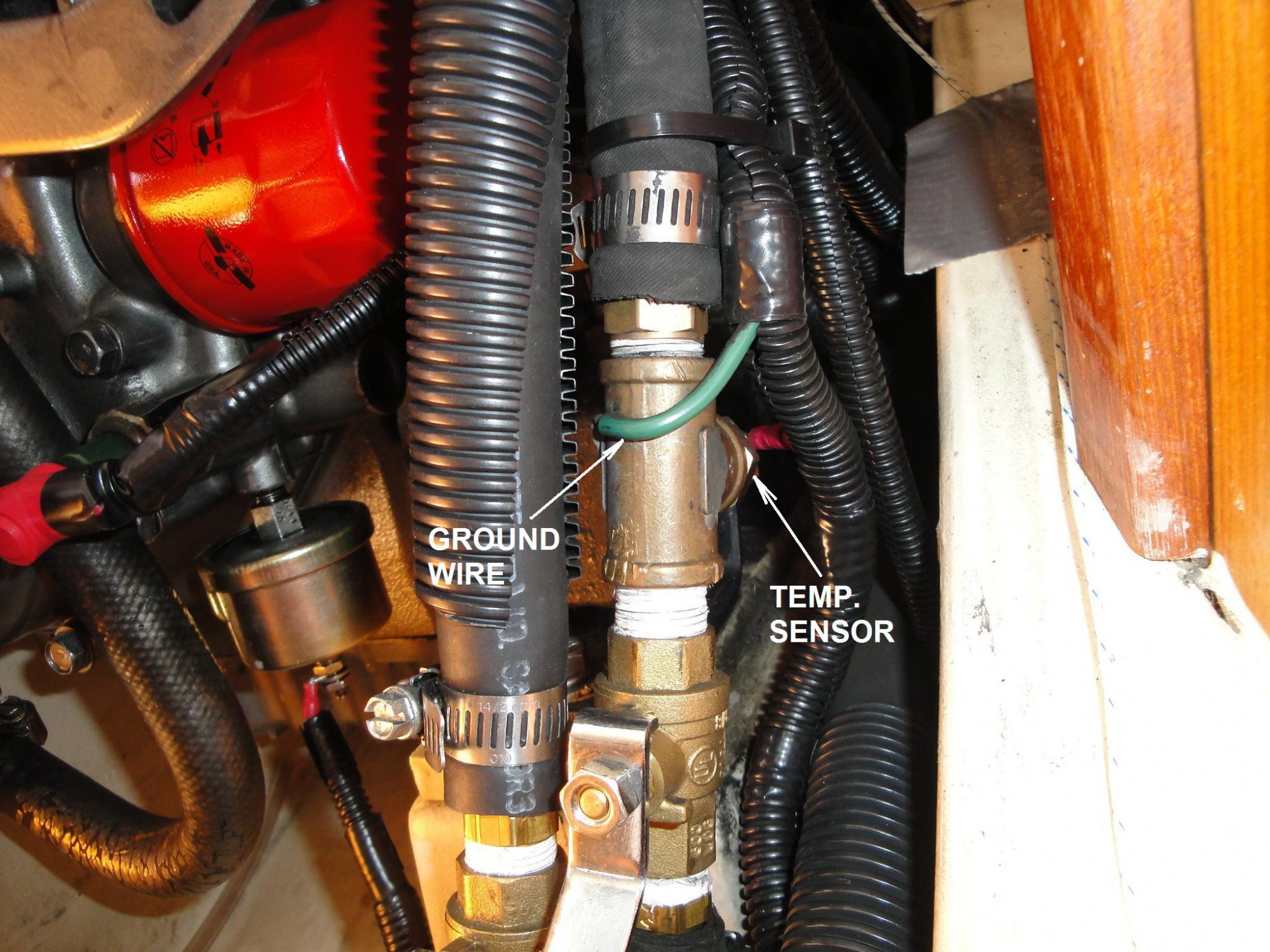

I've got this nagging feeling that it would always leak over time because of the imperfect mating between the threads. Also, with all that tape in there you're not going to get a good ground. You'd have to run a bit of a detour to a good ground. Seeing as how my sensor is completely insulated from a ground by the hoses, I cheated and ran a soldered ground off of the brass tee and back to the block :

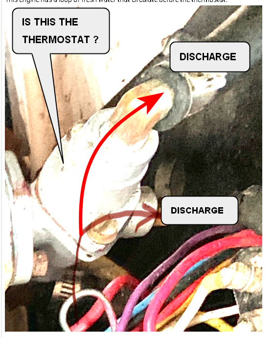

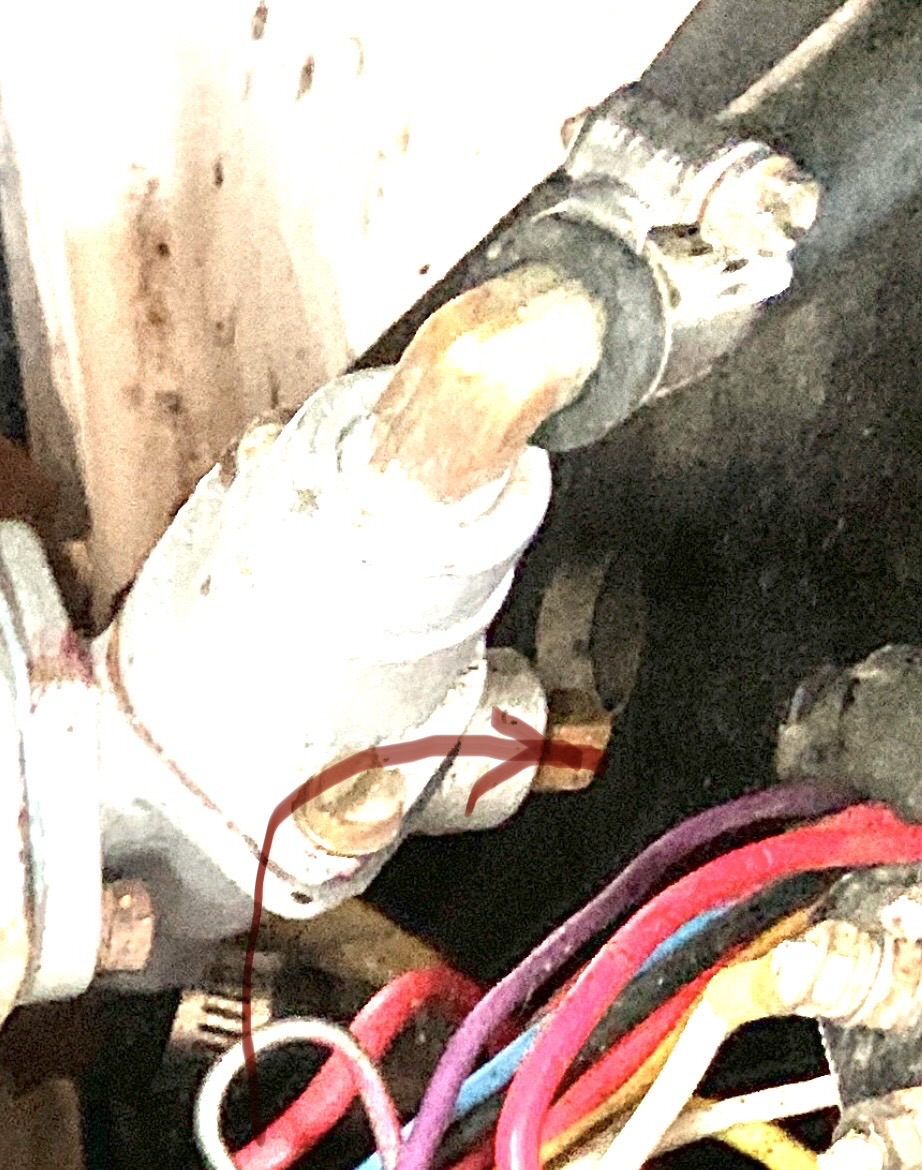

This is going to be a couple of trips of discovery and install. Continues water flow close to the highest temperature source after the engine water crossover and before the thermostat with two appropriate connections.
This engine has a loop of fresh water that circulate before the thermostat.
Jan 4, 2006
7,856
If I'm interpreting their drawing as they intended, either of those hoses would be handling the hottest cooling water to leave the block.
