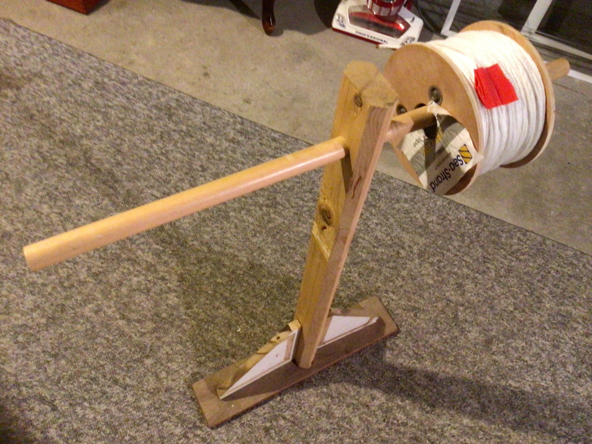

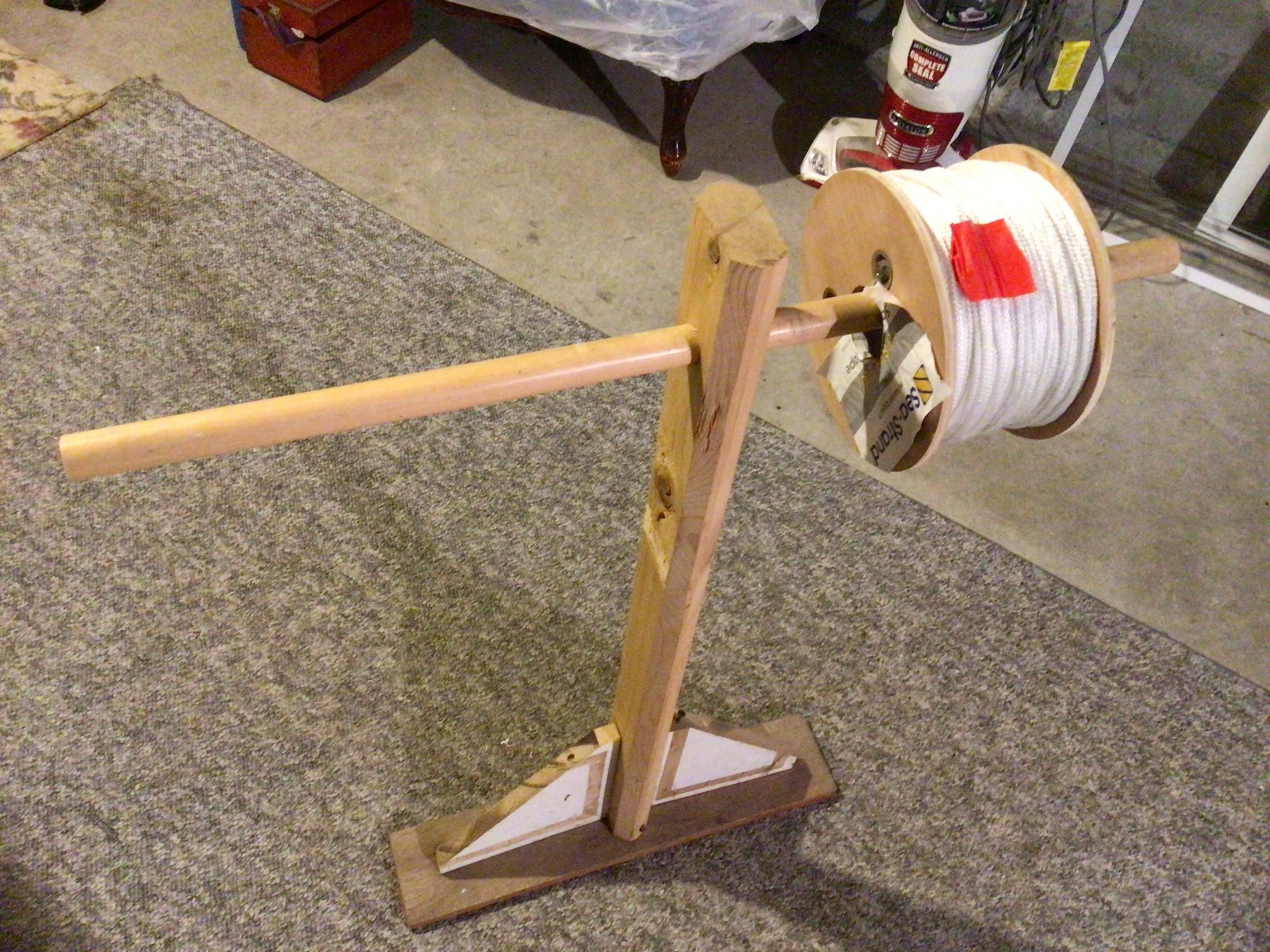

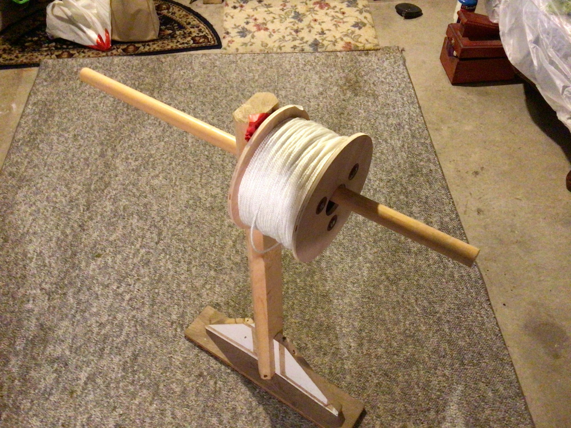

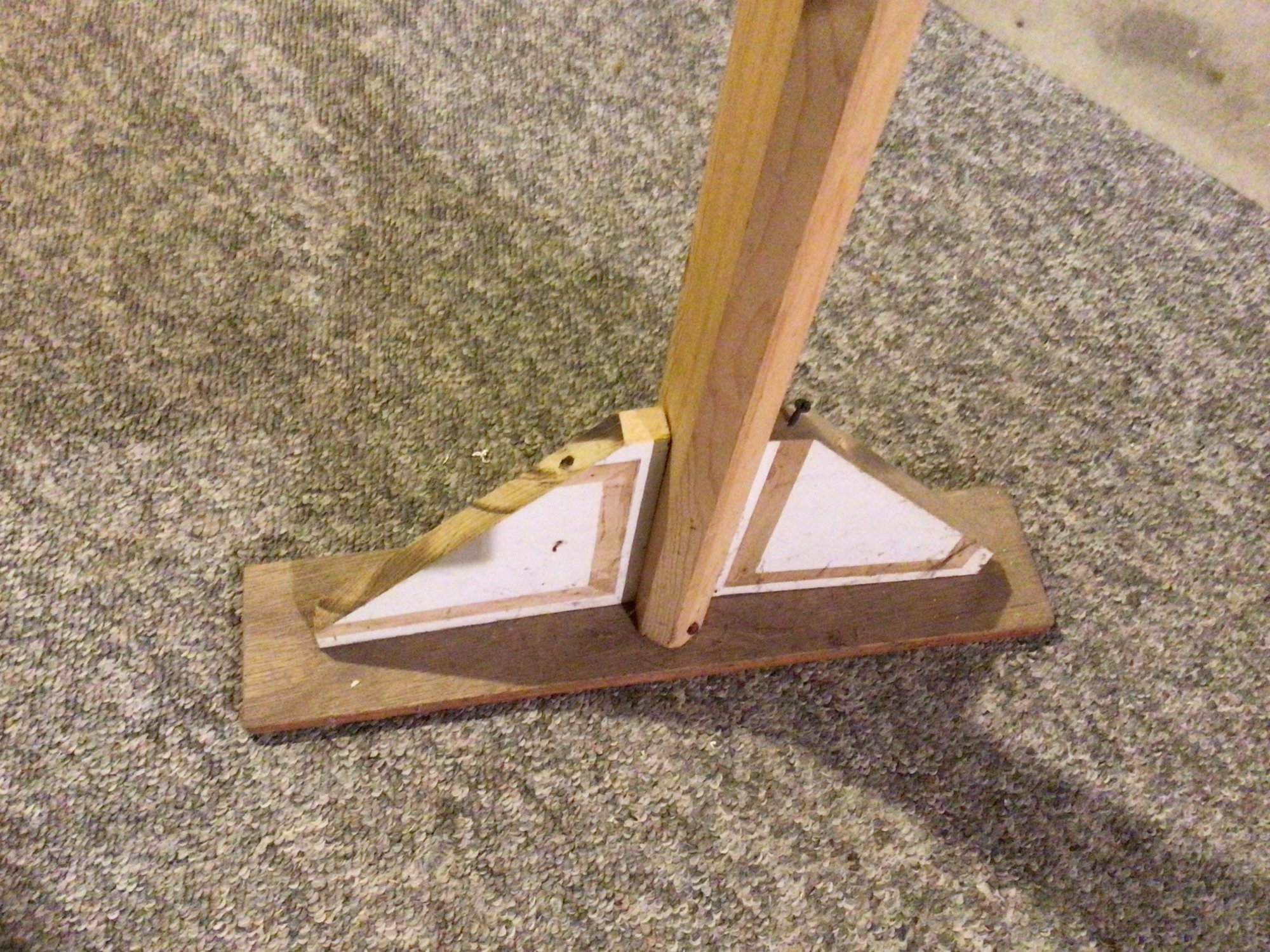

If you plan on taking the wheel home to it. Build yourself a stand similar to this. Helps to hold the wheel in front you as you spin it while lacing it up. Nothing but some scrap wood, 33” high, dowel that fits the wheel you have and comfortable for sitting in front of it. And doubles as a stand for all kinds of this things.

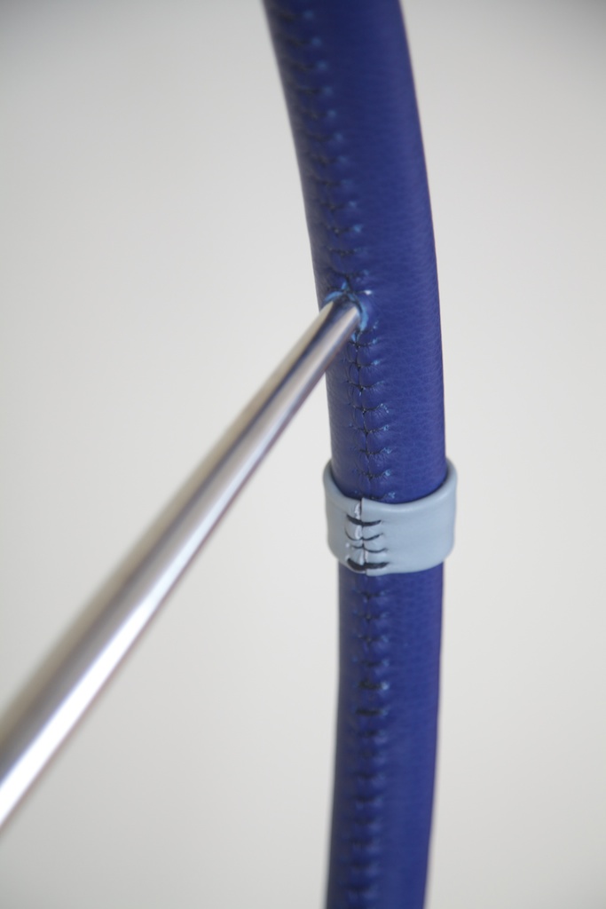

Navy Blue is the one we have on our boat. It was a great project to take on. I’ll share a couple of pictures of ours for you to see. Bear in mind, it is 24 years old, but all things considered, it has worn very well. They’re not the clearest of photos but look close and you will see where the blue coloring has worn. But the leather itself is still as thick as new.
I don’t think you can go wrong with your decision. I would also suggest to you that you get the foam padding as well. It gives the wheel an added thickness and more comfort.

How long before the color began to wear off? Can it be touched up? Boatleather hasn't responded. They should be back from their voyage.
Sep 26, 2008
812
Hunter 340 0 Wickford, RI
I first started to notice the color loss about 3 years ago. My guess is sun and wear from my sailing gloves. I never looked into trying to recolor it.

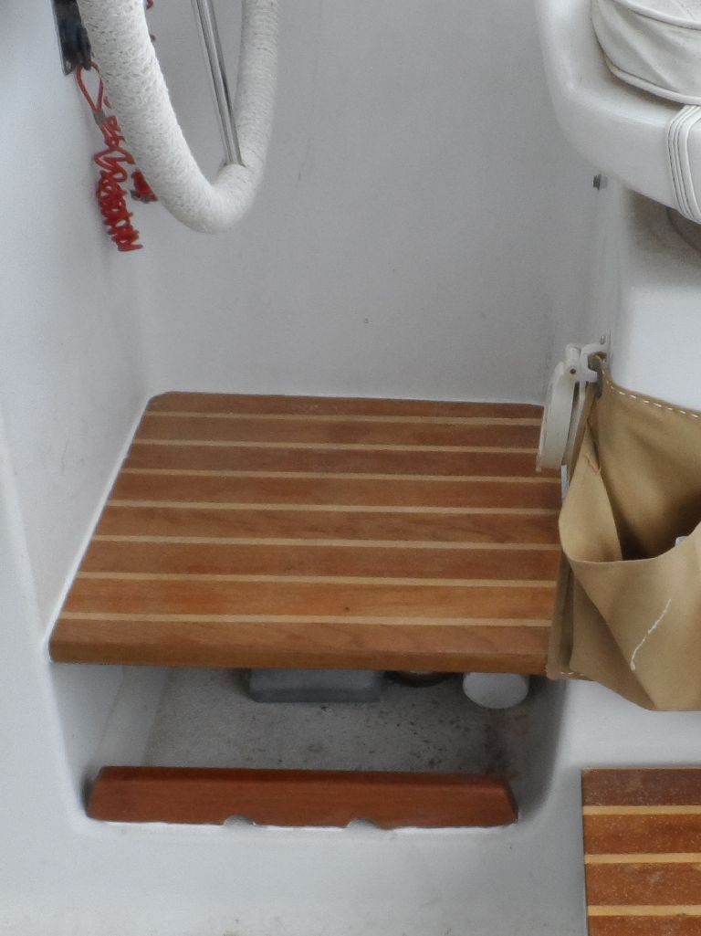

Is that a wood or other material table I see in the photo? Where can I get one of those?
