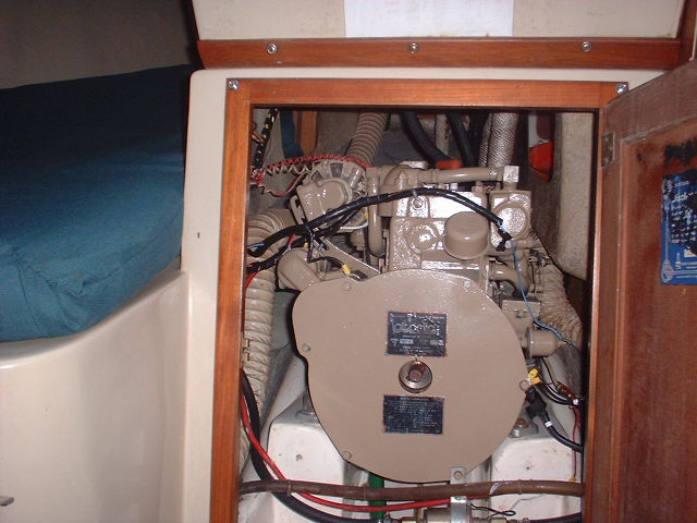

I just had my 1982 27' Catalina's atomic-4 rebuilt by a local ship repair shop at the cost of nearly $5,000. I did test sailing and found out that its power was too weak to drive the boat, only about 2 or 3 knots. The power is even weaker than what it was rebuilt before. And it smoks!! Can someone tell me how to justify the quality or performance of the rebuilt engine. Repair shop said that the engine itself is working fine. How can I argue with them without any preformance data? I thought that the repair shop should provide me the performance data such as compression raio? Any advise?

Nice Paintjob
Leon: Ouch..You may want to do a quick compression check (get a gage from a friend..pull the spark plugs and run the gage through the 4 cylinders turning the engine over with the starter...Should get good compression....Could have screwed up the spark with the distributor...This could be your lack of power due to bad timing and be contribuiting to the smoking problem.....Your rebuilder should stand behind his work...Engine is 30 horsepower and a Cat 27 should do better than 6 knots when engine is going at about 2/3rds rpm...Good luck...P.S. specks on engine can be found in the archives of this site or from Moyer marine...

I'm not sure, but in taking a second look at the photo, there's something that doesn’t look right to me I don't think a good shop would paint an engine in this manner. I mean they painted everything, including the alternator (which will make it harder to relieve heat) and they painted the rubber hose between the thermostat and the raw water manifold. They even painted the rubber hose to the flame arrester and they painted the oil pressure sender unit. (I’d want to know if my hoses are cracking under that layer of paint.) I hope I'm wrong, but to me it looks like they told some kid to, "go paint that engine," or even worse, because they so overdid it, they didn’t do anything else but paint it. If they did a proper rebuild (relax, they probably did) and it starts and idles more or less okay, and just lacks power underway, check the routing of the spark plug wires. An A-4 can run well enough to fool you into thinking it's something else when it's only a crossed spark plug wire. Nick "Julia Bell C-27, #86
