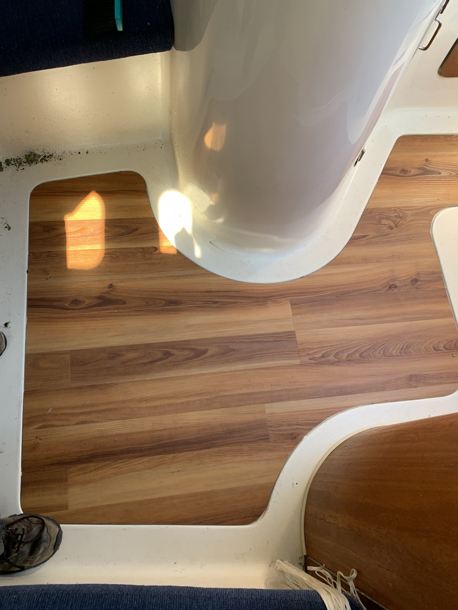

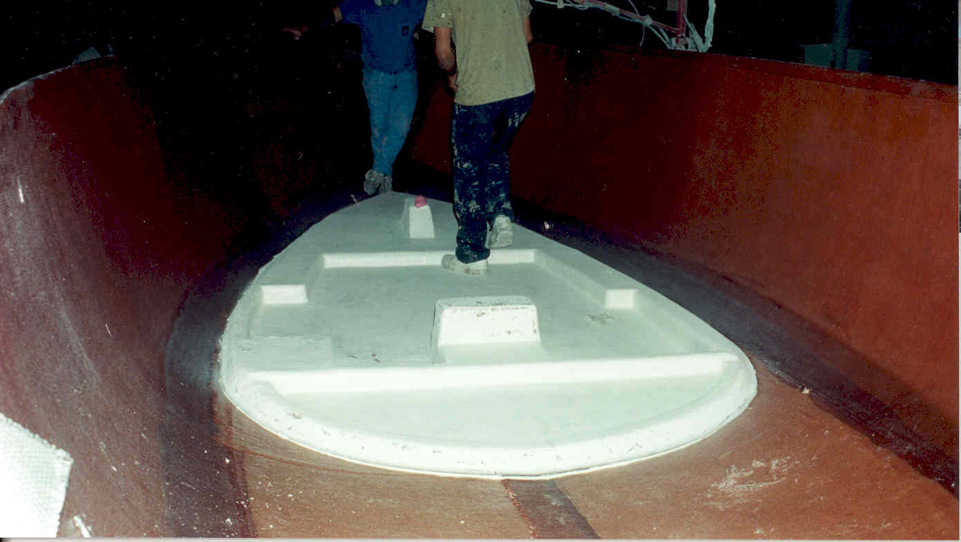

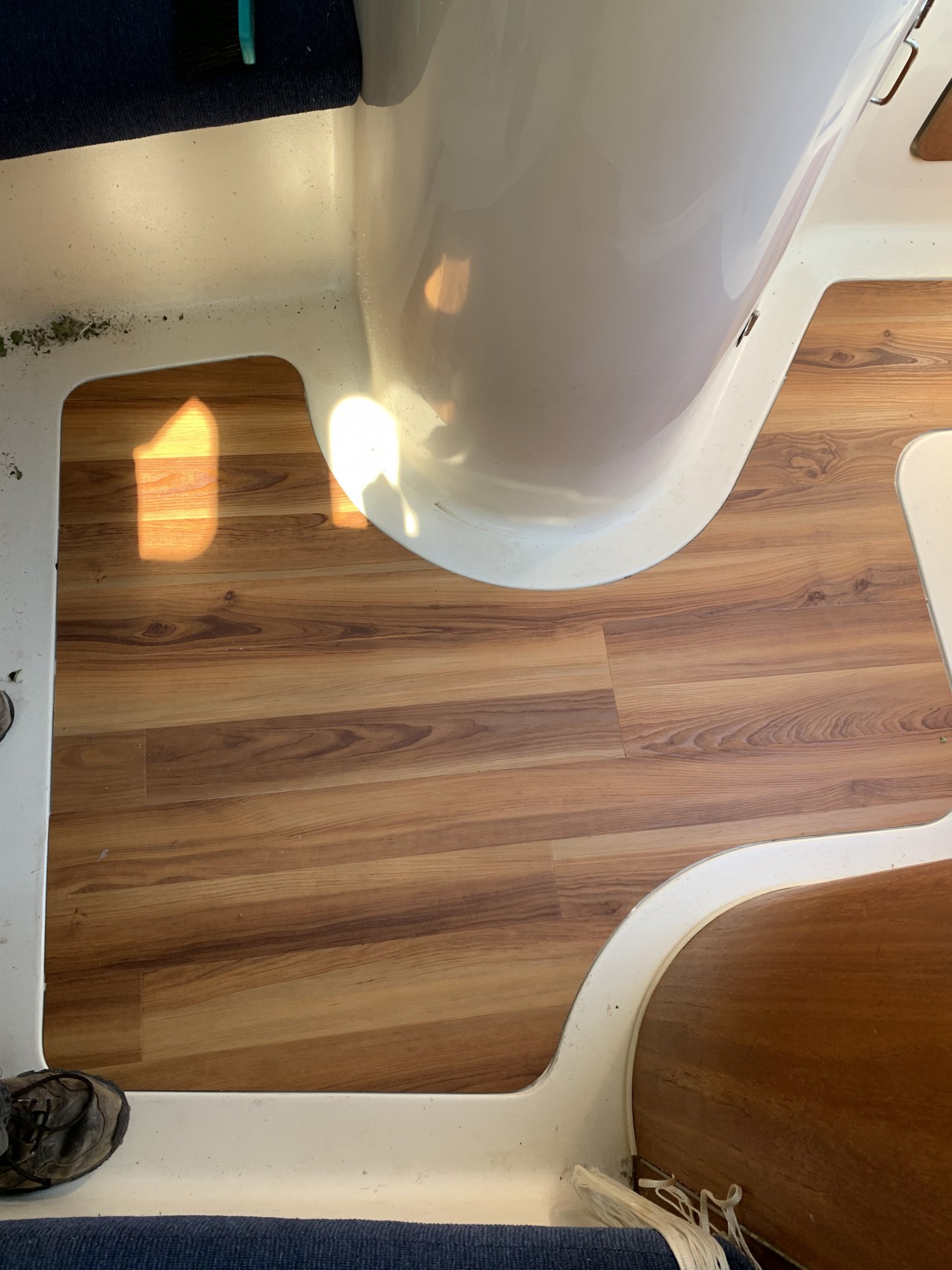

The cabin sole on the 260 is fairly thin and supported primarily by the top of the ballast tank - I believe with dollops of fibreglass filler material. - if you lift the access panels under the aft berth you can slide your phone in to get a photo of how it’s structured. On ours the sole is soft when on the trailer but firms up when in the water with the ballast tank filled and sealed. You might want to check that the gasket on the tank drain is in good shape, that the upper drain plug seals properly and that the seal/washer around the drain rod are all in good shape.
One other thing to check is to see if the issue is really just the plywood insert in the galley/head area or the underlying fibreglass structure. On our 2004 the original teak and holly ply had delaminated due to exposue at various times to rain water that entered via the compression post, companion way slider, opening ports etc or condensation that formed in the off season. We replaced ours with a vinyl laminate floor plank. You could likely replace the ply with slightly thicker ply. I believe the original is 1/4” or so.

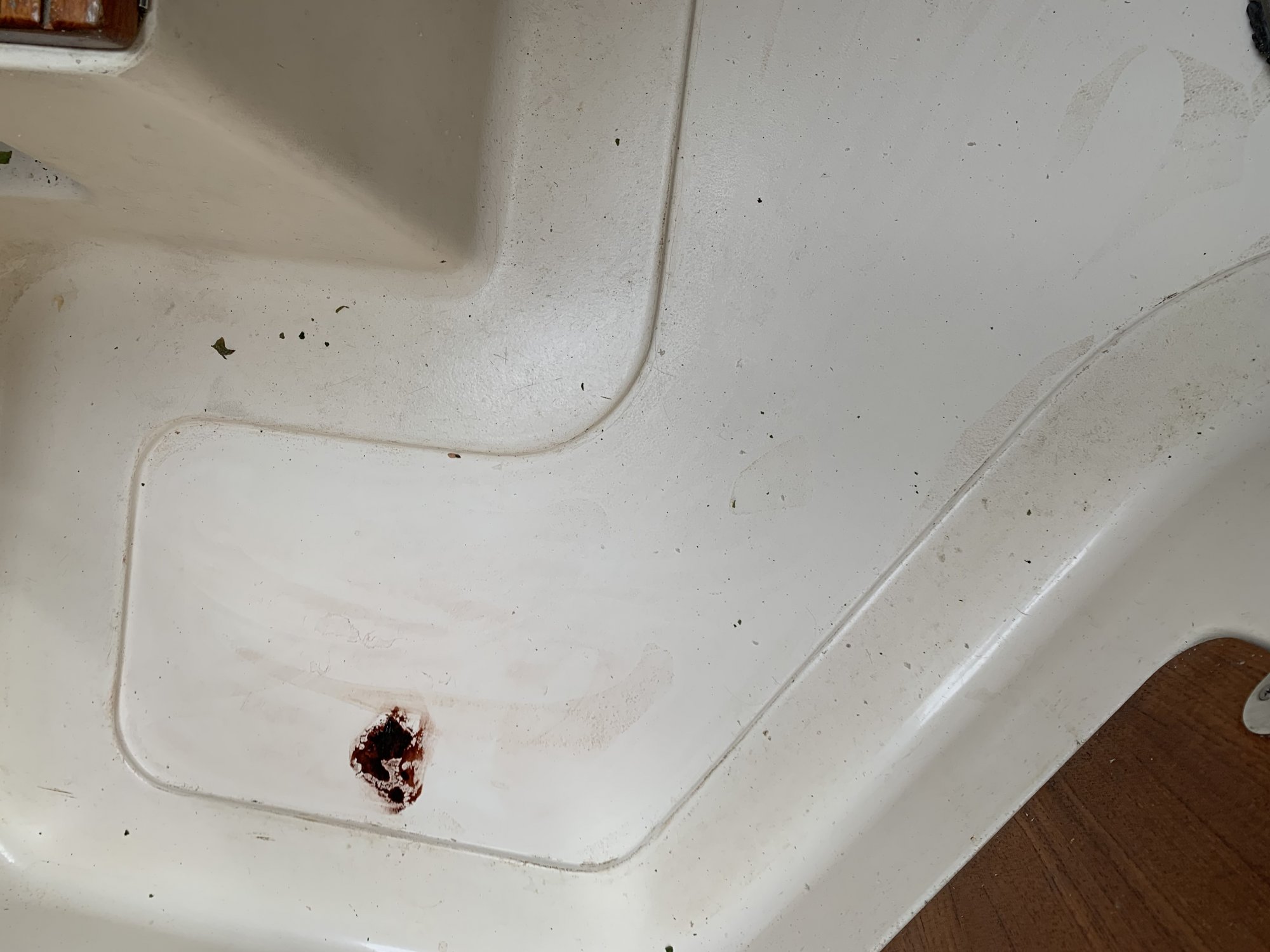

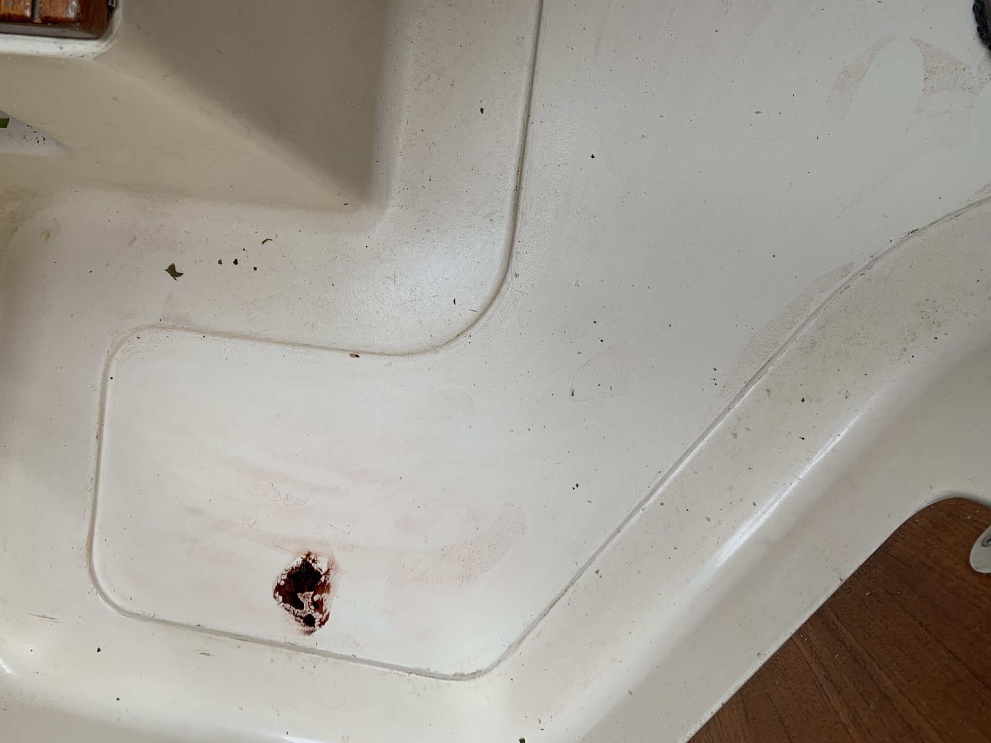

The floor pan is one solid piece which is recessed for a teak and holly sole or floor. The sole was glued down with liquid nails with a bead of Dow 795 between the lip of the sole and edge of the floor pan. If the bead was broken, water got beneath the teak and holly sole causing the sole to rot Later the sole was made out of composite materials. You would see water coming up from the bead.
However, if you hear a sloshing sound , then the marine putty between the floor pan and water ballast tank lid has broken needing tepairs
