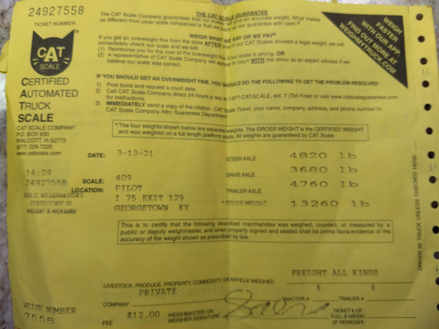

I have a H260 and am reluctant to try towing with my Toyota Highlander (5,000 lb rating). I rent a U-Haul pick-up in the spring and fall when I launch and haul out for the winter. I did weigh the boat/trailer when I bought it- the trailer axles were 4,760 lbs with motor on the stern. I did not disconnect to weigh the truck separately, but I think there was at least 500 lbs on the hitch, so figure about 5,300 lbs total weight minimum. No gear other than the sails.
Thanks for the info. I have pulled at the limit with my Explorer ST, and I didn't really enjoy it. I'm looking at getting a truck first. I'd love to just get a boat and keep it in the water, but circumstances require otherwise.
