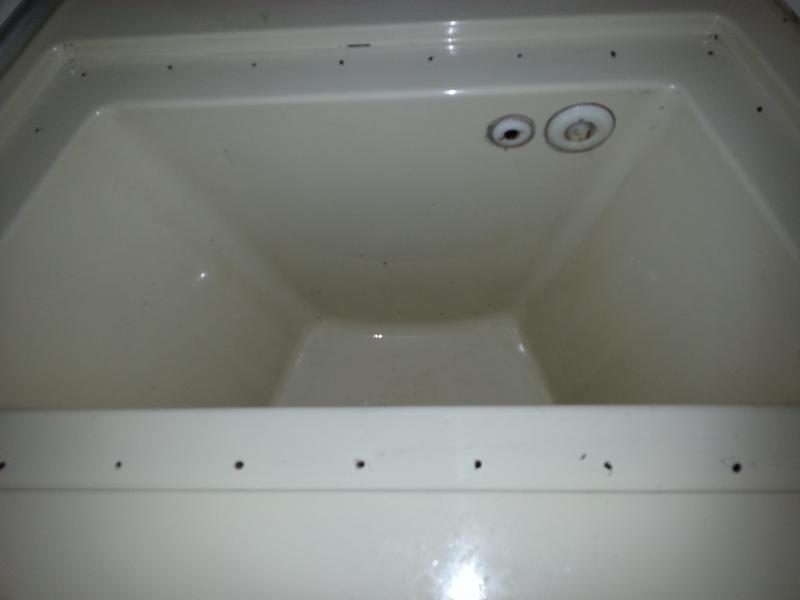

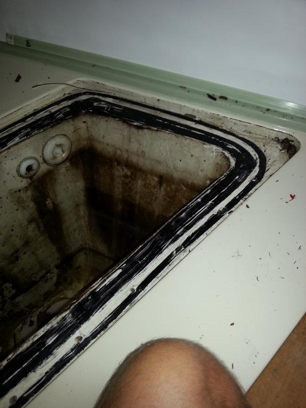

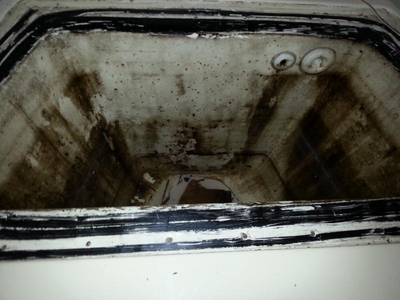

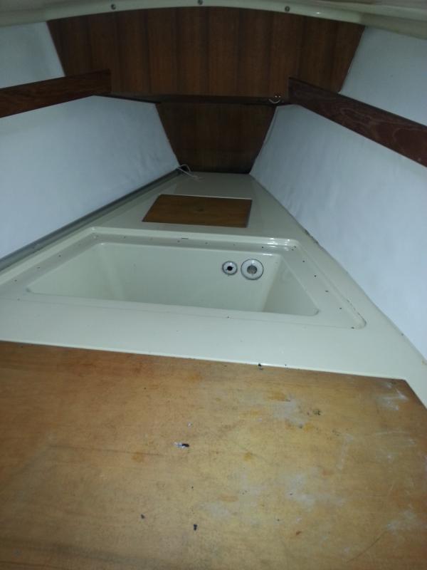

well..
i wouldn't even use the water to wash my hands.. here's what i found.
mineral spirits to clean the butyl; bleach the hell out of the tank.. and on order.. a clear plexiglass replacement for viewing and easy access..
quick and easy; relatively painless..
i don't understand the design; as it seems permanant and not intended for dismantling and cleaning.

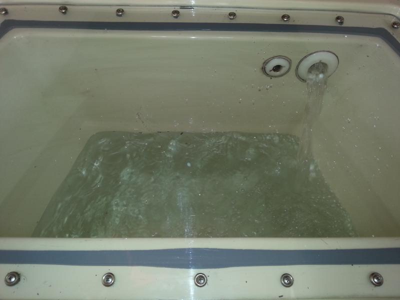

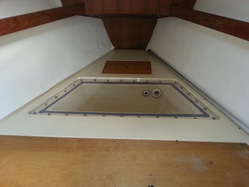

after a relatively quick and painless clean up job;
polycarbonate sheet, the same screws used for the previous wood and laminate;
some fantastic butyl tape bought at a local roofing shop (pliable, waterproof, sticky like stick tac not like silicone and long life)
budget job for a nice finished product..
re previous post;
no gauge but its clear plastic and can look through hatch while filling..
there is no overflow valve but i suspect your air vent may act somewhat as an overflow?
any questions feel free to ask..

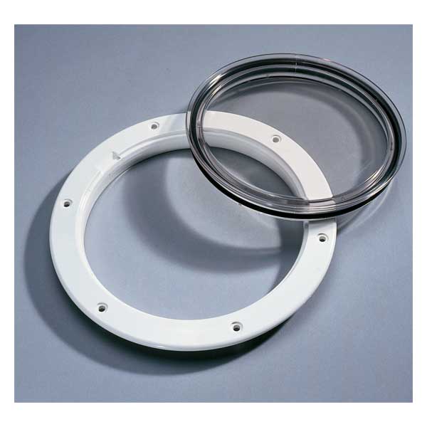

I installed a 6" round access deck plate( http://www.westmarine.com/webapp/wc...&subdeptNum=50688&classNum=50690#.UepzV42siSo ) in the top of water tank in our previous boat, and intend to do the same on our current vessel. The clear cover allows easy inspection of the tank and makes cleaning the tank out quite easy. I used "food grade" silicone rubber caulking to seal the outer ring to the plastic tank. We don't drink the water in the holding tank but it is used for washing, brushing teeth etc. some caulking materials can contain some nasty chemicals.
