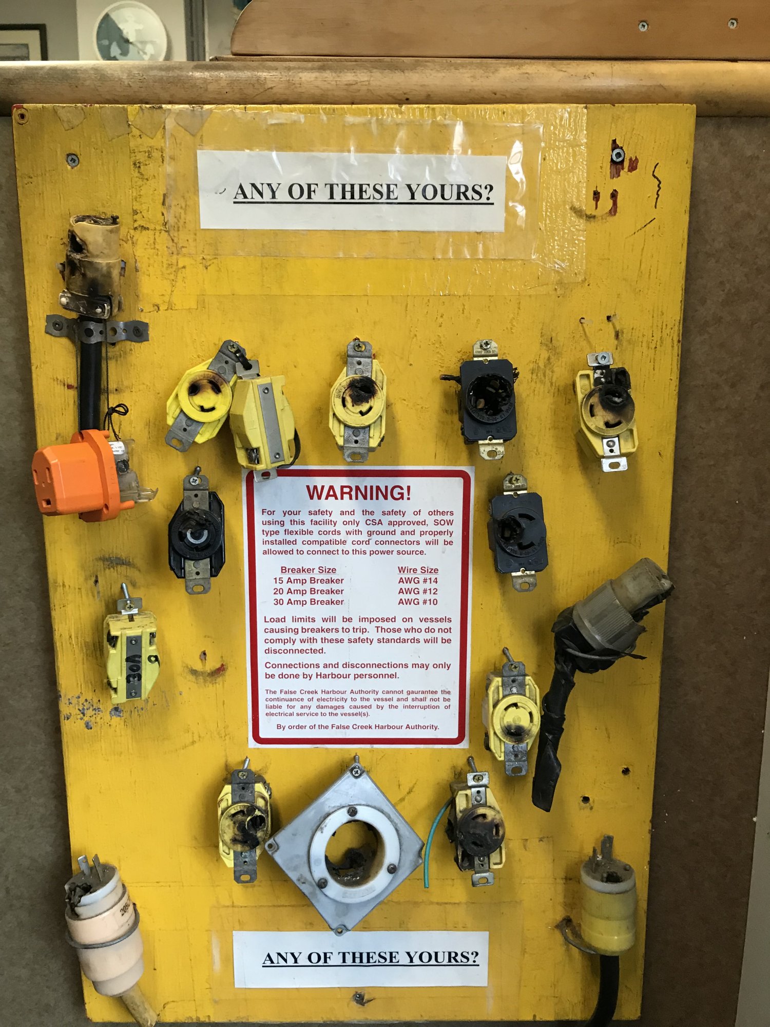

When @jssailem , @LeslieTroyer and I were sailing a few years back we met up in a marina in Vancouver. That marina had a "Wall Of Fail" which did include an adapter cord with Smart Plug on one end. The opposite end, no the SP end, burned up earning its place on the wall.
I remember comments here when John posted the pic, people thinking the Smart Plug had failed. Nope, it was still good.

I bought a Smart Plug at the 2018 Annapolis Fall Boat Show after talking to @jssailem about the advantages. (John and Less flew in for that show).
Much more secure connection and much easier for the Admiral to plug in. And I must admit I find it much easier also.
Anyway, here is the photo from the Wall of Shame at the Vancouver marina we stayed in. That marina did not allow boat owners to connect their own power cords. Only the marina staff was allowed to make the connection.
Note the Smart Plug shown was part of an adapter cord that failed, not the Smart Plug.
Finally remembered, False Creek Marina in Vancouver.
