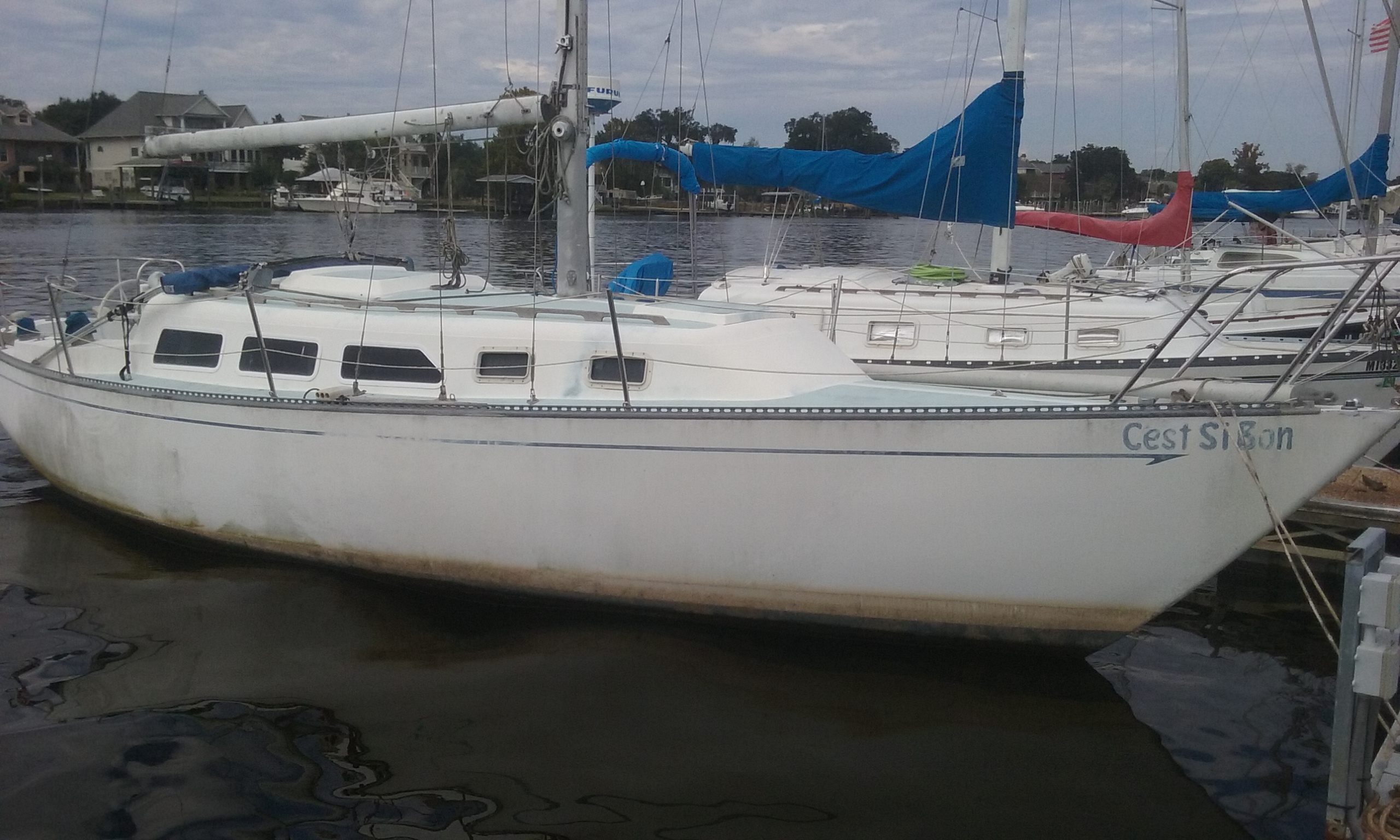

Well I bought it and have been working on it for a few weeks the engine was not running like the owner said but I got her running with minimal effort just had to pull the head and free some valves. ordered all the running rigging , added some new cushions, and am working on the electrical and wood work. could use a new main sail the foot of it seems to be rotted.

She looks great. I see lots of fun in your future.

It is all about vision. and glass half full attitude. Not everyone has the finances for a Bavaria 38E. A boat Bob Perry described as:"basically chubby-proportioned boat". I for one would love to go sailing on a Bavaria, but maybe it is not where I'd spend my cash.
On the other side the Ranger in a 33 foot length has a lot of positives from cost in a marina, to cost of materials and equipment to make it a positive sailing experience. Or just a boat to clean up and resell.

Thanks, but there are some very pretty boats of '70's vintage out there that have been well maintained, etc., and that really do look "great"--as I'm sure you know. In any event--FYI, Perry's review that you refer to is for the Bavaria 38 Ocean--a center cockpit model that is "chubby proportioned." He cites a 13'1" (13.08') beam on a 38'6" (38.5') LOA as evidence. The 38E is an aft cockpit model of 12.5' beam on a 39.3' LOA; so, a bit more trim. But yes, still beamy, as are most all of these post-1985 production models. I admire Ranger yachts, as do many others, for their sailing qualities.
