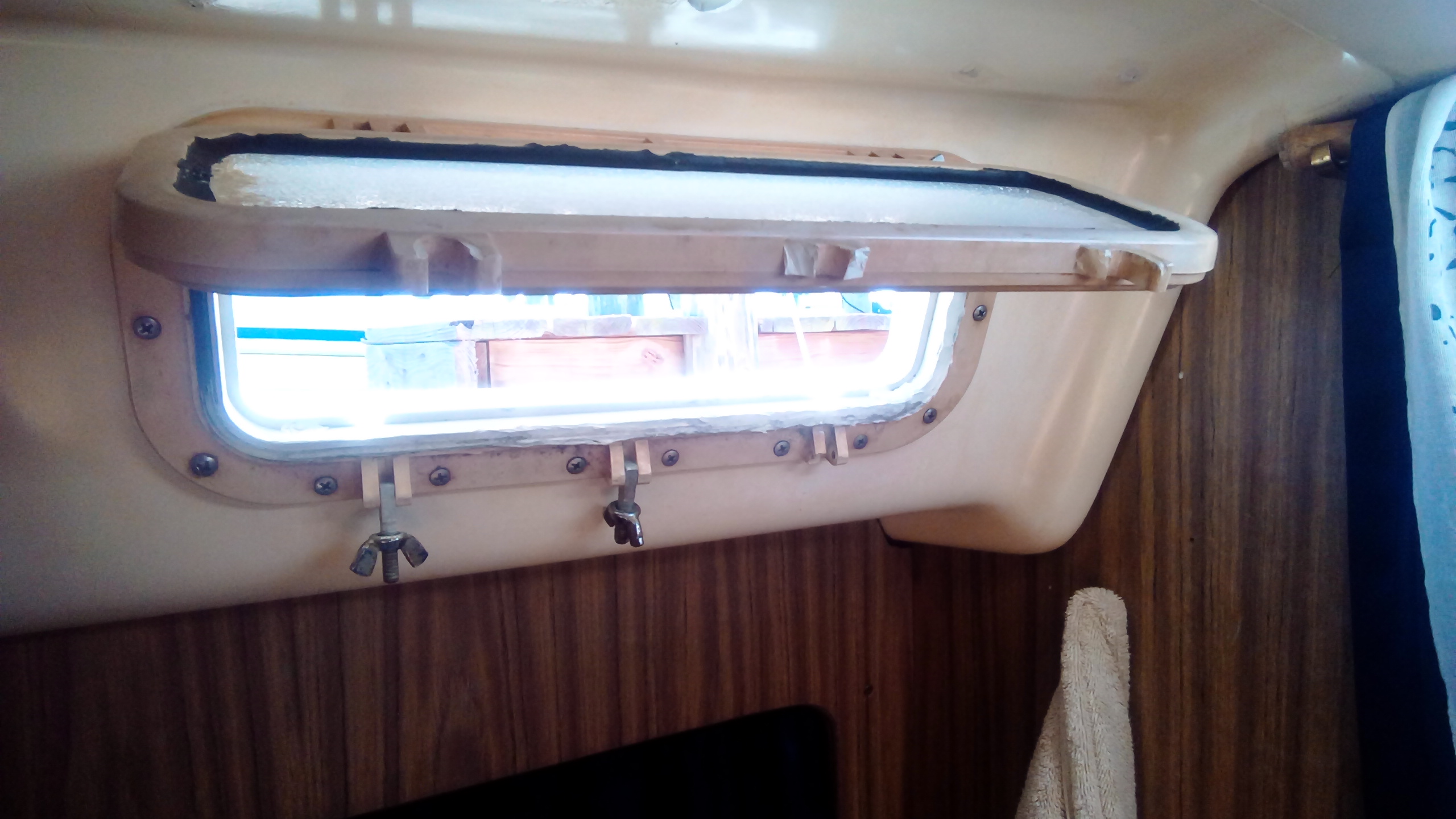

O Oliver . Mar 16, 2014 114 Oday 25 Bradenton Beach Florida Feb 28, 2017 #1 How do I measure these Windows for replacement order? same both sides, they open and must have that but need to replace, there bad. Picture included Attachments IMG_20170225_1031349_rewind.jpg 701.6 KB Views: 171
Stu Jackson . Feb 26, 2004 23,544 Catalina 34 224 Maple Bay, BC, Canada Feb 28, 2017 #2 Hi, First you need to measure them. They appear to be either Gray or Beckson ports. They sell Gray ports right here on this website, look in the store. Otherwise, www.beckson.com. Both should have measuring guides to tell you what to look for. A handy removal tool is this: Beckson Portlights 101 ("removal tool" with pictures and guides for sealants) http://c34.org/bbs/index.php/topic,3241.0.html Good luck. Likes: Oliver
