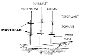

The masthead nomenclature comes from when mast sections overlapped, and is the location where the steaming light is now placed. Weird nomenclature in this day and age. I'm sure it was way more practical to refill kerosene lamps at the mast head than the top of the mast.
6 degrees blockage is allowed, which means it needs to be >5-8 feet from the mast unless it is at the top.
