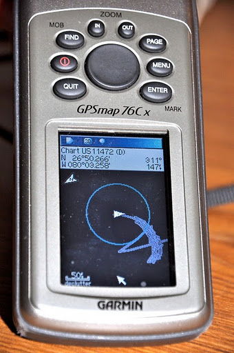

I use my handheld GPS over night when I have concerns with the anchor. Usually just let it run as I come into the anchorage then let it run for a couple of hours to see how the boat swings and if it holding well. If we are having a "bad night" I turn it back on and check it if I have any concerns without even lifting my head off the pillow. The picture below was a night on the north end of Lake Worth with unexpected 40kt south wind. We had a bimini and boom tent so a lot of windage on a small boat. As you can see anchor held, 12 ft of water, 50 ft chain and a 22 lb Delta anchor. It was our 2nd day there so anchor was well set. We were in a slip the next night ;). This GPS model has an anchor alarm but I prefer to just look at the screen to see what is going on, our boat does a lot of sailing on the hook and will set off any anchor alarm.
