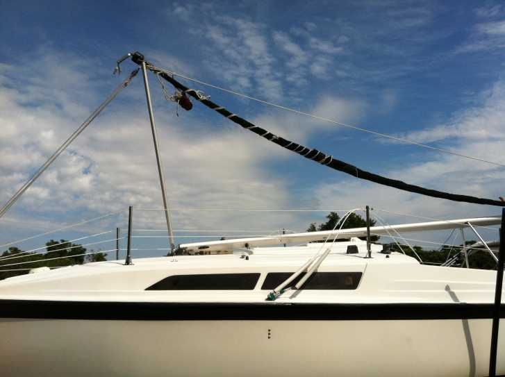

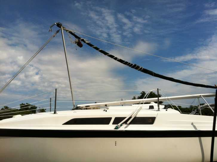

The furler makes it EASIER to rig. Some find the heavier forestay/drum an issue while mast raising - but - check out my solution in the attached pic.
A simple caribeaner attaches the drum to the gin pole. After the mast is vertical, the drum is almost at its attachment point - no wrestling required.
For trailering, we use a few elastic Velcro straps (from the dollar store) to attach the furler, shrouds and "stuff" to the mast. We lash the boat hook to the front of the mast so it projects forward a few feet and Velcro the furler drum to it. Takes about 5 minutes and you are ready to go.
Chris
Other mods of ours: http://www.holderness.info/boats-a-projects/macgregor-mods.html
Attaching the furler to the gin pole with a 'beaner is brilliant, such a simple solution. I can't wait to try it, thanks.
