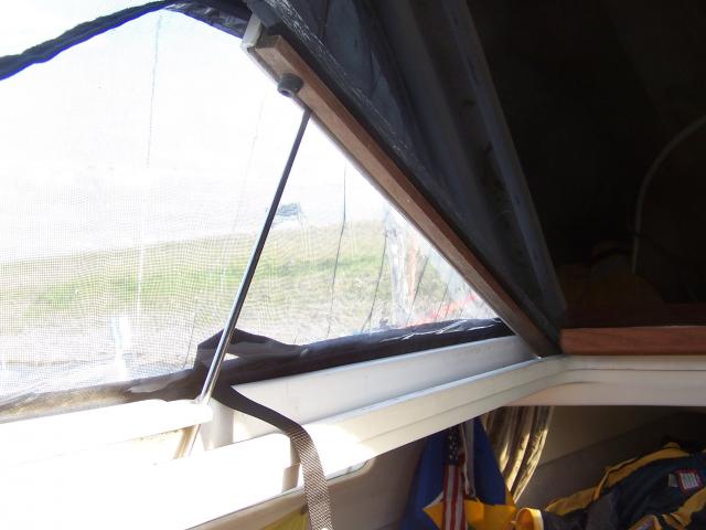

Just purchased a Hunter 25.5 1984 from a broker in Arizona. It's now home in Kansas City but I can't find out how the pop top is supposed to stay up once it's lifted. Are there poles or braces that hold it up? Does anyone have a picture of what I should look for.

There are two stainless steel legs that are in the outside groves of the fiberglass hatch. When you lift this hatch you should see them and be able to pull them forward to support the hatch.

Dave thanks so much for the information and super fast response. The picture was an added bonus and much appreciated.

Inside the cabin there are 4 hold down bolts. One in each corner of the cabin top. Unscrew these fully out. Grab the cabin top just ahead of the slide hatch with one hand and in the middle of the pop-top with the other. The pop-top weighs 80+ pounds, so push hard. The top lifts up and swings forward to the mast.
There is a hook with a thumb screw that slides along the channel in the back of the mast. Before raising the top, move the hook to the bottom of the channel. Once the top is raised you slide the hook up to catch the forward lip of the pop-top. Snug down the thumb screw to secure the top in the up position. Hold the pop-top up until that hook is secured. The top will come down real fast!
