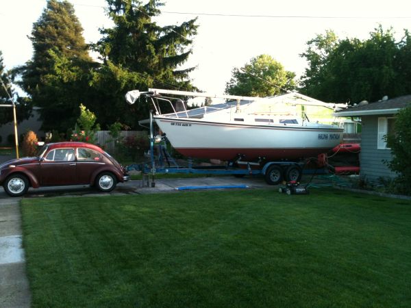

Oh, by the way... if you have a big honkin' tow vehicle, or plan to keep it in the water, the Catalina 25 is a no apologies overnighter for two! I've included a picture of a well-matched Cat 25 tow vehicle for reference:

"I've included a picture of a well-matched Cat 25 tow vehicle for reference: "
Nice tow vehicle! Those VW Bugs are a lil more powerful then I remebered. lol.
Ps. We used to have a C 25 w/ a trailer & I never towed the darned thing, even with our big V 6 van cause I didn't want to blow up our tranny. Plus that boat is wide & loves to fish tail. We kept ours in the water all season till we upgraded to a bigger boat. Cheers.
