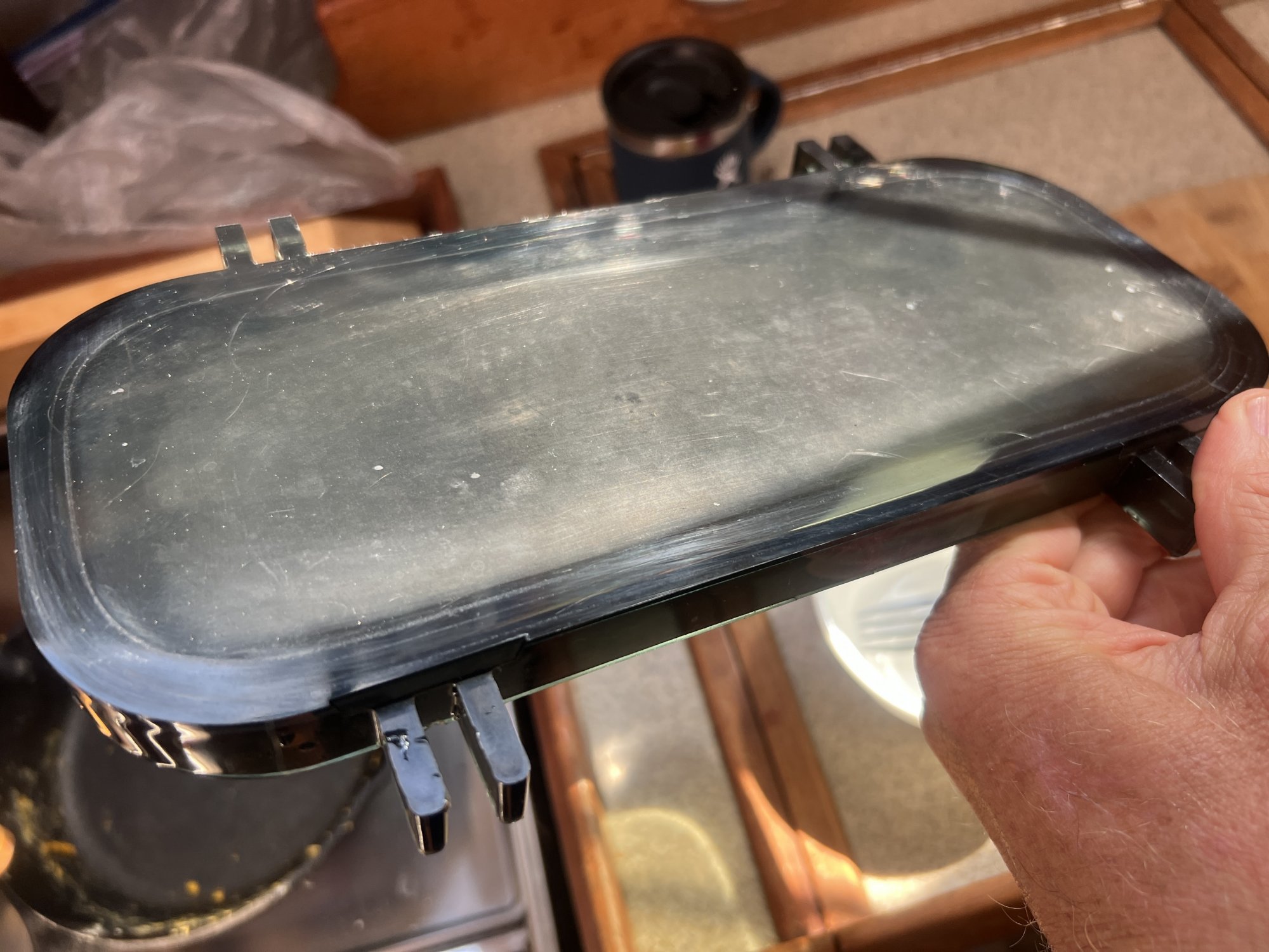

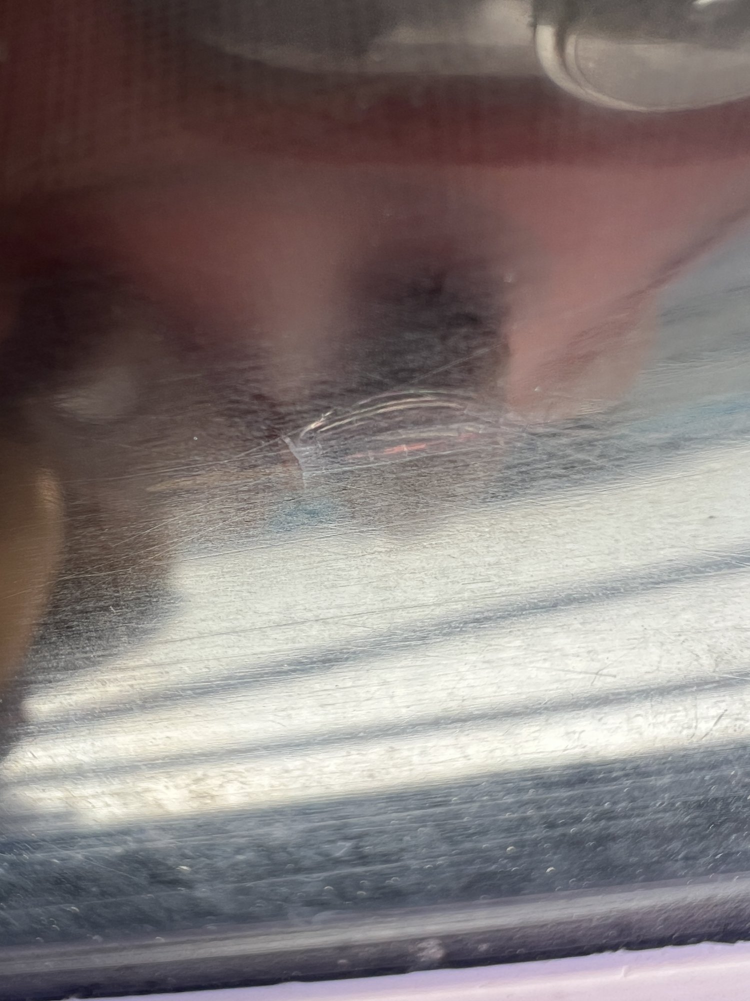

I nicely polished and coated these lenses with 3M UV wipes last spring, and they are already hazy (see pic). Is there a better way to UV protect these once polished? Or is it better to just shell out the ~$130 to replace them?
14,252
Polishing, as you have learned, is a temporary solution. If you don’t mind polishing then there is no need to replace them.
Another expensive solution is to replenish the ports with SS ports and glass lenses.
The polishing doesn't penetrate the acrylic. The surface microscopic cracks probabaly fill with wax during the polishing process and look good for a short time. They look good from afar but far from good.

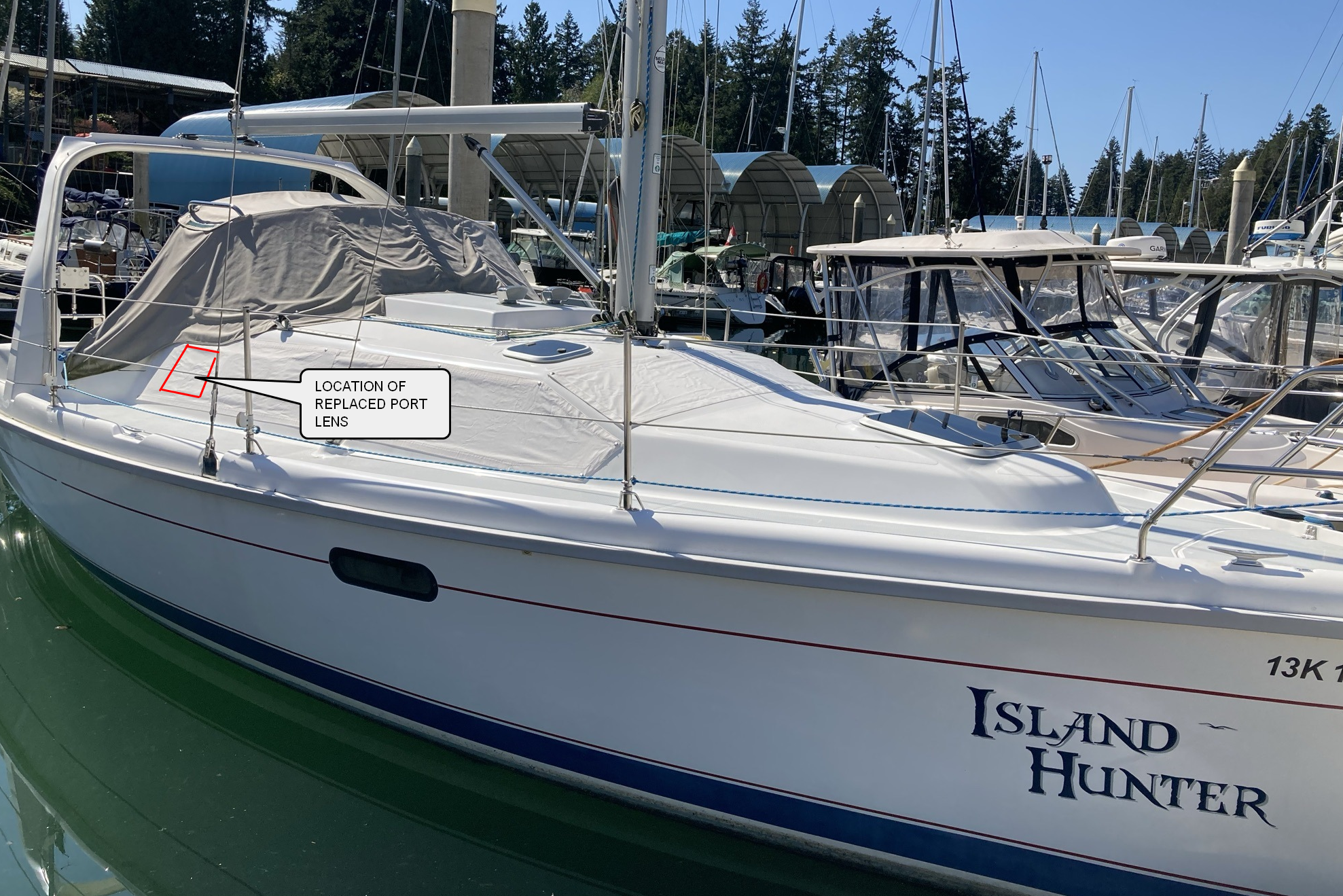

Once you have replaced the lenses, he only way to "slow" the hazing process is to cover the lenses when they are not in use. I did this with three Lewmar lenses which I replaced a few years back.
This was early in the covering craze and eventually I covered all acrylic port and hatch lenses.

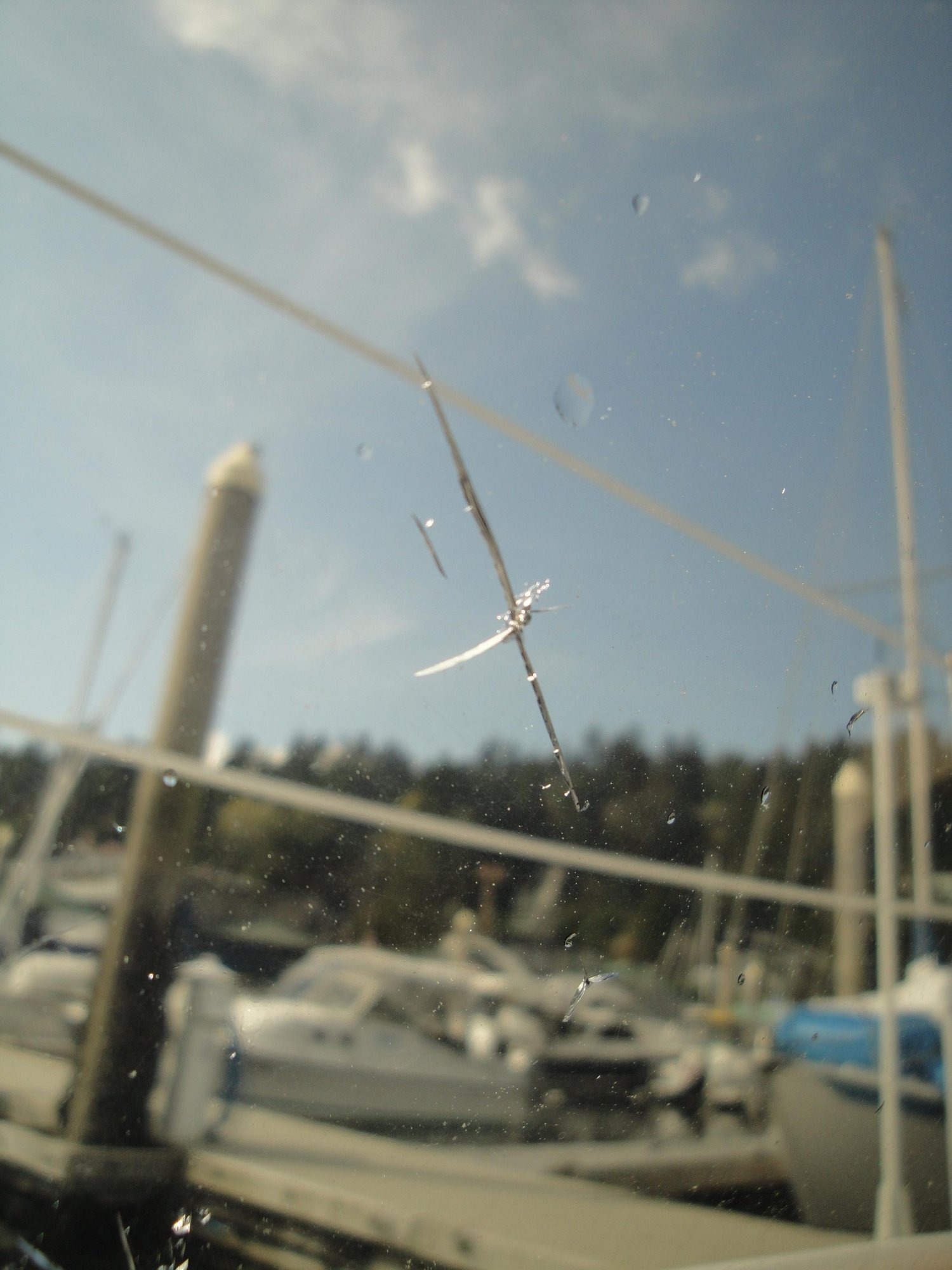

Below is an example of hazing taken to the extreme (UV damage) in a fixed portlight which looks more like the victim of a driveby shooting. At least it hasn't progressed any since covering it with the Sunbrella covers.
It's my understanding that after polishing well, you need to spray paint them with clear UV spray paint.
Something like Krylon Clear UV Resistant Acrylic spray paint. And you need to do several coats after polishing.
If only I had known this when I bought the boat knew in '98, I would have covered all of the the windows and wouldn't have had any UV damage problems to date.
Live and learn :banghead:.

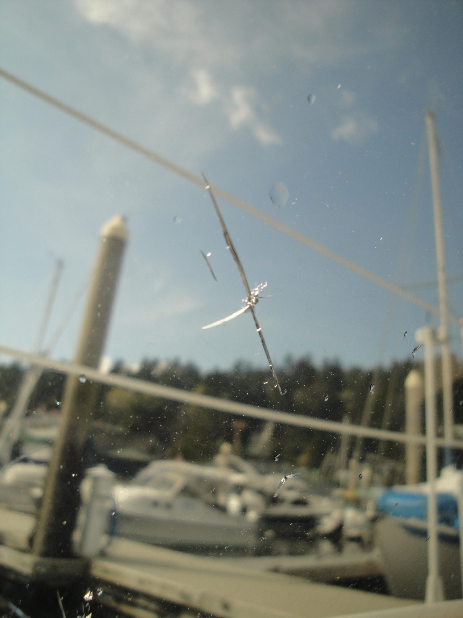

One of my portlights has lot of little damage marks like this. Is there potential for leaks?
dLj
Mar 23, 2017
5,231
Not usually, but it depends upon how deep those cracks are penetrating. Nobody from a distance can really answer this question.
dj
8,162
There is an automobile product for hazy headlights. I think it's basically light compound and a polymer coating. I used it on my headlights. The results were pretty good but I traded that car in so I don't know about the longevity. I don't think it would work on the "Drive by shooting" scratches since it's really a surface treatment.
Jan 4, 2006
7,851
Close up, you can see the crack is the the full thickness of the acrylic.
For the sake of "just gotta know" I nailed the defect, close up, with a hose on "stream" and nary a drop of water on the inside SO FAR.
Thanks for the reminder because with my luck, it's going to leak at some time in the future so time to check it again. The reason I say that is because I have a condition known as "The Reverse Midas Touch." Everything I touch turns to :poop: .

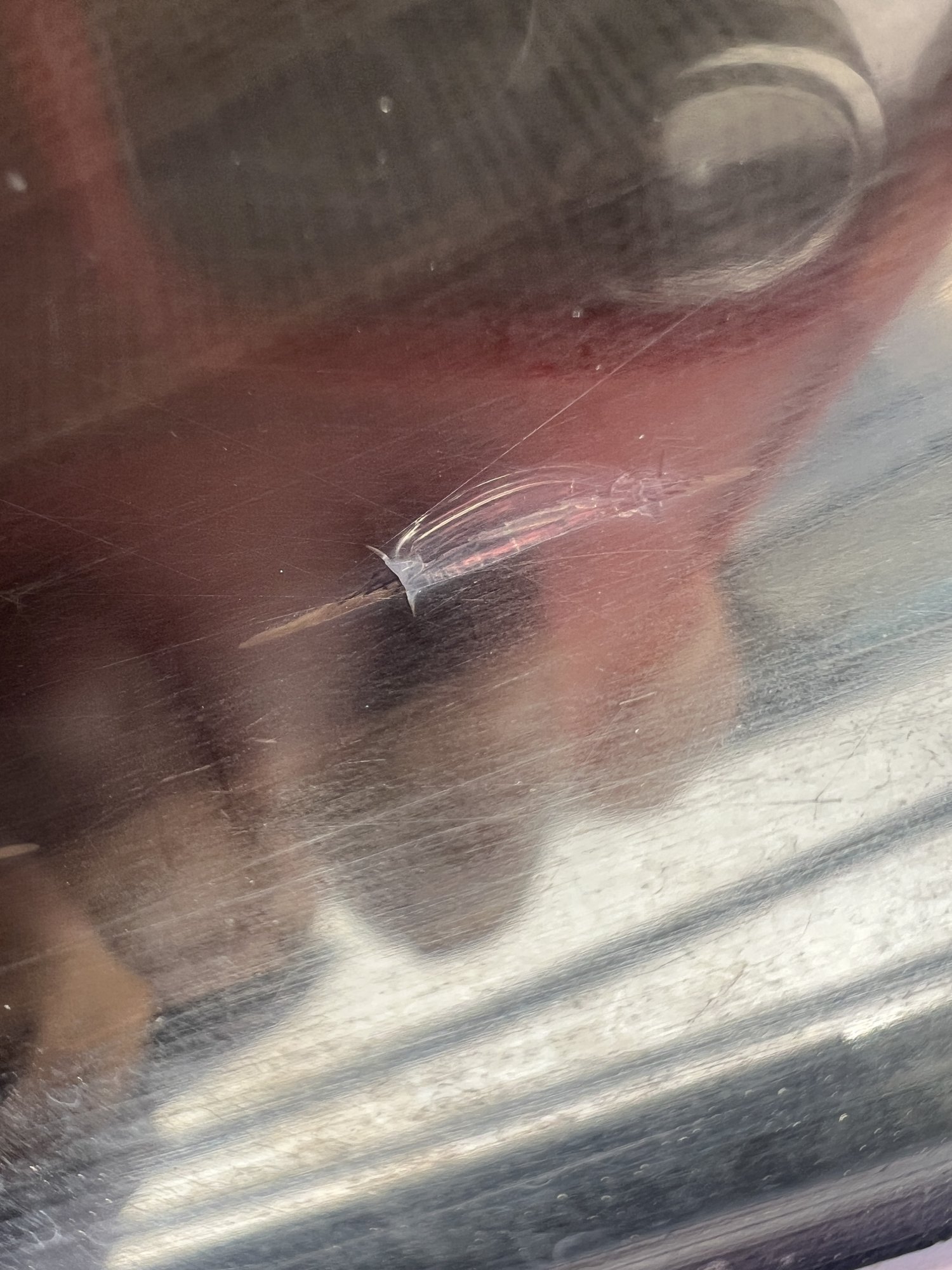

I noticed a similar crack appear in one of my bedded port lights. Is this the beginning of crazing?
Jan 4, 2006
7,851
That looks like someone dropped something on the plastic.
I know that's the popular opinion here but not only do I have a couple of large cracks as shown in post #3, I also have many very small cracks which appear to completely penetrate the thickness of the acrylic.
If you can't accept this as the start of UV crazing, then I've had tiny little gangsters with tiny little guns making drive by shootings of my boat every night.
Just great, something else to worry about on my boat :pimp:
Did I mention that looking at he portlight from the exterior, the surface directly over the suspicious crack ? ? ? is without a blemish. I would suspect that an impact would leave some kind of mark.
@skunther , can you please check the exterior of your portlight to see if there is any exterior mark on the acrylic and let us know. Thanks.

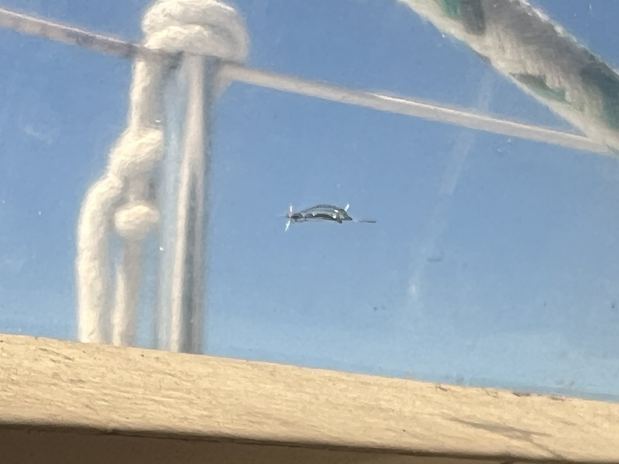

These are the best two pictures I was able to get. They show the surface pretty well. I don’t see any obvious impact markings on the surface.
