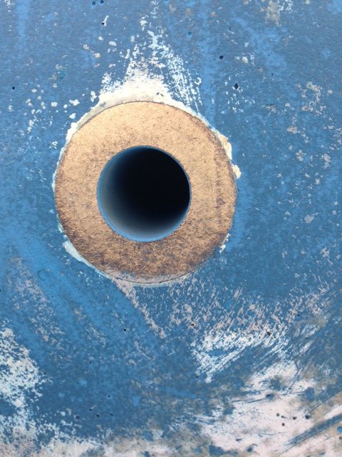

I'm looking for suggestions on plugging through holes.
is there threads on the other end if so get a bronze pipe cap and some pipe dope and just cap it off ...since it is out of the water you could also remove the fitting and glass it closed with some cloth and resin

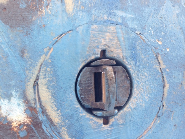

Thru holes
One looks like a paddle wheel speed sensor there should be a way to pull the guts of speed sensor up into the boat and usually the manufacture has a plug to put back in hole . My ray marine paddle wheel has died so often I got used to using gps speed but that doesn't give you true water speed. But I found 2 factory plugs on boat and working on modifying one to house a led under water light in it.

As others have said, your ONLY choice is to remove the thru-hull and fiberglass over it. Look on youtube, there are several videos that apply, nothing real hard about doing it.
Any hole in the hull is a potential leak... think about your boat sinking in the harbor because a thru-hull that has no use has failed while you were gone... A couple hours fiber-glassing, fairing and painting compared to reflating your boat and drying it out... let's not even mention engine damage.
Pull it out, fill it in, paint it up - no other choices need be considered...
