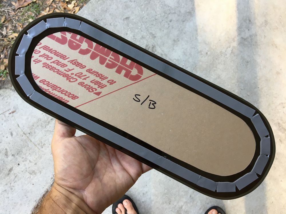

dont peel the protective paper from the sheeting until you are ready to stick the finished window to the window hole....
after cutting out the new window lens and with the paper still in place, hold the newly cut lens piece it up to the hole, in its proper place, and trace around the hole with a pen or pencil onto the paper.....
then lay the lens down and use a razor blade to gently cut the traced line... then peel the paper off around the edge that will be painted, leaving the paper in the center... if there is any over spray on the remaining paper, it will be peeled off later anyway...
using a scotchbrite pad to scuff the area that is going to be painted is a good way to insure better adhesion...practice is to use a paint made for painting plastics.
all the sanding and beveling of the edges can be done before removing the paper, but the flame polishing must be done AFTER removing the paper... if not it can catch fire and scorch the plastic. at the very least it will be very difficult to get the melted paper adhesive off of the acrylic...
so, cut to lens size.... bevel and sand edges.... trace hole in cabin on to lens paper..... cut trace line, peel edge paper.... scuff and paint, let dry very well... flame polish..... add adhesive tape and install.

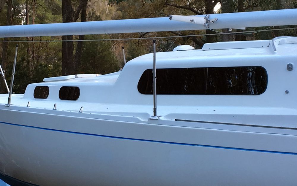

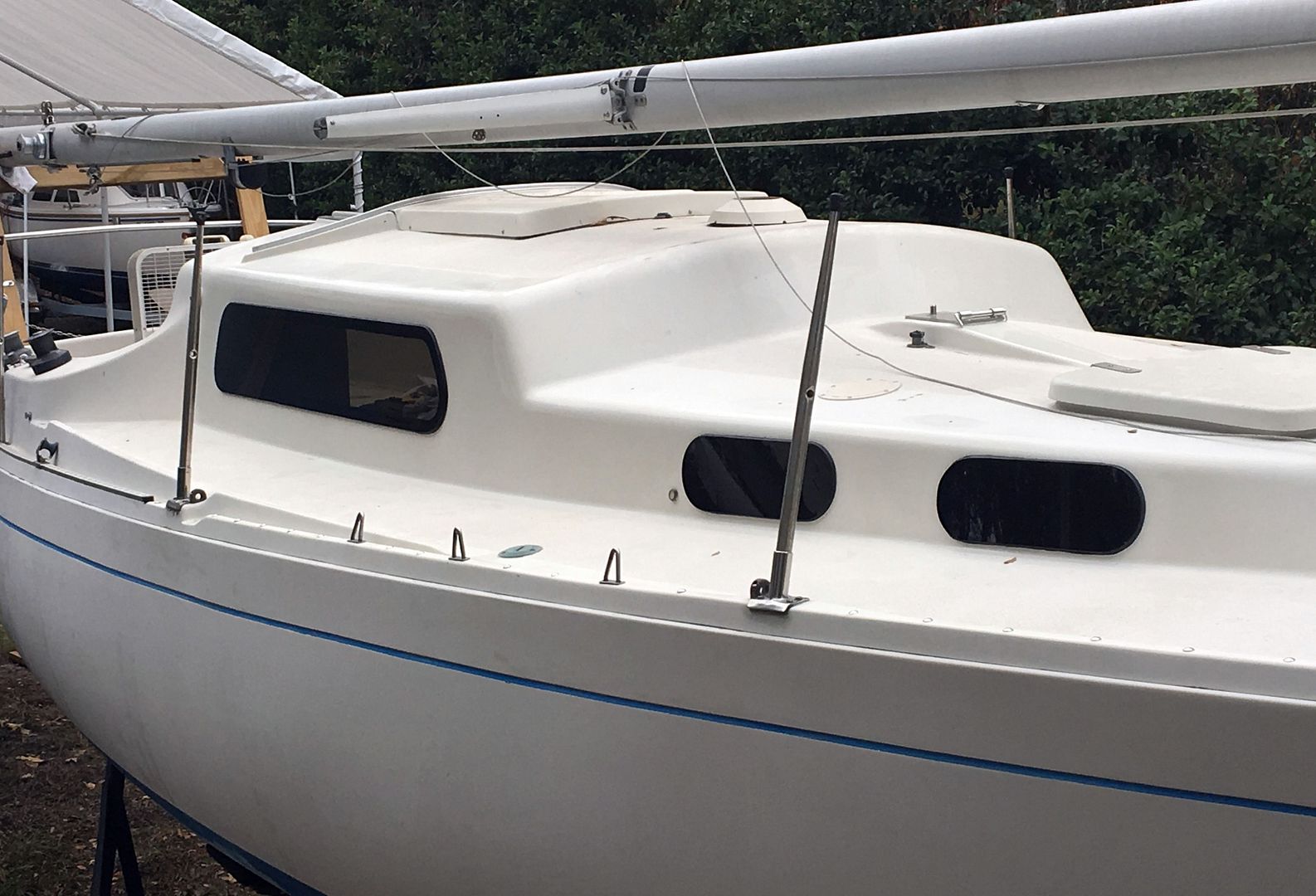

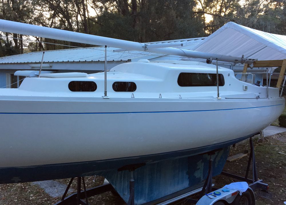

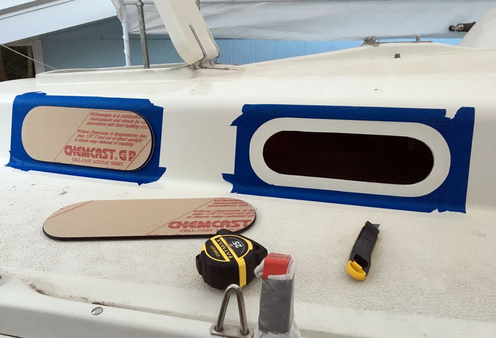

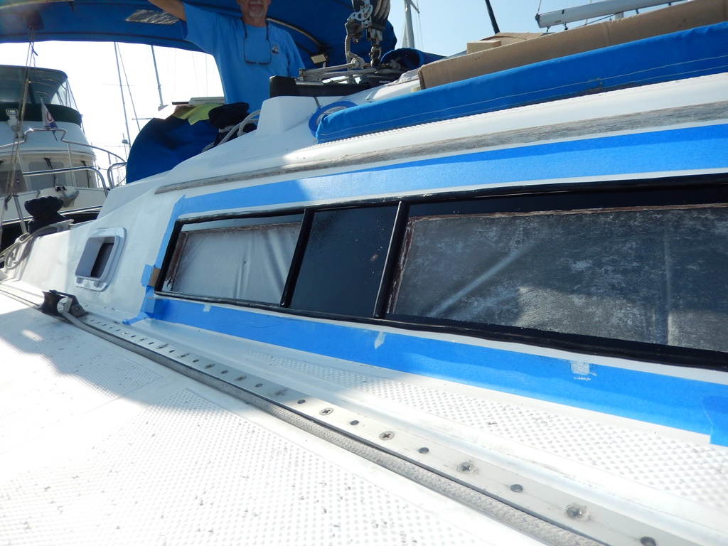

I'd like to thank everyone who has been helping ... the windows are coming along! All four of the small, forward windows are are done, as is one of the large main saloon windows. I was ready to start the last one when the weather turned cold, and I'm waiting for a warmer spell to to finish. I hope to have the project done Sunday (86 degrees forecasted).
The hardest part about this, by far, is masking the doghouse around the window. It needs to be PERFECT, as this Dow 795 is extremely unforgiving. The job is not as clean as I'd like, but the imperfections are not noticeable until you're approaching arm's length away.

Looks outstanding Gene, and I'm sure the extra thickness is worth every penny. How does the tape look up close?
