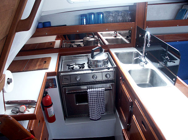

If your going to bend it, keep in mind that acrylic requires heat to bend, polycarbonate (hockey dashers) can be brake formed in a metal shop in six seconds. Also, 3/4" is massive! My company works with 1/2 million or so sf of plastic glazing a year and I've never seen it that thick. I'll bet that if you found one that your really liked the look of, it would be 1/4" thick.
880
Fed up w/ personal attacks I'm done with SBO
Hey Old School, looks really nice. Where did you get it bent?
Bent it myself, was pretty easy. I laid 2x4's on the plex with a slot between them exposing only the bend strip then slowly heated the area with a heat gun. It's important to bring up the temp slowly and only enough to get it to flex because any more and you risk bubble formation in the plastic. Once flexible I supported the piece at the proper angle and let it cool. Simple as that.
It's difficult to see in the picture but I made a 4" long U-bracket to support the outboard end from 1/4" aluminum channel available at Lowe's. After a quick pass on the polishing wheel I screwed it to the galley cabinet face.

Here's mine. 1/4" tinted plex, bent to accommodate the back searail cant.
Neil, you are so talented! This is almost exactly what I want to do, maybe just a little shorter. I see that 3/4" is a little thick, I don't know distance or thicknesses, I always get those wrong! 1/4 inch looks right now that I see that. I have looked at everything mentioned here and had a hard time finding anything, so this a a great start. The brackets listed in a later post look right too. Thanks for all the help....
