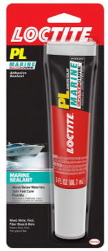

Has anyone had experience using a sealant or adhesive to repair a crack in a "poly" gas tank? I have tried 5200 and J/B weld. Sanded surface and cleaned with acetone prior to application, but neither would stick to plastic surface
i dont have a boat but i do have experience with a leaking plastic gas tank.On my 20 year old SUV the fuel tank straps rusted through. the tank dropped down enough that the driveshaft wore through the metal protective skin and then through the plastic tank far enough that you can see a white layer through the black layers of plastic. there was no hole but gas actively seeped through this wearspot. ive tryed everything that i know of to patch/seal the leak from seal-all to jb weld plastic tank repair to blue steel plastic bonder and they all would fail within a few days. i work at a big box hardware store so i see a lot of sealants and adhesives. This leak persisted for the past 6 months so i would have to limit how much gas i could put in the tank or end up with a gas puddle underneath my SUV. I was willing to try anything and read as much as i could on the subject and then i saw a product that has nothing to do with plastic tanks or gasoline leaks. i bought this stuff and decided to try an experiment so i pierced a hole into the bottom of an empty ibuprofen bottle with a knife and applied this sealant over the hole and let it dry overnight. The next morning i filled the bottle with gasoline and set it on a folded up papertowel so i could easily see if it leaked. i left it on my desk for three weeks and it is currently still there and not leaking. 8 days ago on march 2nd i cleaned the leaking area on the tank and made sure there was very little fuel in the tank and applied the sealant to the wearspot while on my lunch hour. i waited until the next day, approx 24 hours and put in enough gas that i knew was over the spot that had been leaking and have continued to do that for the past 8 days and still no leak or seepage. The sealant that finally did the trick ?? loctite pl marine sealant that i bought at lowes.
