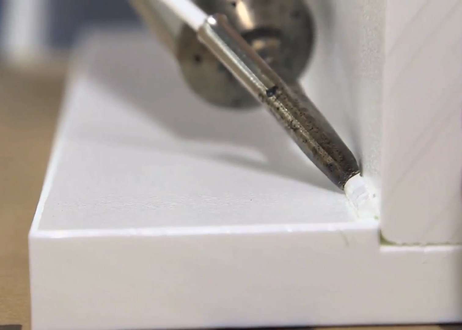

Or use a flame treatment:
Obvious risk using a flame on a used gas tank! I do not recommend it!
