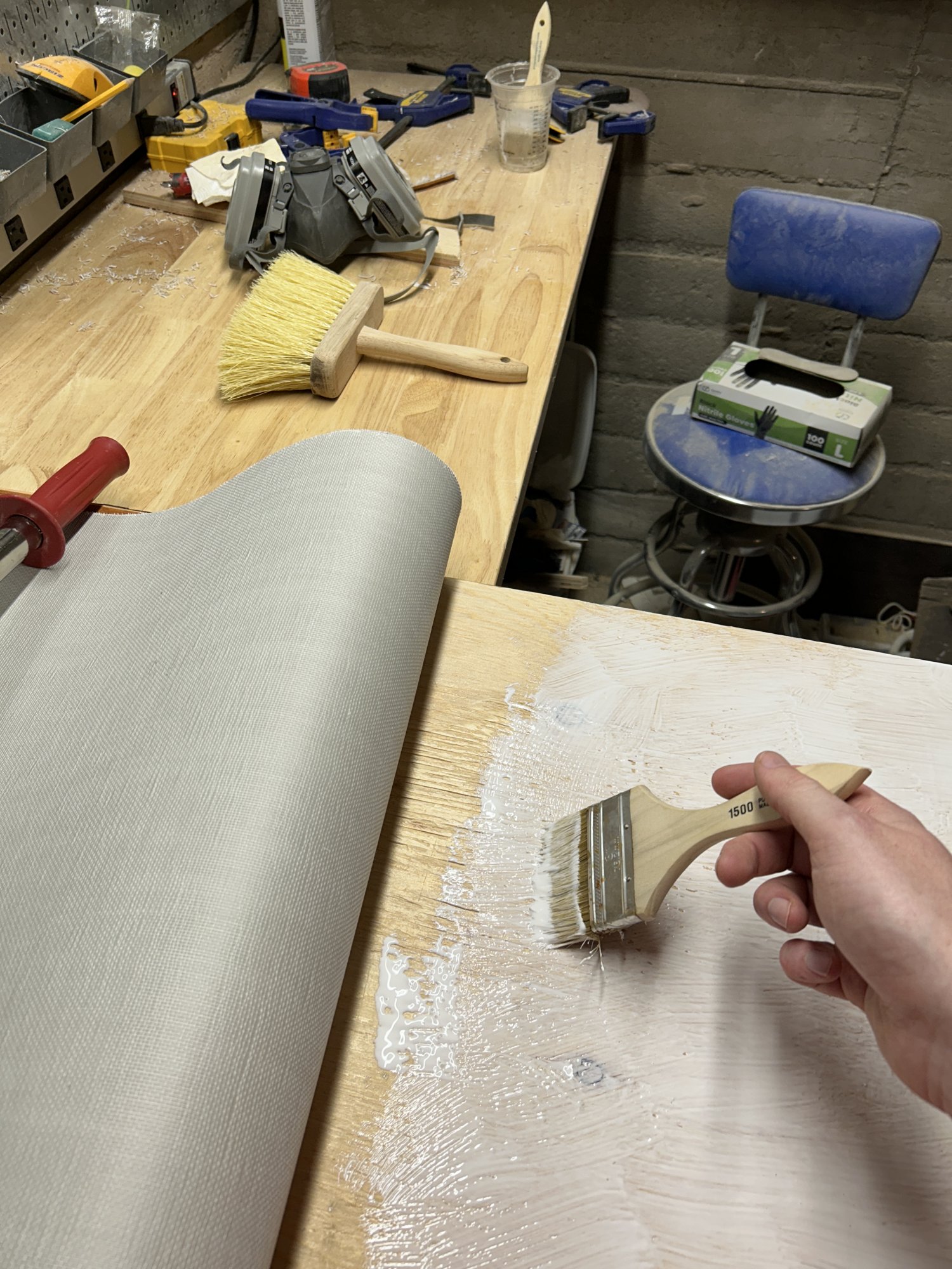

I’m concerned that the boards would absorb moisture causing them to expand and be hard to remove plus they would slowly rot over time. I was hoping to seal everything up with epoxy first so theres 0% water penetration then add the finish. Can you epoxy over a veneer?

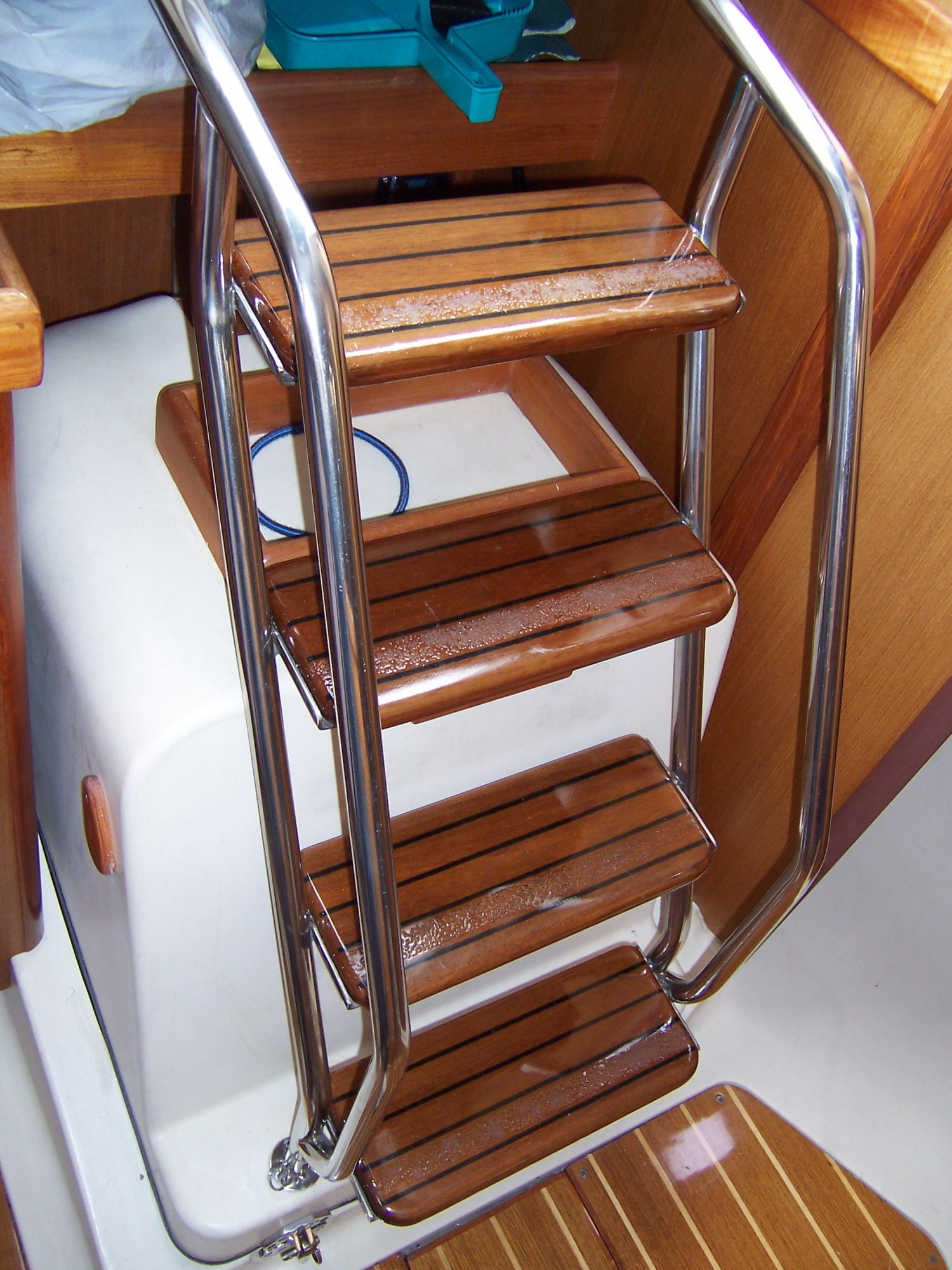

Thanks for this detailed response. Your floor and steps look great! My Beneteau floorboards seem to be made from cheap material similar to IKEA particle board with a plastic veneer. Also the boat was designed for the European market and the thickness is not standard - somewhere between 5/8 and 3/4 inch so I think I would have to replace the whole thing to get everything matching.

As mentioned, the first coat of epoxy should be well thinned for penetration, followed by a second coat of epoxy at full strength. 100% coverage both times is mandatory.

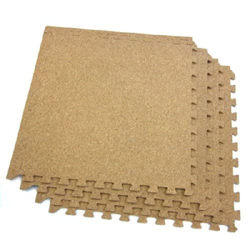

That is why I suggest cork tiles. https://www.icorkfloor.com/
Good grip at sea, ding wear and scratch resistant, easy to apply, easy to replace individual sections. reasonably priced, sound and heat insulation quality and in my opinion good on the eye. Also, available in a wide range of designs and colours. There are tiles that you don't need to glue down, but they seem a bit iffy. Worth a consideration though as test pieces.
Of course cork is not perfect, but what is?

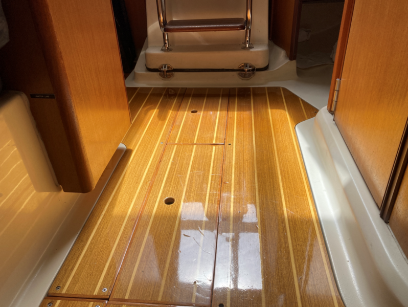

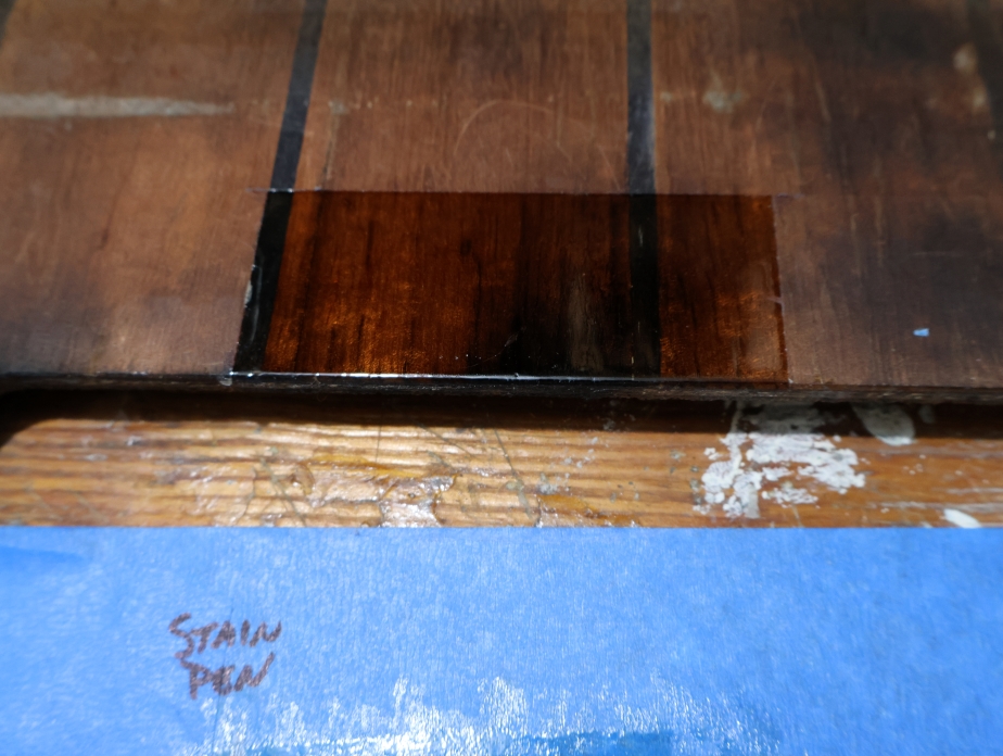

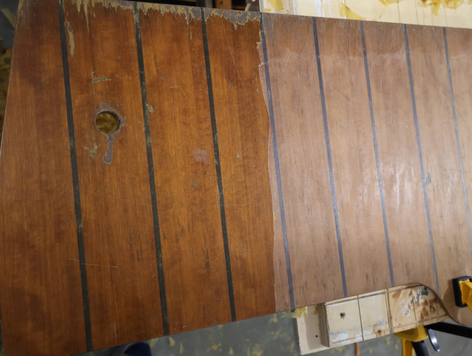

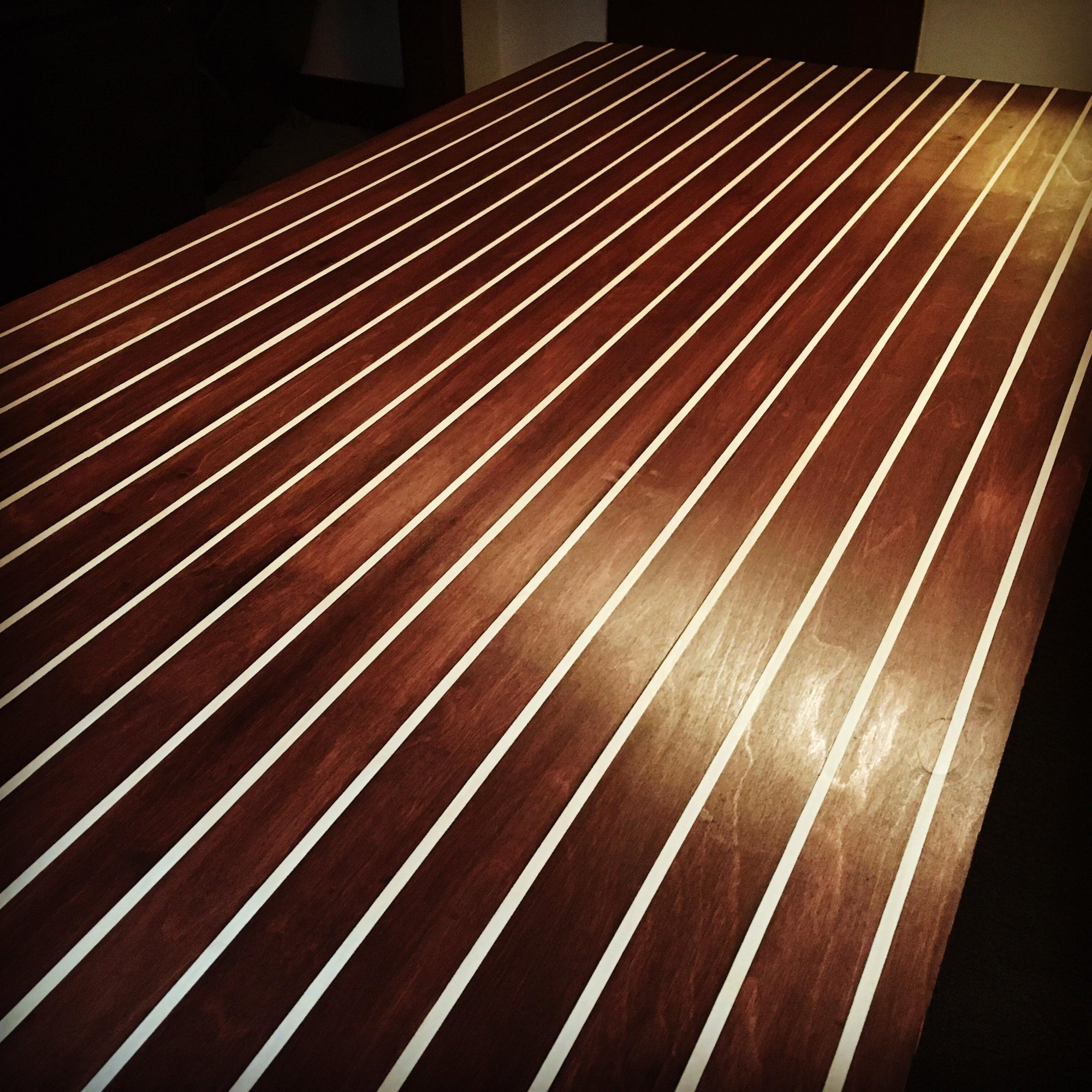

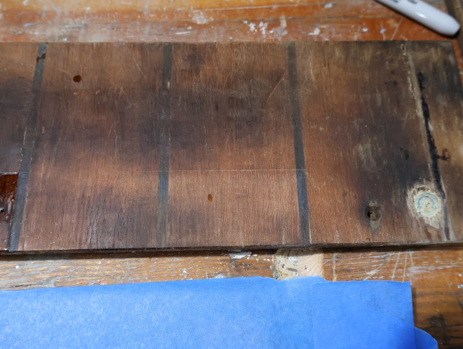

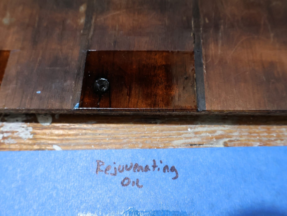

We own a 1998 Oceanis 321 and this has been my winter project. I would say I did a decent amount of research comparing refinishing the original sole plates, building new with a faux teak and holly appearance, and building new with a teak and holly veneer. The cost of the veneer was detrimental and the return on time from making new was also offputting.
Attached are a few pictures of current progress. A great video by Boat Works Today led me to choose TotalBoat Gleam. You'll find one picture of 4 coats gleam + a rejuvenating oil and another of just 4 coats gleam. Also the use of a stain pen to touch up faded holly alongside the use of a water based stain. Ultimately I've chosen to just use gleam, likely 10 coats, gloss finish. The water based stain bleads, the stain pen works well but is tedious. I did not try a gel based stain because I could not get it locally in a tiny sample size.
My word of advice if you've never done this before (I hadn't), start with a sole piece that isn't the center of attention. I chose the small piece under the companionway steps which is half exposed to the engine room and half exposed to the cockpit, also under heavy UV damage through the companionway. You'll see when I started I was not good with the heat gun and did some burn damage, thankfully you'll never see it. Now that I've done over half of the interior stripping, I can strip one sole plate in less than 30 minutes with just a heat gun and putty knife. I'm simply sanding the sides and not doing anything with the undersides, as 99% of the time I'm the only one sticking my head under the sole anyways.
For a previous comment, our sole plates are 14mm thick with a 1mm veneer. Would have been tough to match this in the US without owning a planer.

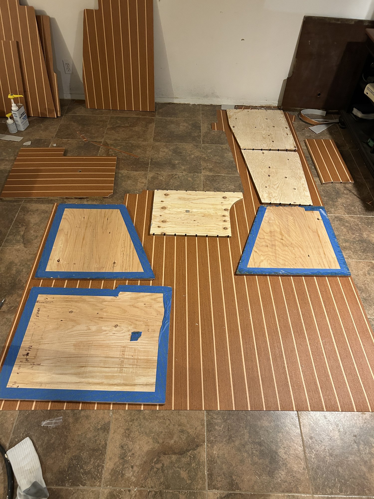

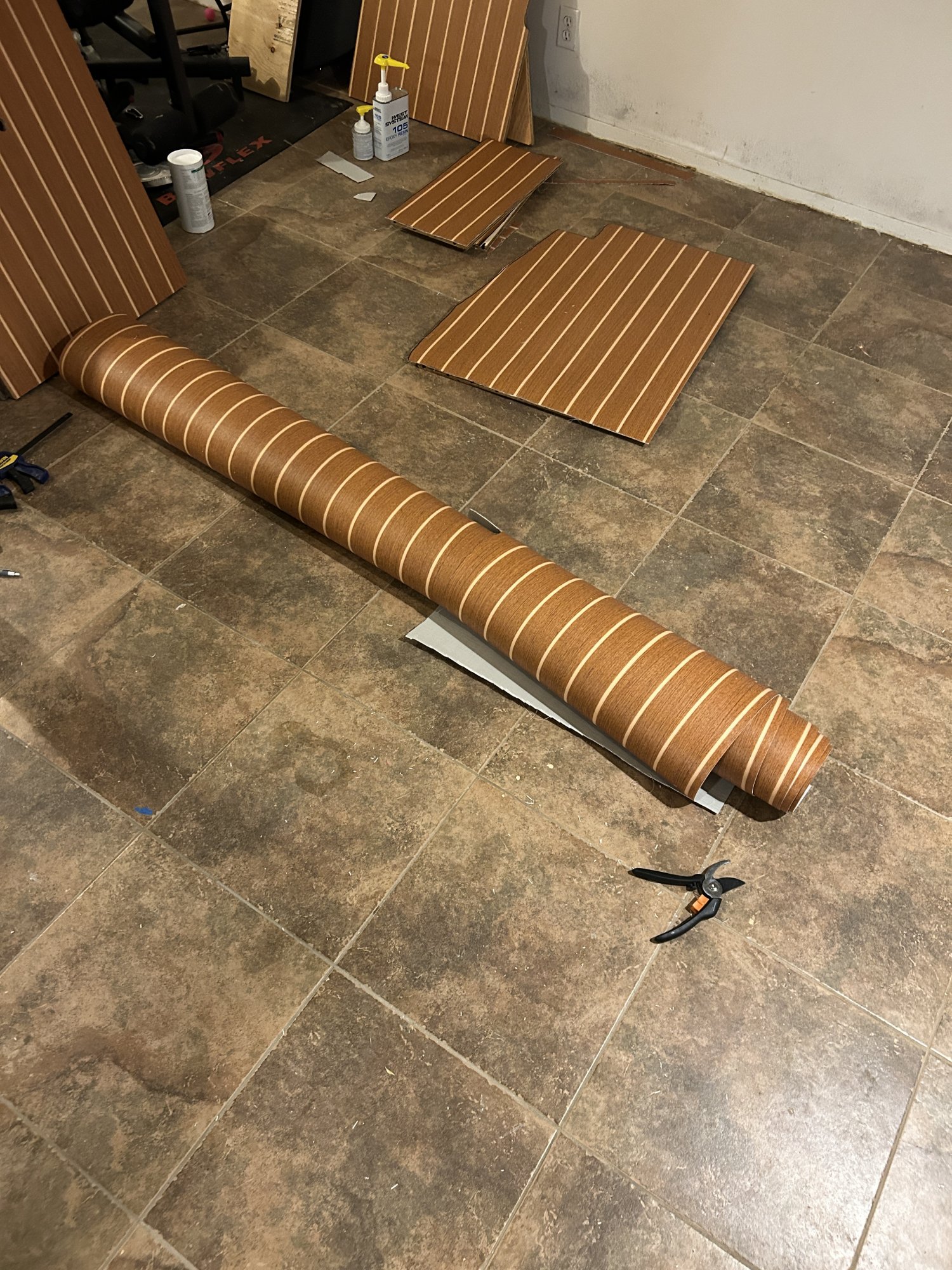

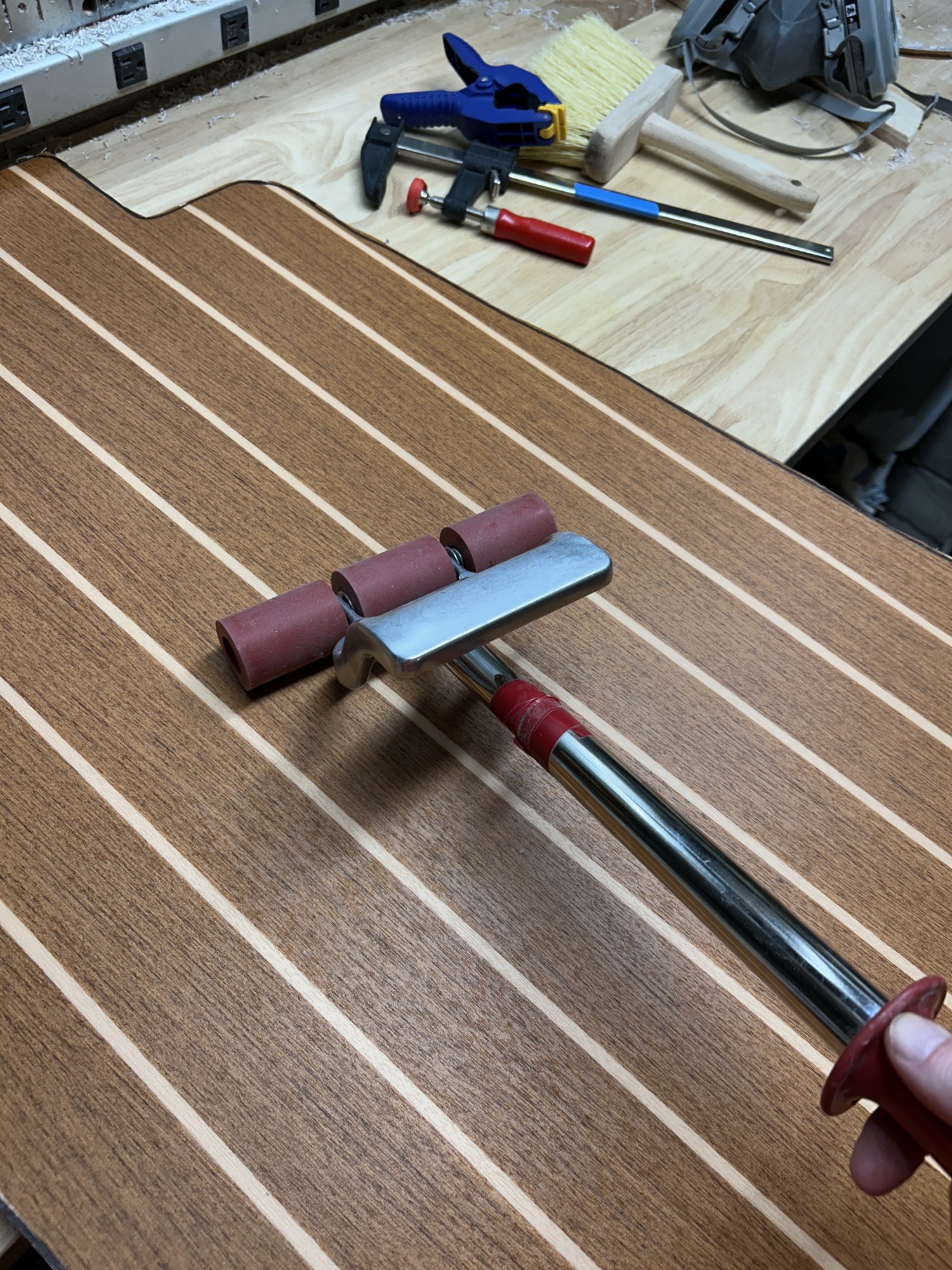

UPDATE:

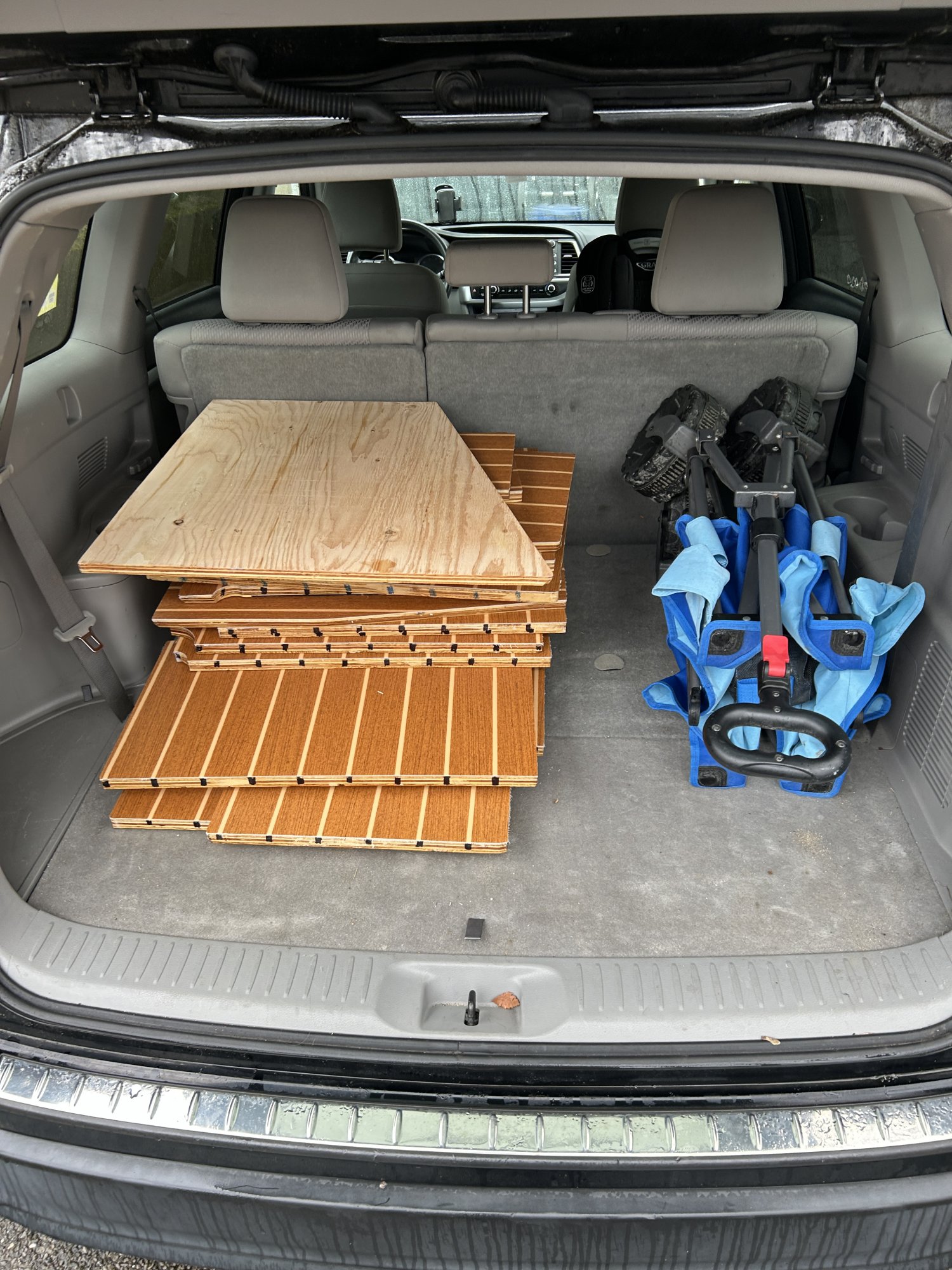

Project successful. Went with the Plasteak Teak and Holly (matte finish) and it looks great! Cheap plywood instead of marine plywood worked out fine (just fill the voids with Minwax and lightly sand).

I bought 15 feet of PlasTeak (6 ft wide roll) at $50 per foot plus 3 quarts of glue, a roller and 3 sheets of plywood ~$1,000 and around 50 hours all in. Lonseal is $45 per foot and they are the same product (see the TDS technical data sheet) but Lonseal recommends a special epoxy adhesive that can only be mixed in large quantities and is not suitable for a sailboat floor. Plasteak has excellent customer service and resources available (see attached). A router with a flush trim bit will duplicate the boards perfectly. Hardest part is lining up the stripes. I followed the method in the attached file with mixed success but didn’t perfect it until I got halfway through. Key is to use a large sheetrock T square to line up the boards perfectly and then clamp down the cut out material to the top of the board very tightly. Lift the flap and apply glue to bottom half using a chip brush then flip, move the clamps to the bottom of the board and apply glue to the top half and then apply the roller.

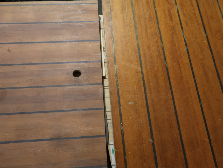

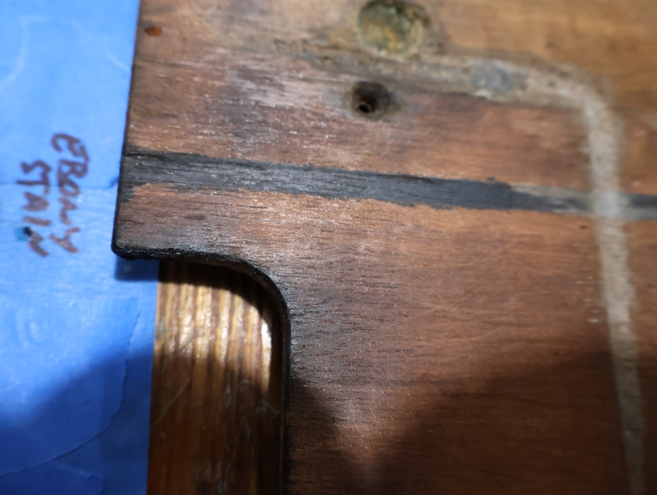

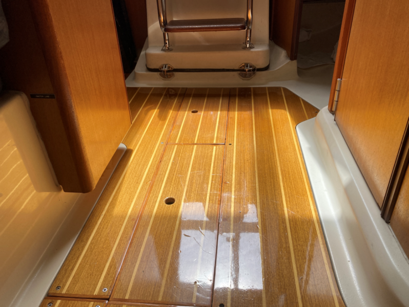

I only needed to replace two pieces and could get them done with one 4X8 Teak & Holly Sole (about $400). It was a challenge carefully sanding down the finish on the other pieces and matching the stain but it came out really nice. I used the original finish that Hunter put on which is Daly's Seafin.
Here is a picture of my refinished cabin sole. The "blue" is reflection from the ports onto the sole. The replaced piece is the big one directly below and to the right of the ladder.
