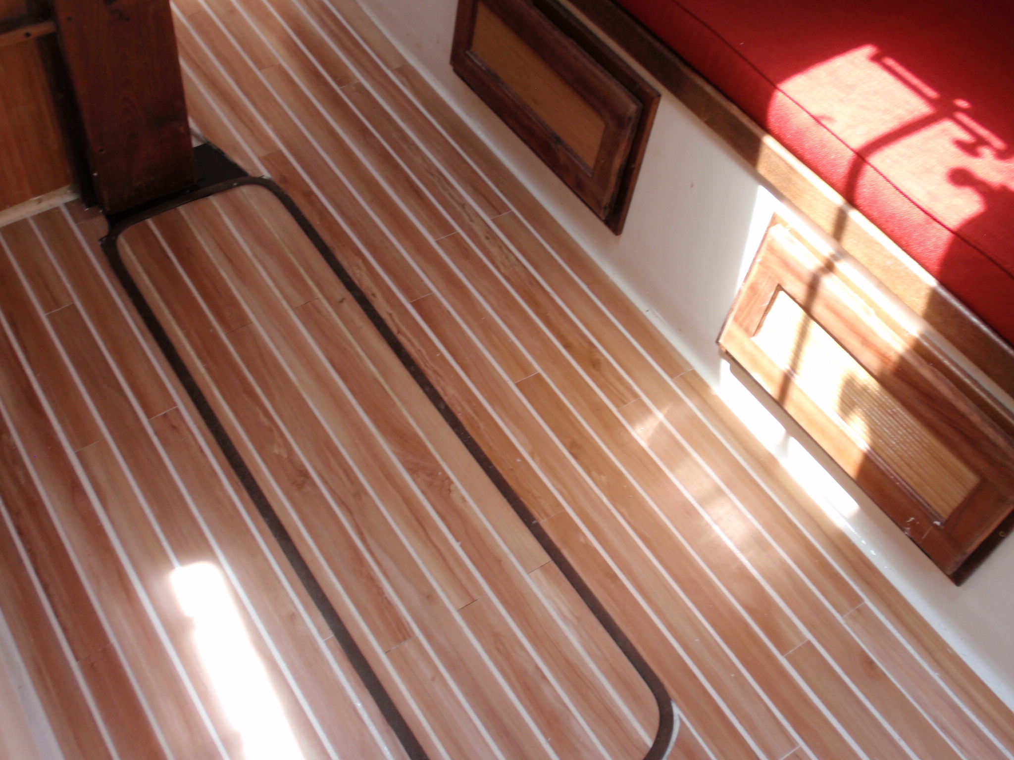

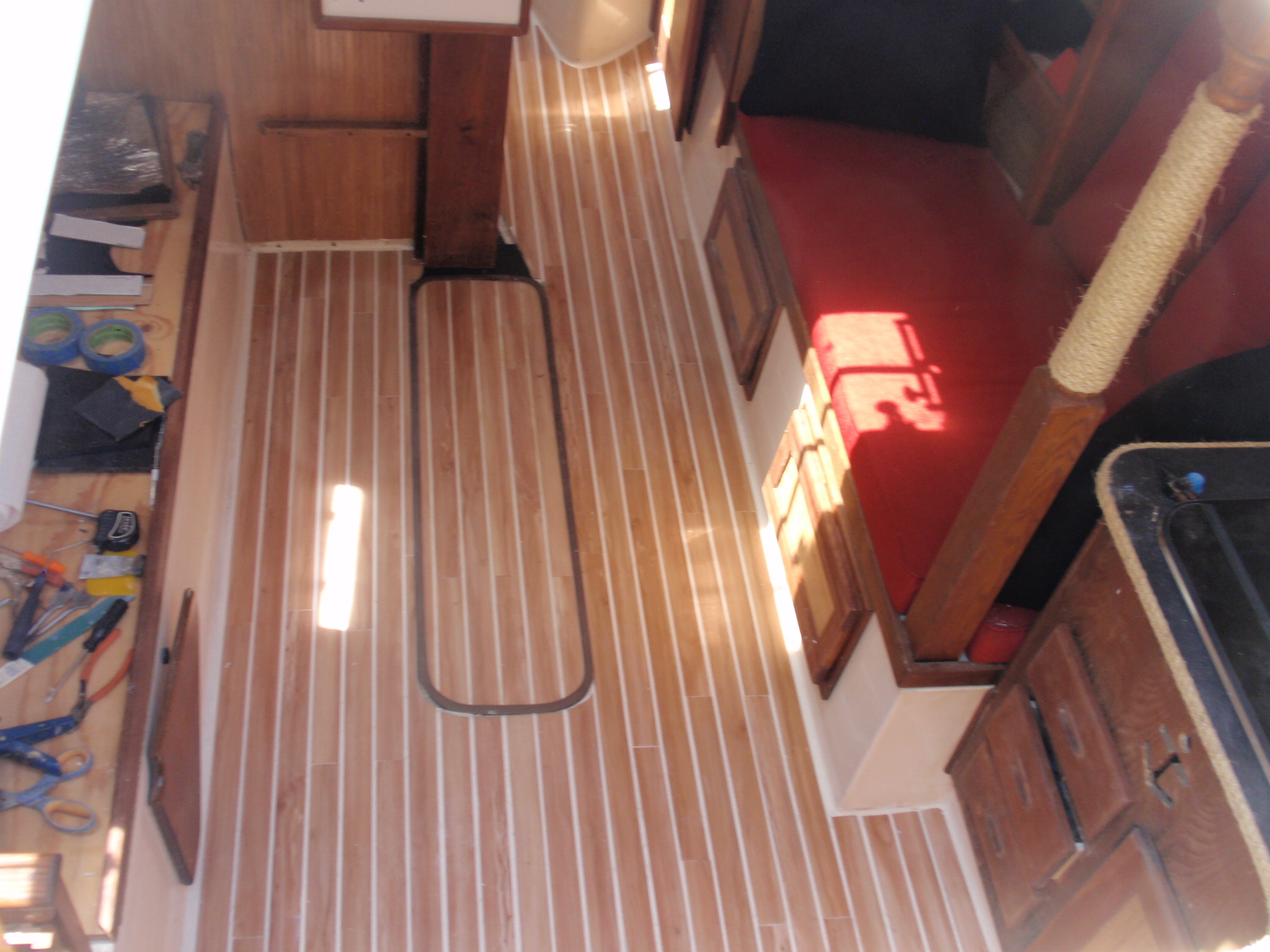

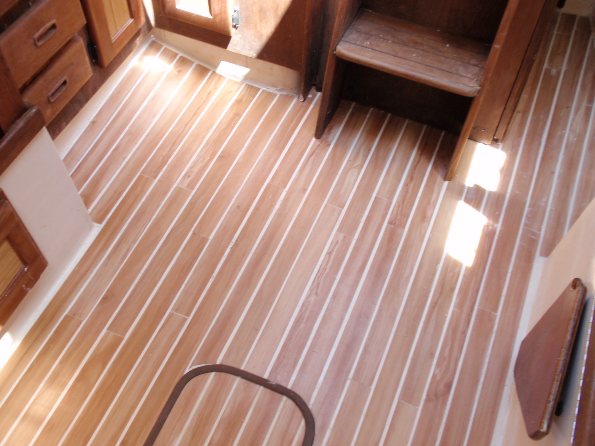

I posted this before but just to give you another option is using vinyl plank flooring cut to 2" strips and use silicon for the "Holly" part. Very pleased with mine plus was a snap to install. The vinyl conforms to the curves in the floor.

Wow that looks great! Have you posted the process and materials somewhere. What type of vinyl plank flooring did you use, how thick is it, where did you buy it, what is it glued down with, is it attached directly to the fibreglass? I apologize for all the questions but you might be the cabin sole replacement guru.
Thank you for the photos.
