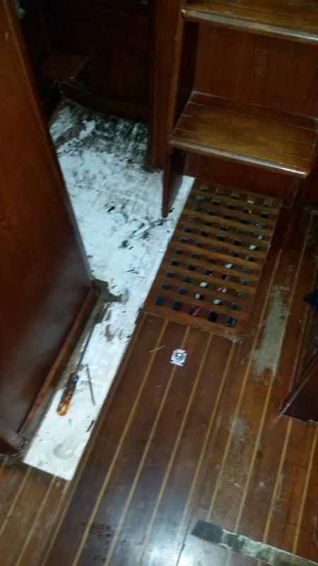

I have pulled up part of the cabin sole, the rotten part in front of the stove and sink. There is a seam just at the front of the sink so I guess I could just piece in a section. But I am leaning more toward a complete replacement with PlasTeak( http://www.plasteak.com/plasteak-re...s/teak-holly-and-flooring/teak-holly-flooring ).
My question regards the 1/8" thickness of the material. I know that our cabin soles are solid throughout, there are no openings excepting the bilge. So do I glue the 1/8" Teak and Holly to the fiberglass? Or do you think that I need an underlayment? I plan to ask the manufacturer the same question.

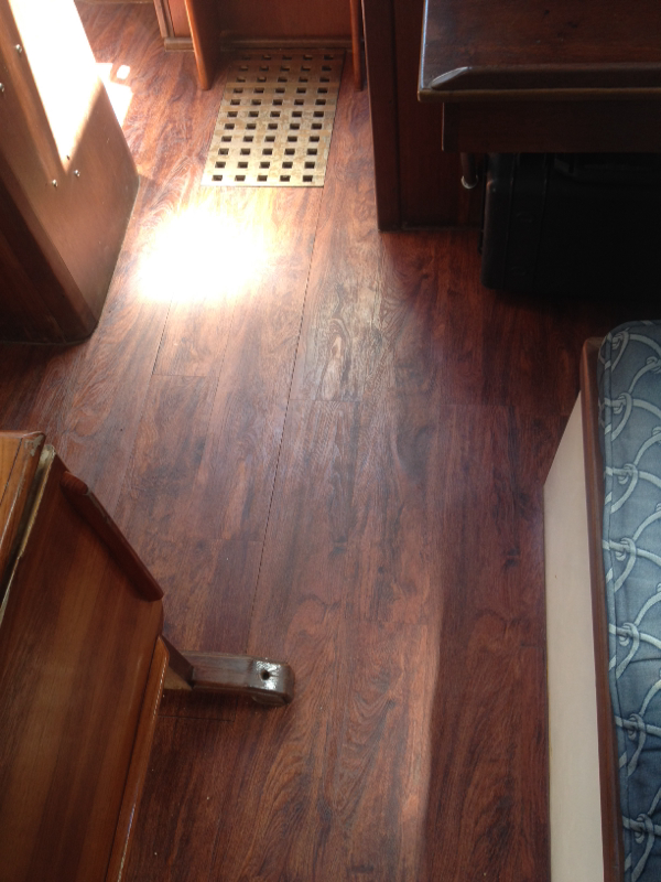

I recently went thru the same questions as my 1/4" teak and holly ply was totally delaminating. I ended up removing the old ply,( it did go under cabinet but i just cut it with a chisel) and going to home depot for "plastic" flooring. Its designed to be free floating but can also be glued, which i did because of the bilge. It is now "plastic" glued to fiberglass and totally water proof. I absolutely love it and considering the cost, about $200 would definitely do it again. It has held up excellent. If i can figure out how, i will post a couple pics as well. As options are limited in the Virgin Islands, this was a great fix

TLD I like that look. How many cases of flooring did you end up needing? Do you think that buying a lighter shade of laminate and cutting "holly" strips to fit in between the darker sections would look decent at all or is it too hard to cut?
Tld
Feb 27, 2015
7
Hunter 37c Virgin Islands
Frankiedogs, as I recall, it took four boxes to do the main section of my 37' boat(at $50 a box). It cuts very easy when its warm with a utility knife and straight edge. I did think about going with the classic look but decided i actually liked the simple, solid look. Of coarse the fact that it would have taken much longer to cut holly strips may have had something to do with it as well!
