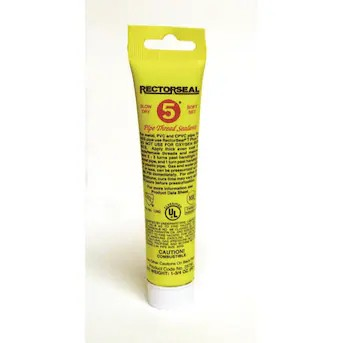

Assuming your threads match, I wrap 8 turns of pipe tape then wipe the above paste on both surfaces, then wait 10 minutes then put them together.

Pipe Thread.. Pipe dope
