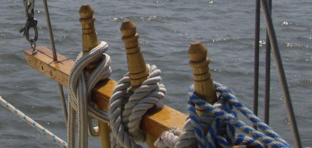

In preparing my boat for single handed cruising, I would like to install pinrails between the shrouds. I have seen some that were fabricated by a sailor (I think he sold them too) somewhere on the net. I have no idea where though. I was wondering if any one else had done this. It would seem to me that this might make dock line handling easier while docking (too often a fire drill in my experience). It would also look salty as heck. I have pieces of teak just laying around saying "Do this to me this winter".

Here is a picture of what my friend Vince did on his Classic 37, Fortnight. It is as good a picture as I have, but maybe will give you the idea of how he managed it. As I recall, he made the pins from materials you find in the window hanging section of Loews, Home Depot etc.
This is how it looked after a winter in the Bahamas.

pinrails and pins should be made of hard wood--the pins are turned on a lathe.....

There used to be a guy on the board that seems to have dissapeared...his name was something along the lines of SailorTony something...he made some that looked GREAT!
Anyone know his correct name so Merry Prankster can look up the post?
And sailortonybob as I called you...if you are still out there please email me...jackhartjr at aol dot com.

if you dont find the fella you are looking for .....you may contact me and discuss the project....as i have a source for teak close by and i also have a full woodworking shop here in ga ........i also have the ability to turn your pins as well ....used to travel the woodworking show and demonstrate woodturning and have turned from seattle to orlando fl as well as melbourn australia
