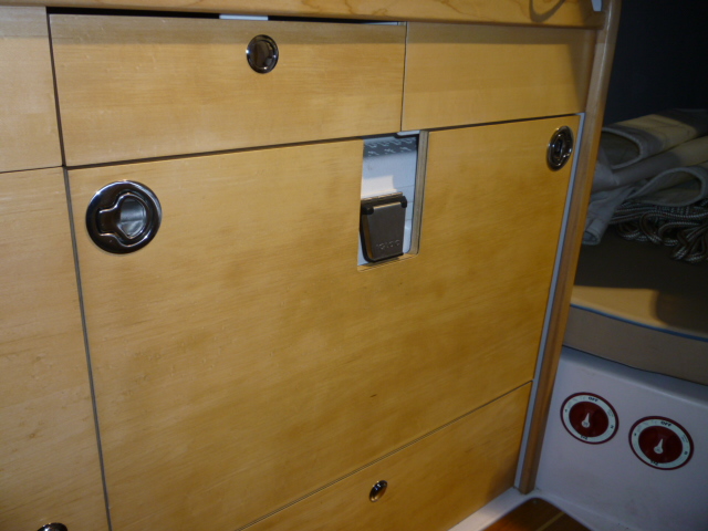

I never thought I would get excited about a latch, but that happened today. I really should say two latches. Unless you've used the cooler on a C275, it is really not possible to understand my excitement. The locking system for the cooler drawer is one of the most Mickey Mouse'd items I've seen a manufacturer do on a sailboat. Especially, an $80k sailboat. Catalina drilled a hole in one side of the cabinet and you're suppose to slide a 1/4" pin from the adjacent cabinet to lock the cooler from sliding open as you sail. If the cooler is full, it does nothing to prevent the other end from trying to torque out a bit while on starboard tack.
After three years, I had enough and looked for a solution. Found two Southco M1-63-8 latches on ebay for $58 (including shipping) and another $4 for screws: (4) 5mm x 14mm, (2) #12 x 1/2", (2) #12 x 1". Drilled (2) two inch holes in the front of the cabinet, carefully drilled holes for the keeper, clipped the tips of the #12 screws so they don't come through the side of the cabinets and added a spacer on the right side. Now I have a cooler drawer that works like you would expect a drawer to work on a sailboat. This is a mod that was well worth it and is exactly what Catalina should have done in the first place. I have a 32 nm first sail of the year in two weeks and I expect to be on starboard the whole way, so that should be a good test for the 187 lb rated latches.

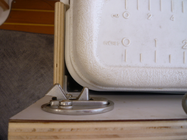

I'm thinking of installing these latches as you have described. Is there enough clearance in the back so that they don't interfere with the cooler? It seems like there might be a depth issue. Thanks.

No problems with the cooler because the rounded edges of the cooler increase the depth right where the latches go. But before you drill for the latches, measure, measure, measure, because you don't want to mess that one up.

This is from the top side while holding open the latch. Have at least 1/2" clearance.

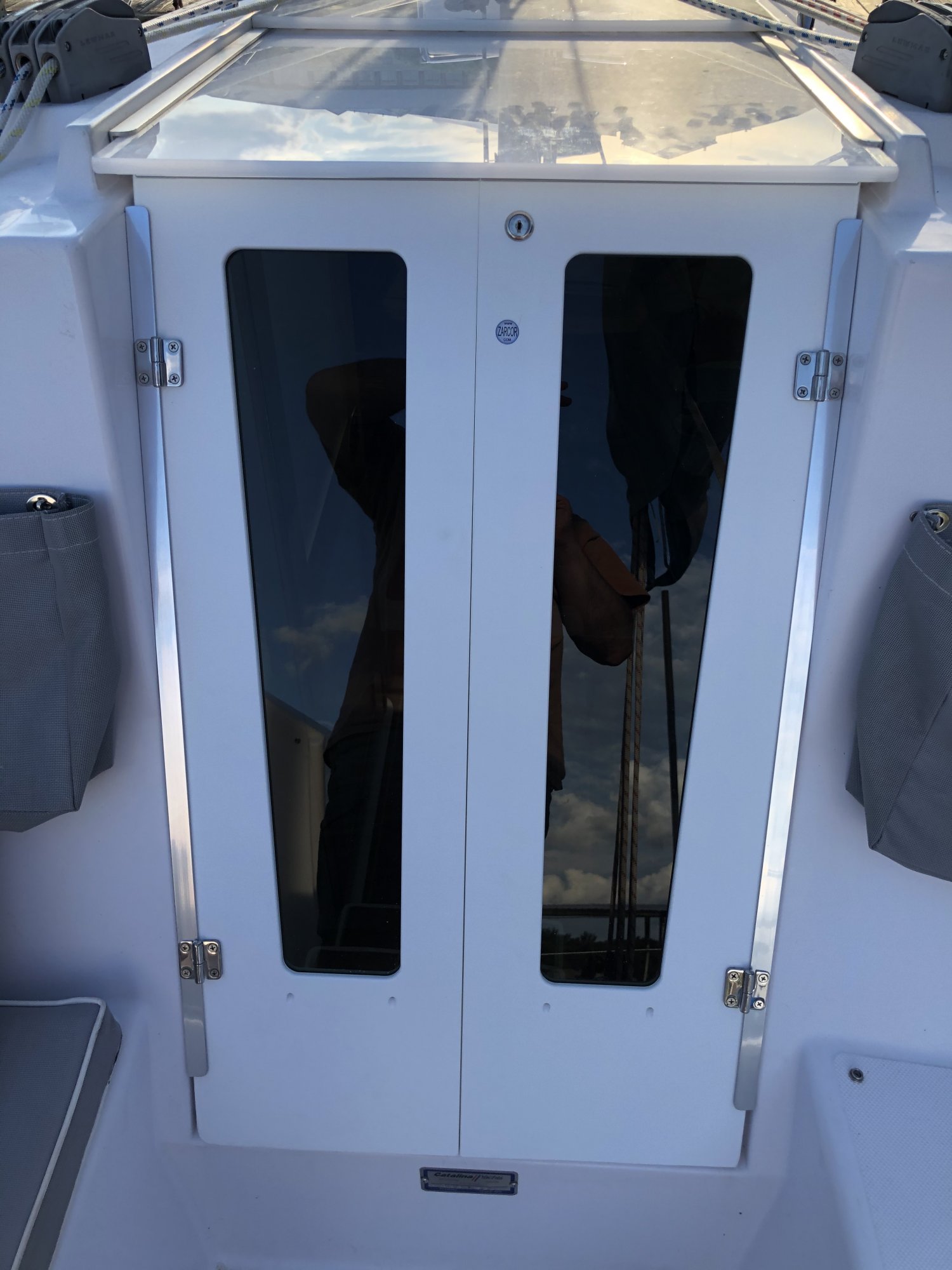

Here are a few mods I have made. First off I had Zarcor build a set of custom doors so I could ditch the washboards.

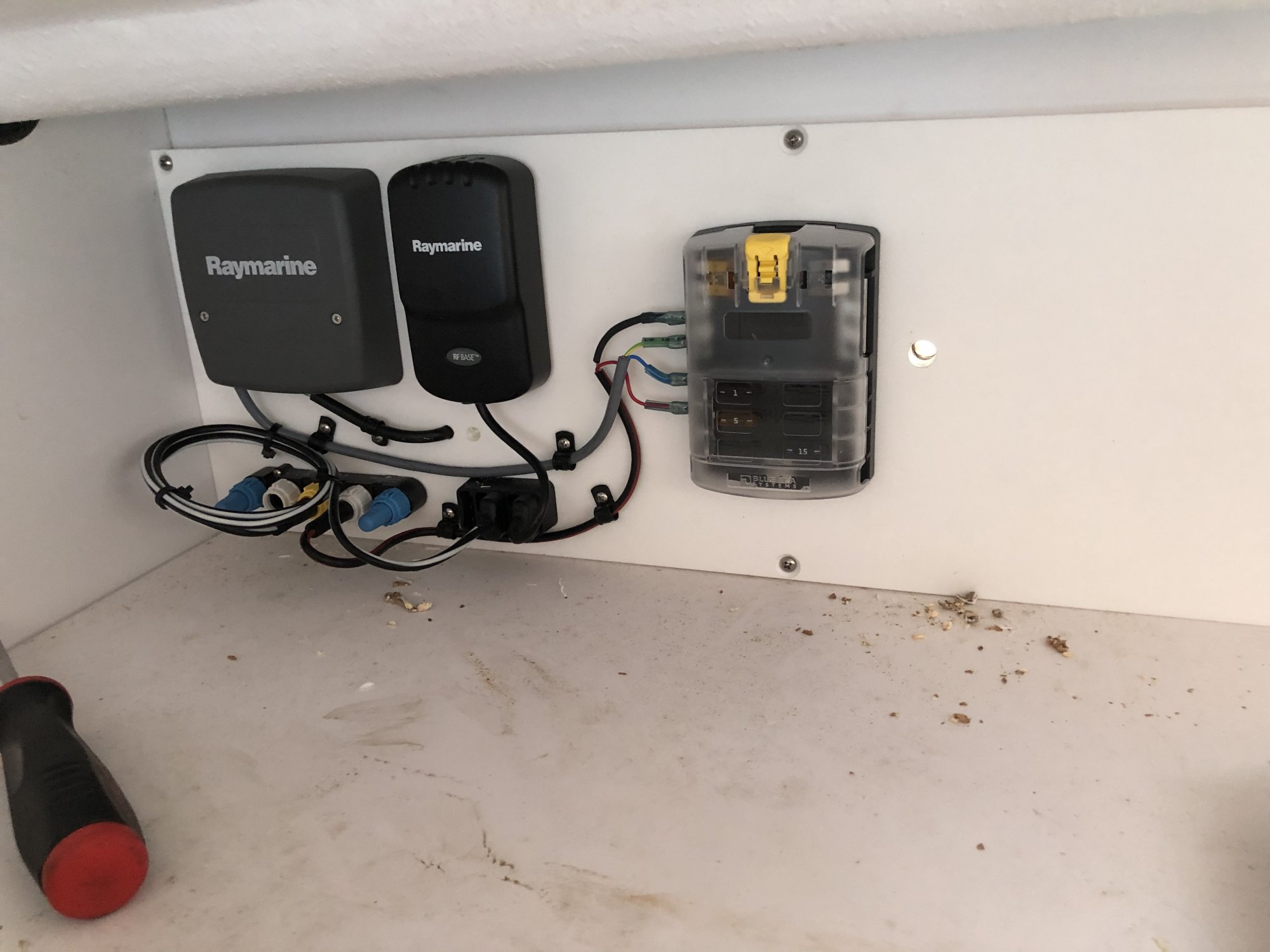

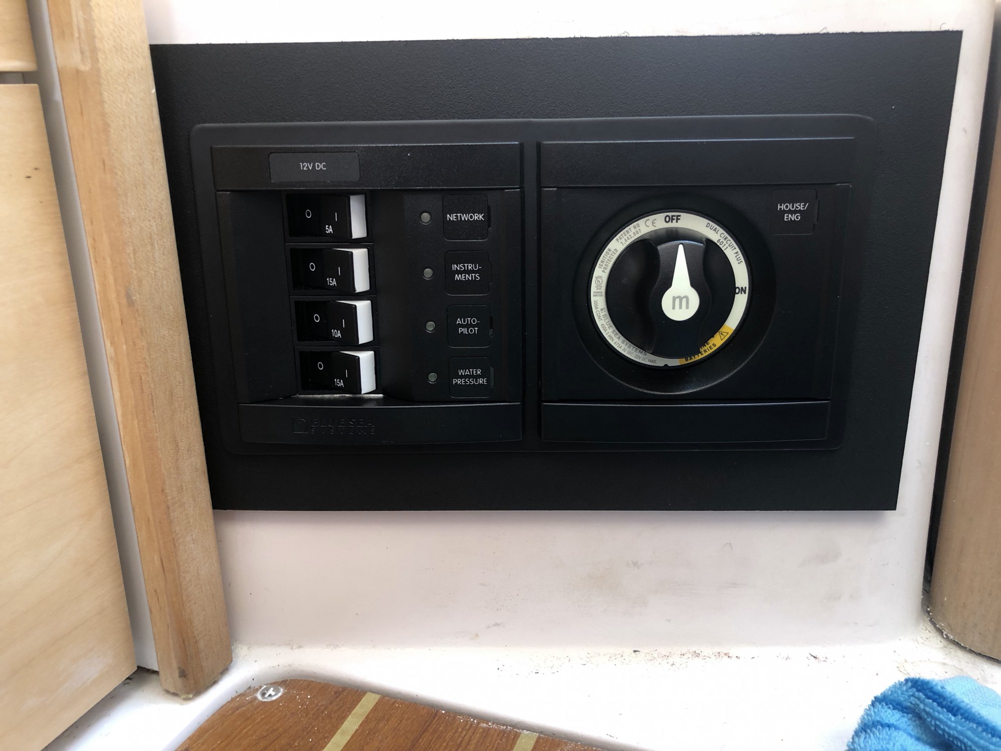

I also wanted to add a second battery, pressure water, and improve the electronics installation of the previous owner. The tiller pilot and hull transmitter for the wireless instruments were just tacked into the bilge blower power. I had this panel built by Blue Sea to give me isolated engine and house batteries plus add breakers. I installed the second battery in the port side locker.

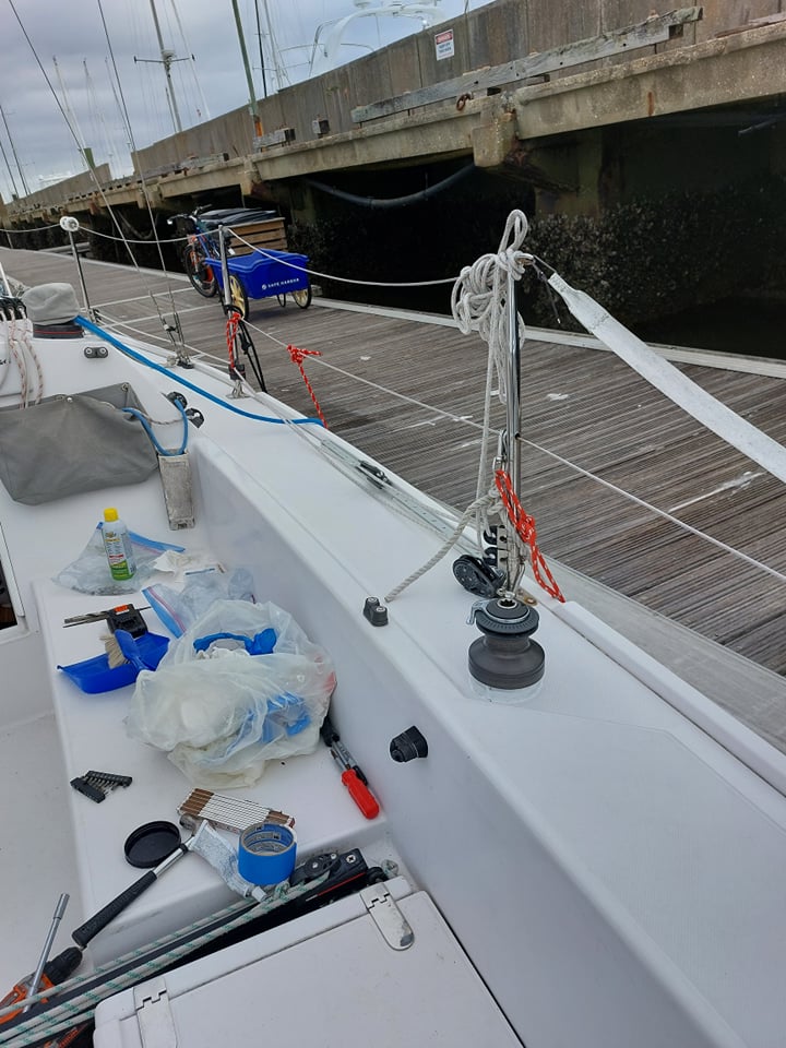

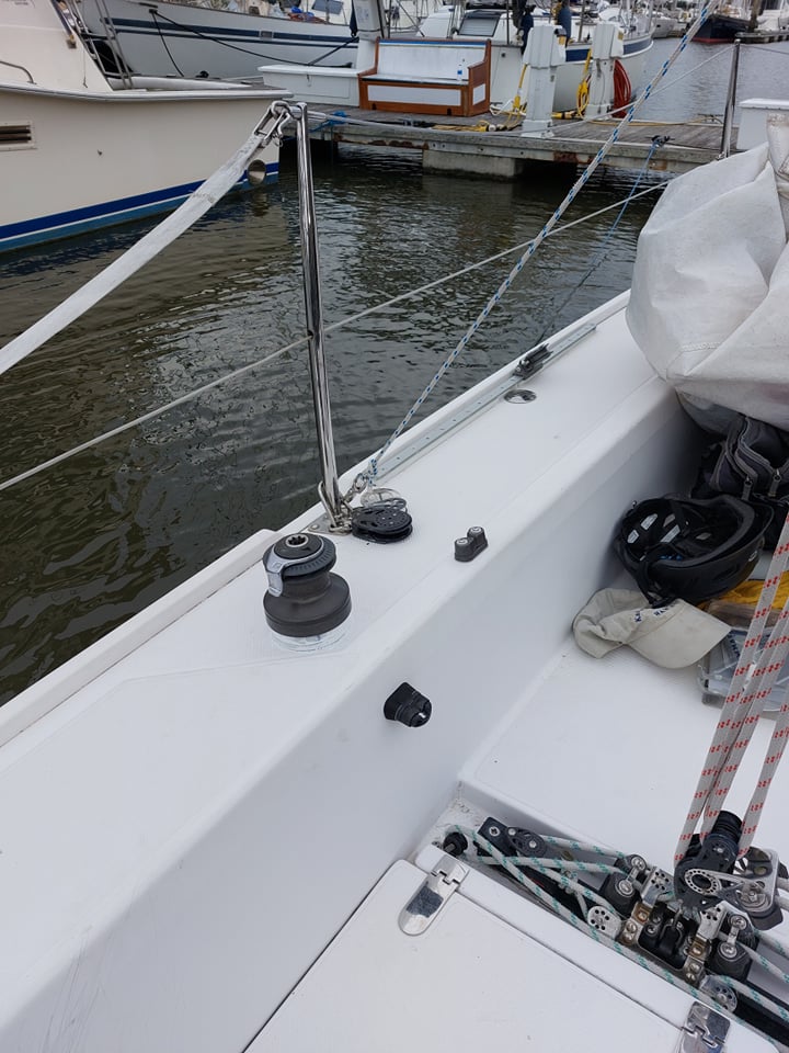

I'm going to install a set of tracks for a Genoa and the Sail Makers are recommending the area just inside of the Fill Caps with a 6 foot long track that runs from one stanchion to another. I know I've seen a boat with this but can't find any photos. If you have I'd like to see them and hear of any issues that you had. Also I need to install a second set of winches to deal with this. I'm thinking of putting them in line with the traveler built up on a set of starboard sheets so its level with the seat top and far enough from the stanchion to allow the winch handle to turn 360 degrees. Again looking for opinions and experience.
I borrowed a genoa from a friends boat to see what the impacts on pointing would be an its really not discernable. On the other hand the power it sends to the boat is about 1.5 to 2 knts more speed same wind... And that's with a Makeshift Block that is hanging off the stanchion in line with the traveler. The borrowed genoa has a luff about 2.5 feet short and as its a 155 off an evelyn with a 9.5 foot J measures out to about a 170 on the foot for the 275. This means the head of the Genoa doesn't even come back to the Spreader but never the less it powers the boat quite nicely. I'm gonna get a full luff on a 155 so I can fly it below 10kts when I'm too lazy to use the Asym... Such as the second half of the summer series where the Spin fleet I'm in doesn't start till near 7 so I don't get back to the slip till near 10 in the pitch dark. By entering the Non Spin feet they start near 45 minutes early, with a shorter course getting me back a bit after 8. So that's my rationalization for the effort and expense.

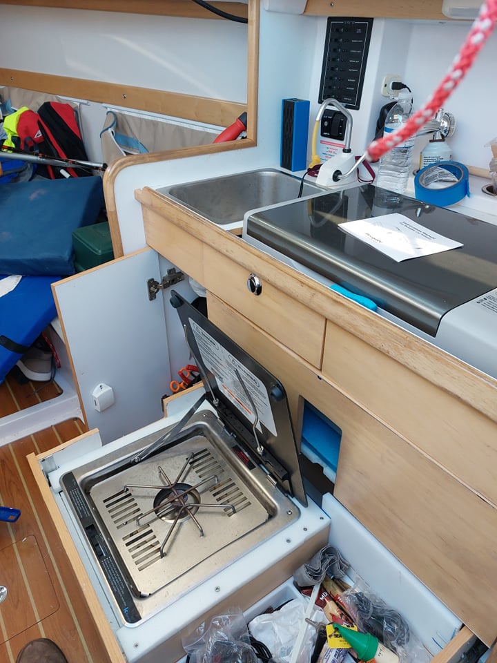

Just Completed two upgrades: Added a 155 with Genoa Tracks and additional winches plus I converted the Galley so the Pullout cooler is gone and the stove is now in the much shorter Draw. This change allowed me to enlarge the hole the stove left so I could drop in a 12V/ 110V fridge once I added a new fixed shelf above the shorter draw for the fridge to sit on... Now of course I'll have to add a house battery and convert the battery switch to a dual from the standard single battery switch that it came with... The Fridge draws about 3-4 Amps per hour. Given I just day sail the additional battery should work nicely...
