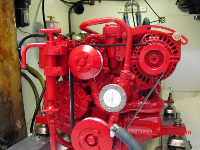

I wonder if when you change a belt, stash a couple spares behind the alternator with zip ties keeping it away from the moving parts. That way if you have to hurry up and change it, you won't have to open the plumbing. Just cut the old belt, slide a new one in place and fasten it in.Nice and clean with lots of room. Now tell me something. How long and how many tools does it take to change a belt?
Just wondering.
Keep it up,
