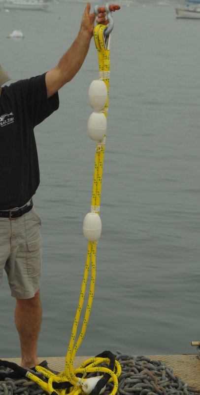

Terry,
Why not use a standard permanently attached pendant? This is the way thousands and thousands of moorings are configured and it makes it much easier..
These are my pendants and they get attached below the ball. If you have an above ball set up this works too.. There's no need to lift all that chain to put a pendant through an eye. I simply reach out the boat hook and grab them, simple as pie..
