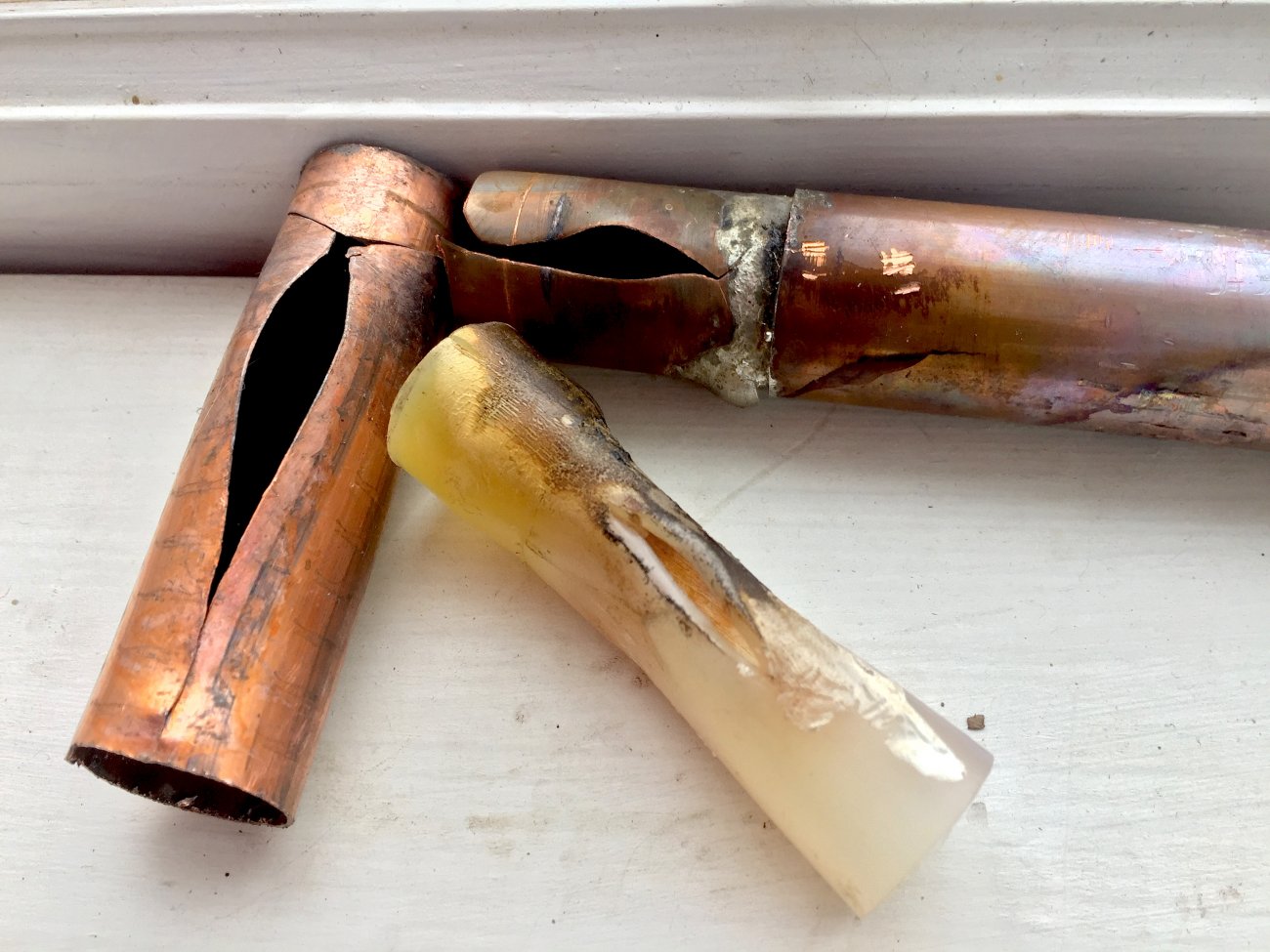

Reinforced PVC will not crack if frozen - I speak from experience. Not sure about PEX.
Pex tubing can crack/split when frozen. Not as fragile as copper tubing, but I've had Pex tubing freeze in home heating lines, with the same damage.
Pex is too stiff for me to use it on the boat. I love it for residential plumbing though.
