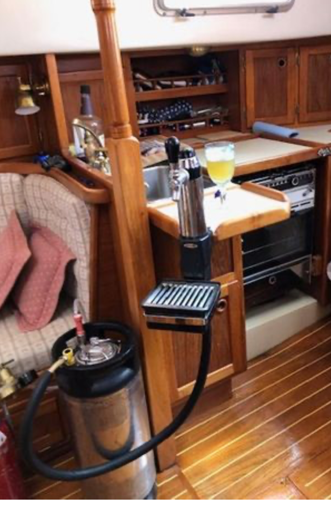

A picture of the gentleman's new yacht is on display with every post....

Hi (HaHa)...should be mandatory on all boats :)
