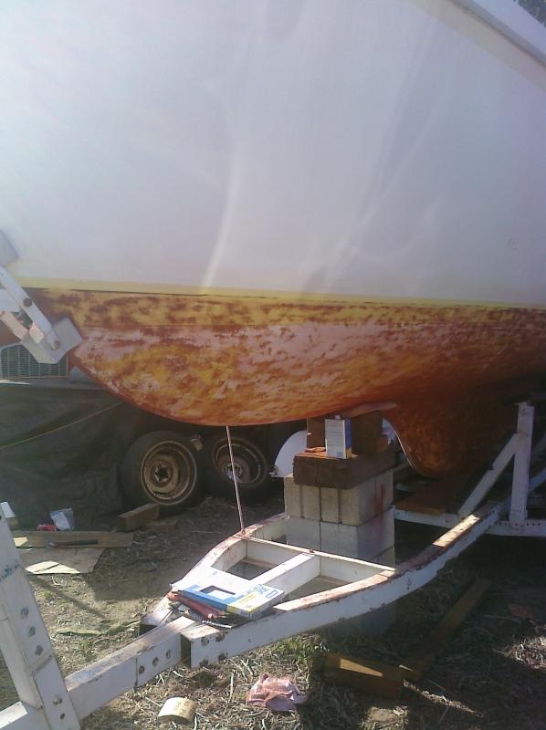

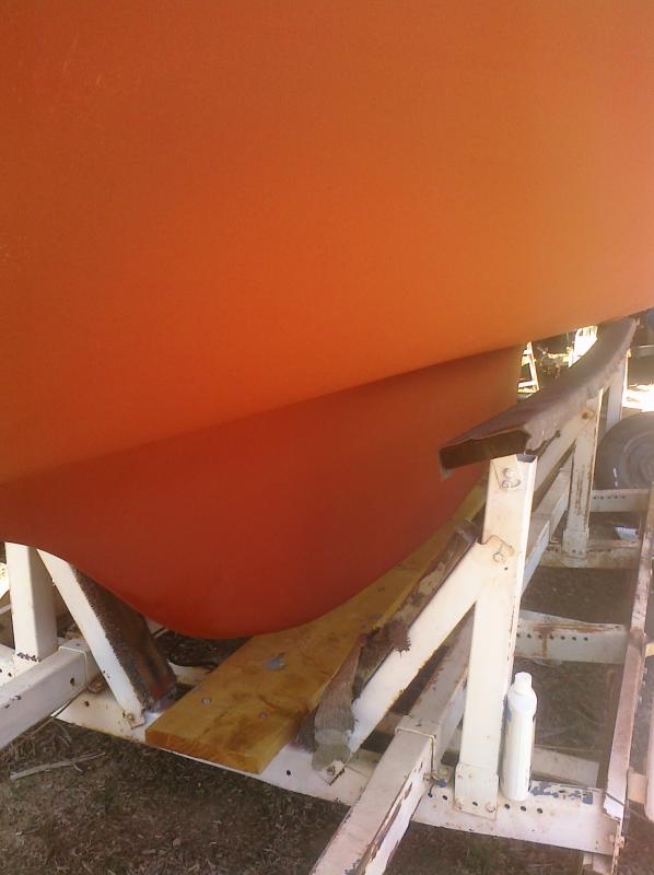

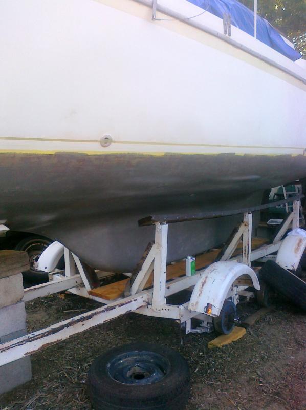

I hate that blue ablative paint as well. I borrowed a rudder from Novelman a few years back and got that paint all over myself. When I rebottemed the Luger I used WM red bottom paint that that is much harder and does not rub off. Since its a trailer sailer it won't be in the water for longer that a few weeks anyway. I also have it in black on the Cat27 and it can crawl around under it without getting smudged. On the C27 (also a tailer sailer) I was able to hit that with the power washer and knock off the ablative paint without affecting the barrier coat. I applied the bottom paint over that and I am very happy with the outcome.

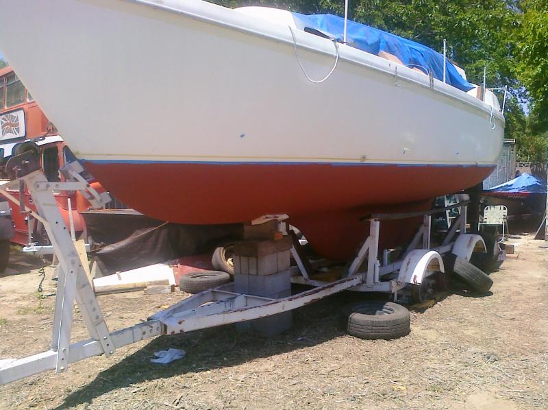

The topside gelcoat is still pretty good. So I will leave it for a season or two, but I would eventually like to paint it dark blue. and leave the deck white. The first post was just the bottom. Here is a shot that is not so tight. The blue line is masking tape. I have since added a 3" dk blue boat stipe.

It looks nice.... so was the orange just a primer?
