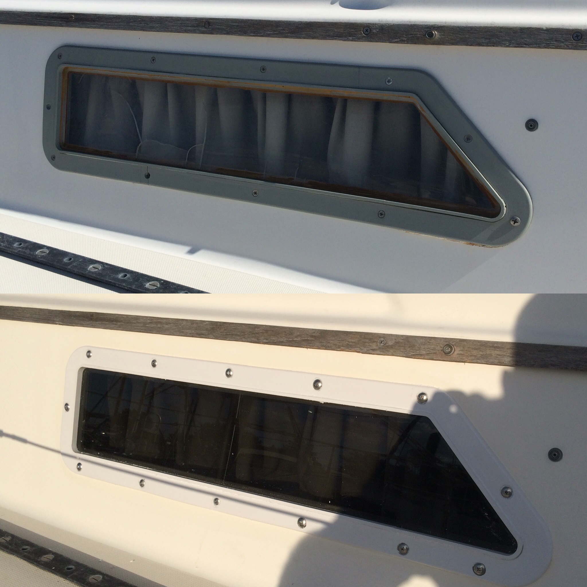

I have a 1985 P34 not the 34-2 so I'm not sure they are the same... But, I got mine from Beckson Marine (http://www.beckson.com/newport.html) the style was PF525. Attached are some before/after photos. It took about 1.5 hours each (remove old window, scrape, clean, sand, re-drill the holes, fiddle with the barrel nuts (a real pain) put down the new bedding compound and tighten her up. So far no leaks and they look a heck of a lot better than the old cracked ones! I ordered these from Defender.com for $251.99 per pair so it was not too painful... actually cheaper to order from Defender than from Beckson directly. If you have any other questions I'll be happy to answer! Oh, by the way, the forward ports (opening ports) are also by Beckson and can be found on the same website. I've rewedded one, took about an hour. If I end up replacing those ports I'm considering ones from Newfoundmetals.com. Good luck on your project!

Thanks for the info. Ports look very similar so likely the same. You did a great job, they look fantastic. Are frames aluminum? What are the panes made of and I am assuming each port comes complete with frame and pane, correct?
Nov 15, 2014
23
Pearson P-34 Norfolk
The frames are poly and feel very sturdy and most importantly will flex with the boat. The panes are rather thick and appear to be Lexan or Plexi but I'm not sure which. Sorry I don't have better answers for you there. They are the exact replacement and I figure I got 30 years from the last so if I only get half that with these I'll be happy!
