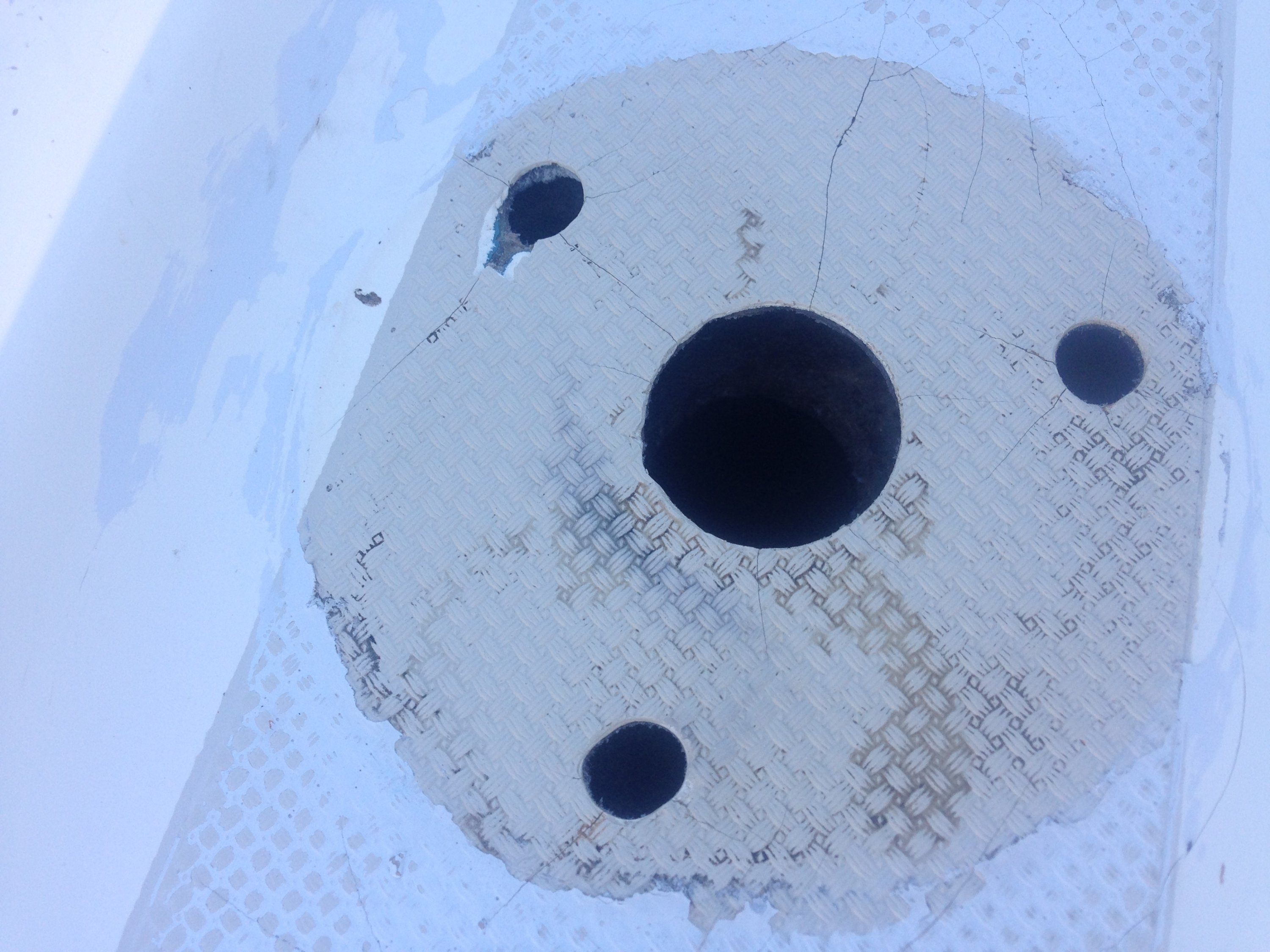

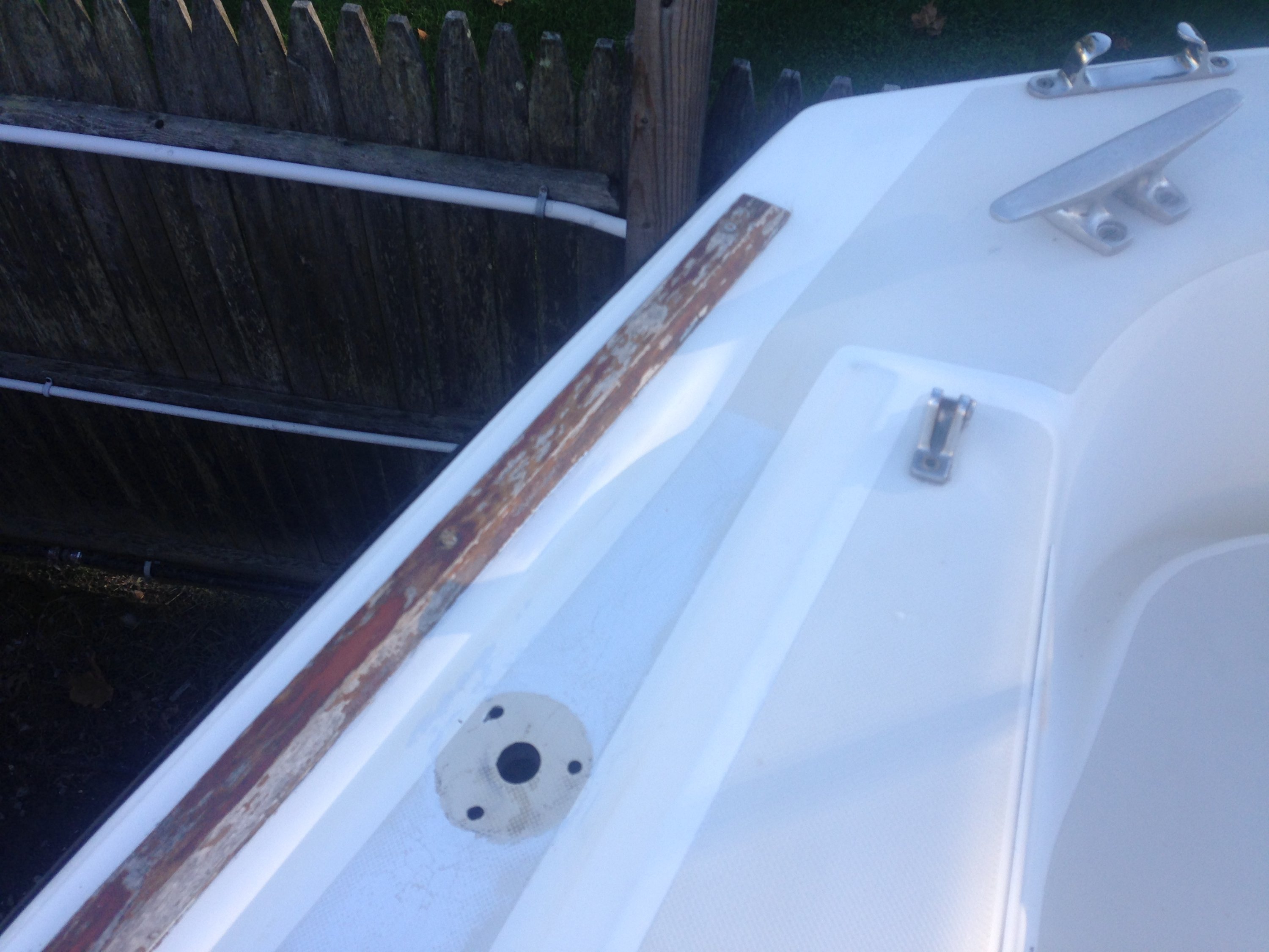

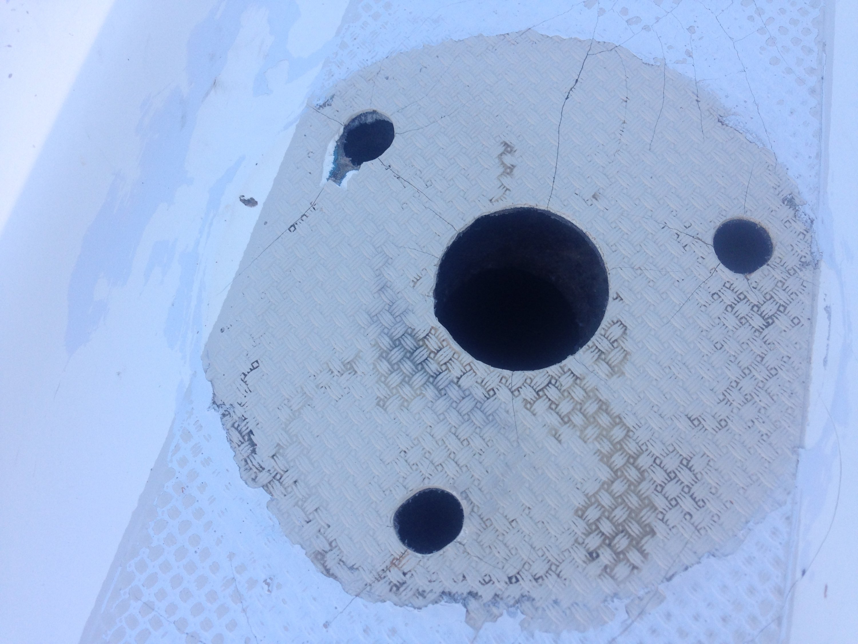

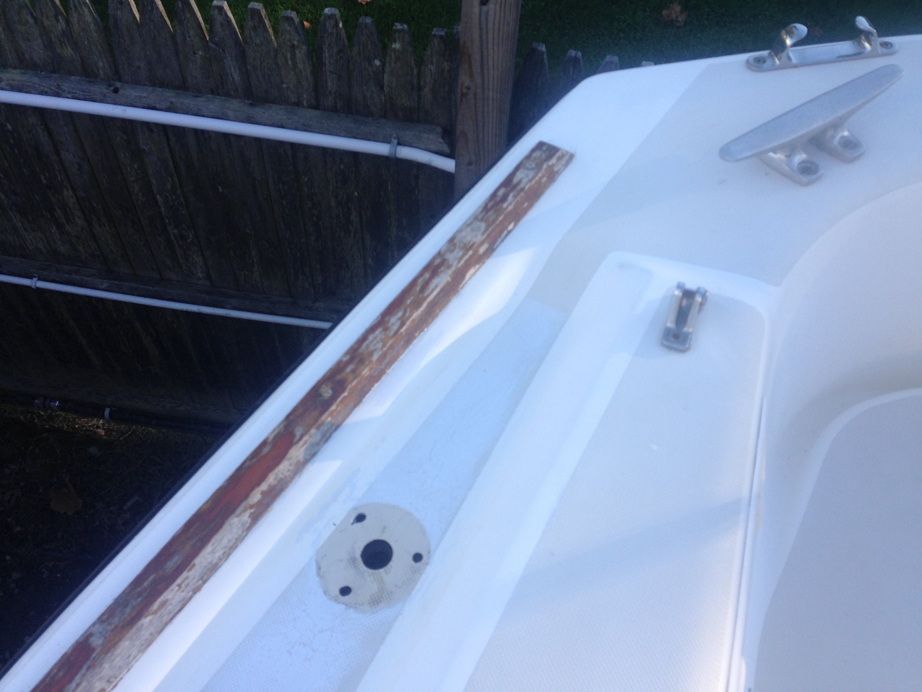

So before layup this year I've decided to rebed most of the hardware penetrating my '83 P303's deck. A few of the bolts show signs of leaking from below so it only made sense to rebed and epoxy pot everything I can. I started with the stern rail and when the two stanchions that fasten through the starboard and port rails were removed the water penetration was obvious. Black, wet, mush. I pulled out as much as I possibly could through the three mounting holes and the larger center hole - I probably got at least 2" in each direction. My question: this is a very narrow section of deck due to being so far aft and located so close between the deck joint and the cockpit. I don't want to cut the deck open and recore; can I pull as much wet material as possible out through the existing holes - even possibly adding another hole further forward to get more wet out, and then fill with thickened epoxy? Thanks in advance, Mike.
