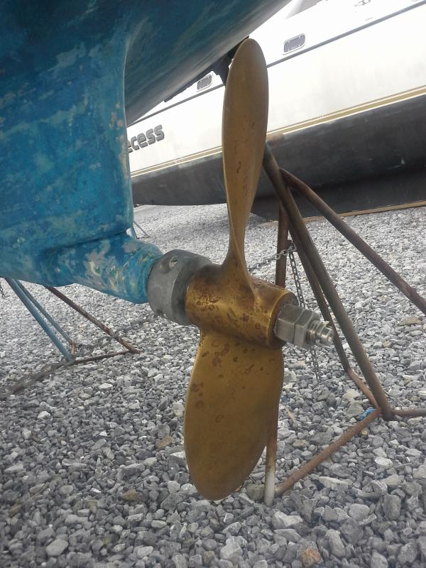

Hello Pearson owners! I think I need to change out my Cutlass Bearing for spring launch..lol That's if the snow goes away! However; I'm told the best time to do this is in dead winter of 0deg. temperatures. So I need to know 1. What bearing to get (size, stainless vs. Brass) 2. Any information for removal of old one, tools etc.... and 3. Any GOTCHA's would help too :))
Best regards, Capt. Rob
P303 #221
Note: I can move my shaft 1/4in. all around.. and inside the joint wobbles while underway.
Many thanks to Captain Keith for providing much needed help!
Here is information on the Pearson 303 Cutlass Bearing:
Who! Deep Blue Yacht Supply
Part Number-( BALE )
Shaft = 1 inch. Outer Diameter. = 1 1/2 inch. Length = 4 inch.
The best part is the price! $ 49.99
