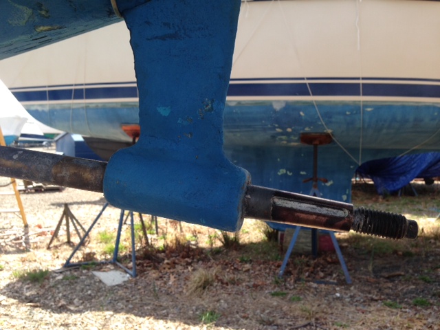

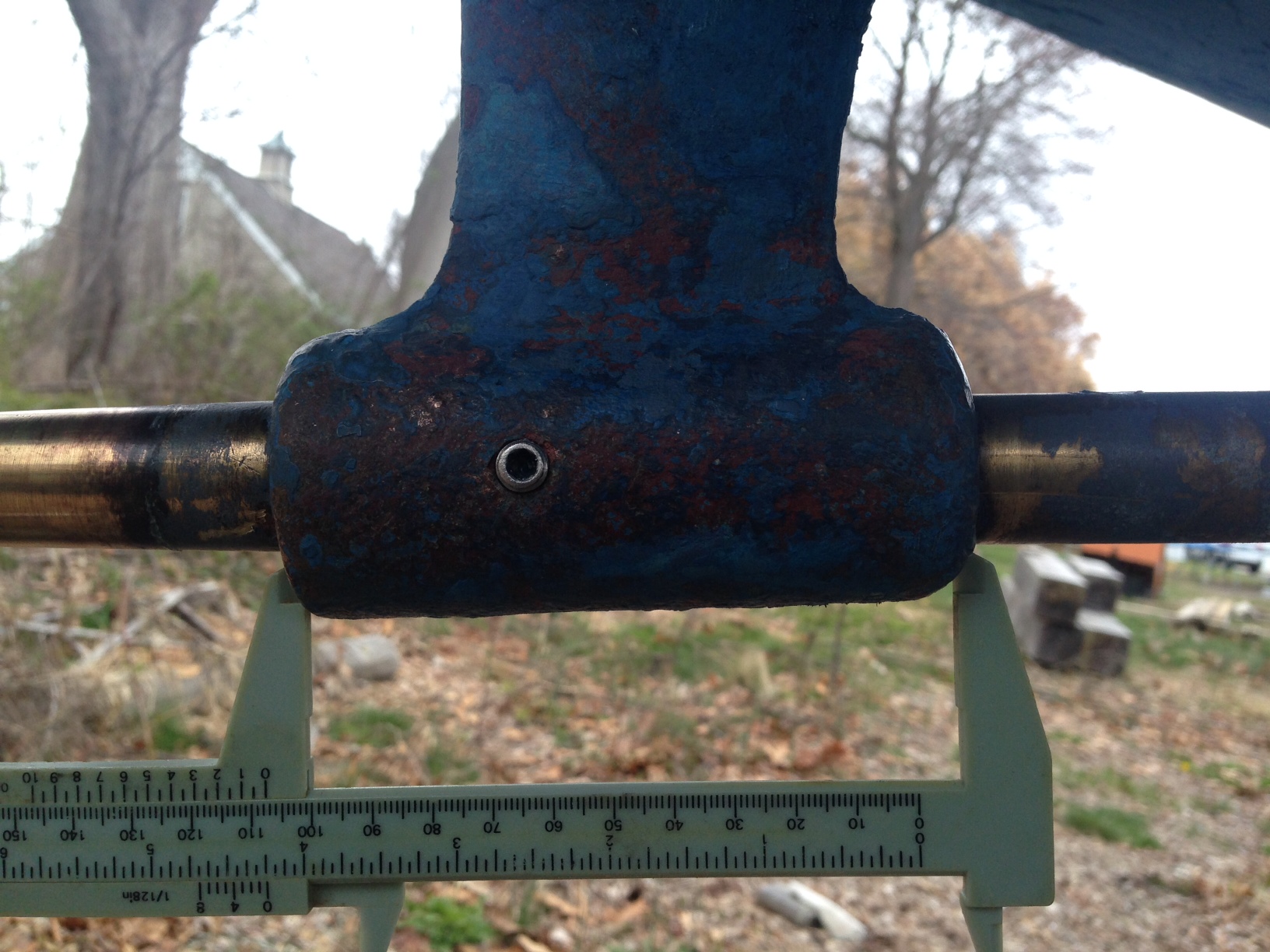

So I started a project to replace the Cutless bearing. My plan was to perform a 'shaft-in' Cutlass bearing replacement using the 'Strut-Pro' bearing removal tool. First, I removed the Martek folding prop. Then, I cleaned up the prop strut to take accurate measurements so I could correctly specify and order the Cutless bearing. This is when I encountered my first obstacle - the Cutless bearing is a non-standard size - I measured 1"x1-3/8"x4-1/4" and the standard size is 1"x1-3/8"x4" - 1/4" short! My options are: (1) have a custom bearing made but that will take time and cost more, (2) use two bearings and cut them so that there combined 'stacked' length is 4-1/4" being careful to align the water channels, (3) use the standard size and justify it to the front of the strut leaving a 1/4" reveal on the aft side, or (4) use the standard size bearing and cut the strut to match the bearing. I'm leaning toward the last option.

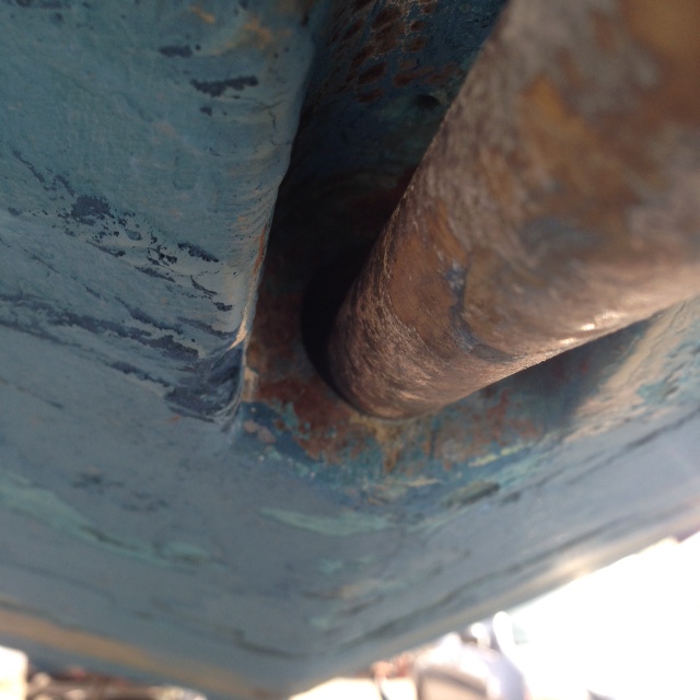

The Strut-Pro tool I was planning to use to remove the bearing without removing the shaft turned out to be harder to find than I thought. My plan was to borrow/rent one because the price of the tool is around $400. In the process of looking around for one, I learned a couple of things. First, in ideal conditions, the tools works fine - but in many more 'less then ideal conditions' the tool is ineffective requiring the shaft to be removed and the bearing removed using traditional methods (e.g. hacksaw blade). Secondly, after talking to some yard mechanics it was recommended to remove the shaft anyway to check it it was bent. Replacing the Cutless bearing with a bent propshaft would cause premature wearing of the bearing. In fact, I believe my prop shaft may be slightly bent because when the prop key is at the 12:00 position there is space at the top of the bearing, and when the prop shaft is at the 6:00 position there is space at the bottom of the bearing. So I gave up on the 'shaft-in' Cutless bearing replacement and opted to remove the brass prop shaft and replace it with a stainless steel prop shaft.'
Removing the prop shaft will also give me the opportunity to replace the stuffing box hose and clean/repack the stuffing box. Maybe I would even explore the possibility of replacing the stuffing box with a drip-less system. Also, in order to get the prop shaft past the rudder, the rudder has to be removed. This would provide me with the opportunity to replace the rudder bushings.

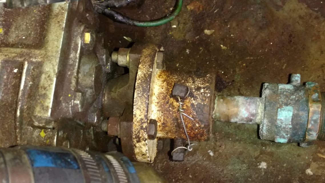

Wouldn't mess with strut until you have a straight shaft to use as a guide. The engine looks like it needs to go up and to port to center the shaft in the stuffing box hole get all that straight with the new mounts, then check the strut with the new Cutless . It may be OK once you get the shaft positioned correctly at the engine end. It is a tedious and exacting job.. take ya time and write measurements to help yourself to visualize.. don't worry about the bearing length, use the 4" and it really doesn't make a difference if it is centered or left or right justified (flush end). Good luck

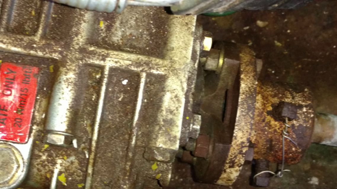

Thanks for the info. I agree with your assessment that the engine is sitting low. I think I found a source for a replacement engine mount kit which includes the four flexible mounts and shims. They don't look too bad to replace, and I think I can replace one at a time without hoisting the engine - we will see about that!

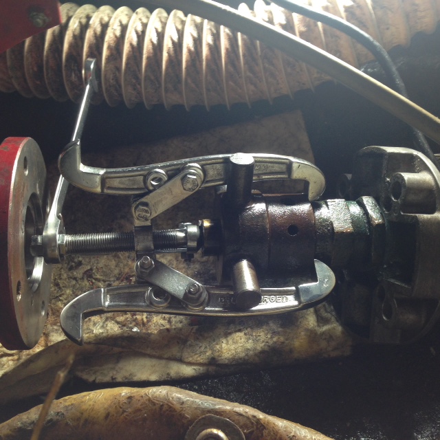

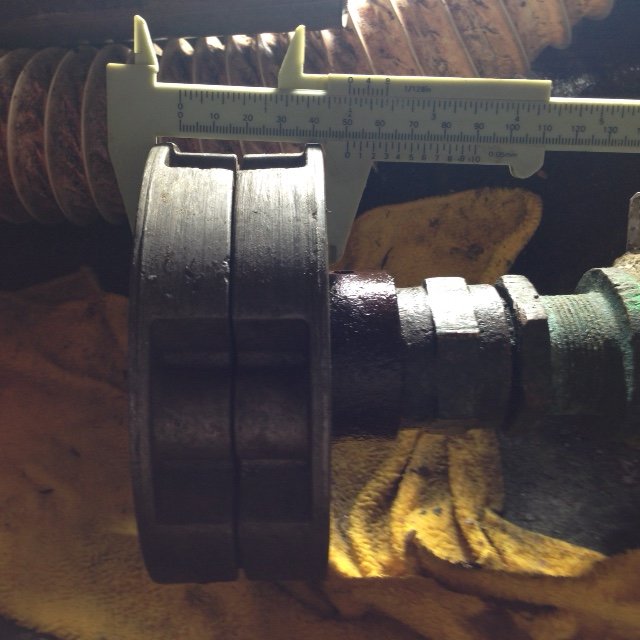

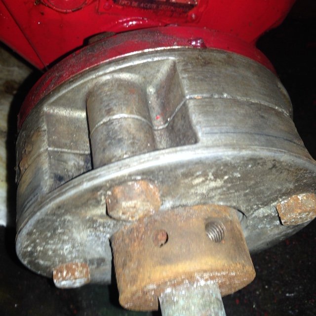

Before I can order a new shaft to check the alignment, however, I need to get the old shaft out. Currently, I'm trying to get the old flexible coupling of the end of the shaft. I managed to break the claw off a wheel puller last weekend. I tried heat from a propane torch, but think I need to try more heat. I am going to try a a higher temperature 'MAP' torch this weekend. Since I know I'm pretty much replacing the shaft, I could just cut it out. My preference is to not do that, but if push comes to shove, I might have to.

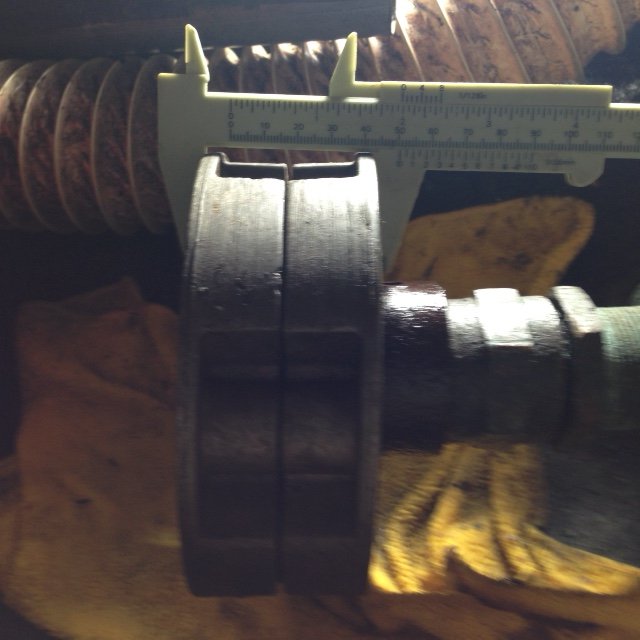

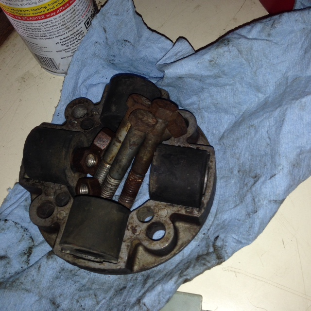

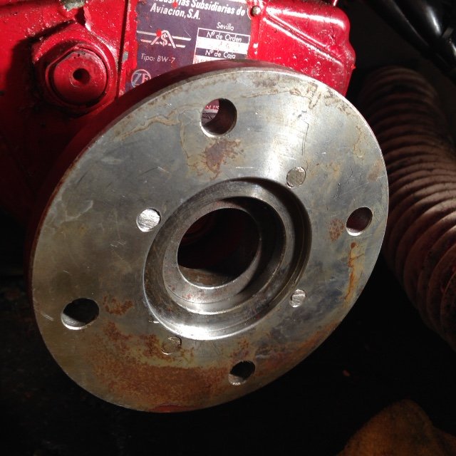

Then, I have to decide if I am going to replace the flexible coupling. That will depend on how successful I am removing the shaft from the coupling without damaging it. Since I'm going through all the trouble, I may just replace it anyway for good measure. Since I can't seem to locate the original one, I'm looking at one from Federal Marine.
With the old shaft out (hopefully in one piece), and the new flexible coupling in my hand, I should be able to determine the measurements for the new shaft. The existing shaft is brass. I'm looking to replace it with stainless steel one (A22).
I also agree with you on the size of the Cutless bearing. I'm planning to order the 1"x1-3/8"x4" Duramax Johnson Cutless Bearing, and, if I don't remove the strut, justifying it to the front. I heard some other arguments that a reveal in front of the bearing (because it is centered or rear-justified) could affect the water flow through the bearing due to either cavitation or debris collection. This is probably a minor point. If, however, I have to remove the strut to properly align it or re-bed it, I will likely trim 1/4" off the back of the strut, making it flush with both ends of a 4" long bearing.

if you are replacing the shaft - a sawsall or abrasive cutoff wheel will free up the flex coupling and allow the shaft to be removed. You can then have the flex coupling pressed out at a shop.

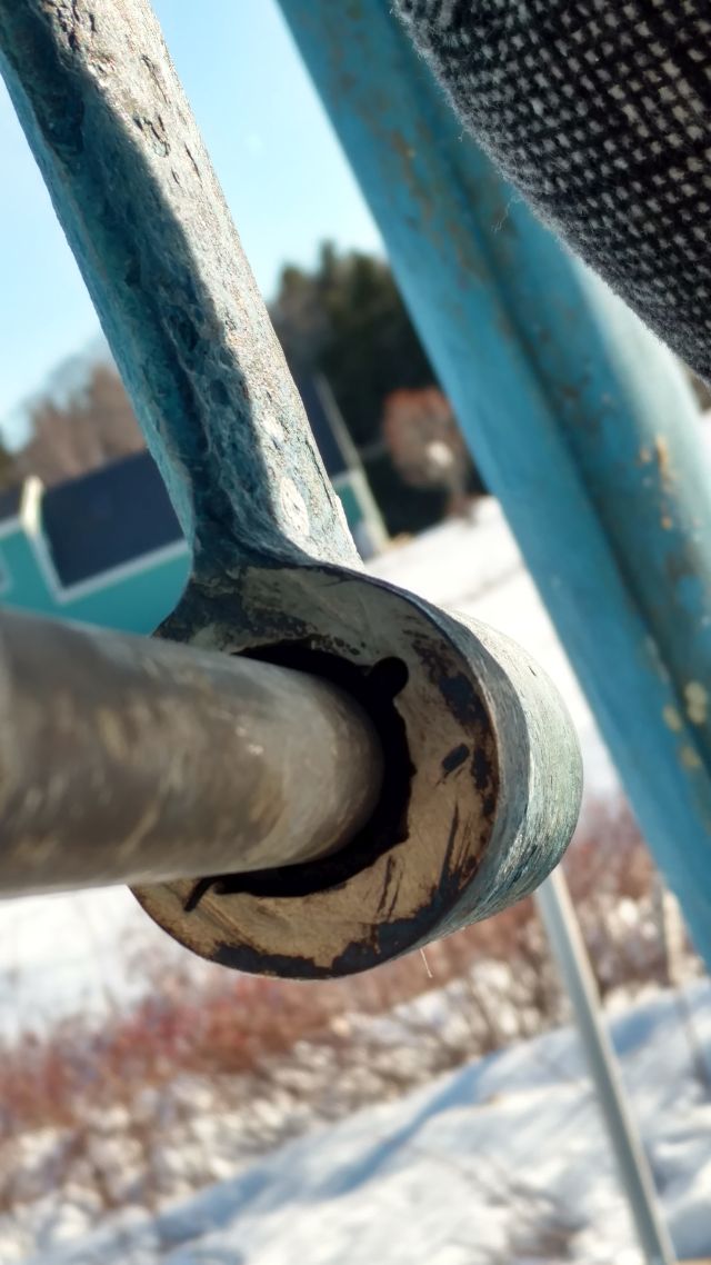

So here is where I am. Seems that on the older pearson 30's they used a strut that has a lip on the forward end that prevents the use of a Strut-Pro. Therefore in order to remove the cutlass bearing , I am probably (one last ditch effort tomorrow to free the bearing from the strut) i will be cutting the shaft (bronze) since my hub appears forever corrosion bonded to the shaft (see pic). Then I will get a new Aqualoy 19 or 22 shaft with a new hub and while that is being made I hope to be able to remove the bearing. There might be a whisker hope that I can fit the shaft past the rudder but if not I will have to drop the rudder - which for me is a bigger deal since I have a wheel and not a tiller. I will replace the shaft log hose while I am at it since it makes sense. Then with the new shaft, hub, log, I will reassemble and then use the Shaft-Pro to put the new bearing in. My bearing appears to be a 3 1/2 inch with a 1/8 inch metal wall over a 7/8 inch shaft. The larger, lurking issue is that the wear on my bearing may have been caused by the boatyard that did the bearing for the PO since they may have done the job by removing the strut and not aligning properly when replaced - this would require removing the fuel tank since the bolt connections for the Strut appear to be under the fuel tank. SO THERE YOU HAVE IT
