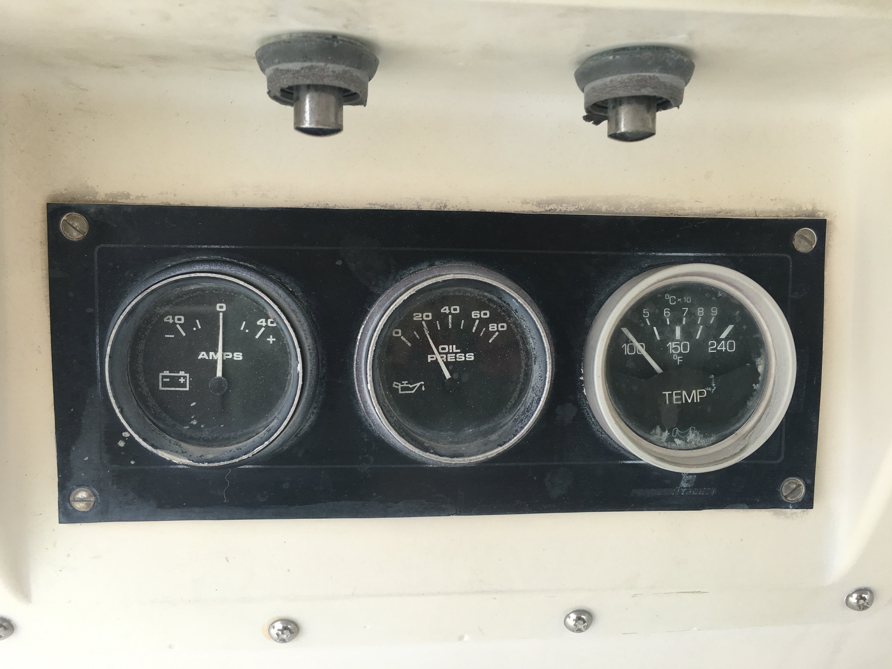

Hi - thanks for the help. I was doing some work on her today, and did a test run on the engine. Everything is working, but now I need to troubleshoot my engine panel: the gauges aren’t giving any readings...
Here’s a picture of the panel:
24,589
Gauges giving readings depends on the engine running, the wires connected, to functioning sensors.
Often times it is a ground corroded connection that causes lack of function.
Places to Start:
  1. Look for corrosion of the wires at the connections.
  2. Look for loose wires.
  3. Check the continuity of the sensors.
  4. Check the ohms reading of the sensor.
