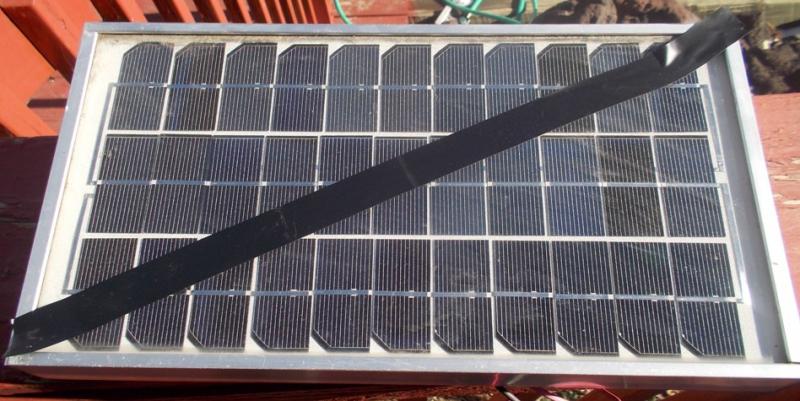

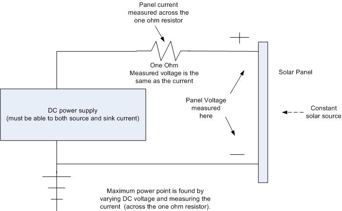

I hooked up a 5 watt solar panel that I picked up with a used boat purchase so don’t know much about it and measured current vs. voltage for this panel for both full sun and partial shade (see the picture for partial shade – its just some electrical tape). The setup is simple, just a power supply that can either source or sink current with a 1 ohm resistor in series to the solar panel. A hand held DVM is used to measure the voltage across the 1 ohm resistor (current is the same as the measured voltage) and also measure the actual voltage on the panel.

I took this single panel and put in full sun with a way to “force” the voltage (with a power supply) and measure the panel current. I then put a piece of electrical tape on the very same panel right after I did the first test (so the sunlight was the same) and repeated the measurement.
This is the panel with the partial shade:

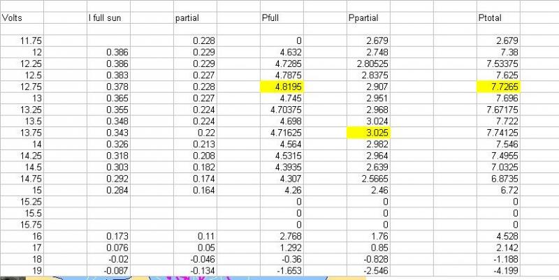

The image below shows the voltage and currents I measured (put in a spreadsheet to calculate power).
Volts = forced panel voltage
I full sun = panel current with NO shading
Partial = panel current with the tape across it (partial shading)
Pfull = power generated by the full sun panel at the Voltage (i.e., Volts * I full sun)
Ppartical = power generated by the partial sun panel at the voltage (Volts * partial)
Ptotal = Pfull + Ppartial at the forced voltage
What you see from this actual data is that this particular panel has a peak power 4.81 watts at 12.75 volts for full sun and this is where the MPPT controller would also operate the single panel. The peak power points are shaded yellow in the figure above.
What you see when the tape is put on the panel is that the current is reduced considerably (from .378 amps down to .228 amps at 12.75 volts). However, the current output does not change as much with voltage as for the full sun case.
