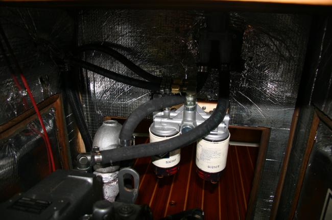

A little over a month ago, I did a post inquiring about installing a second primary fuel filter in parallel with the first. This was motivated by a rough day out on the ocean last summer which stirred up crud from the bottom of my fuel tank and partially clogged my Racor causing engine RPMs to vacillate up and down--definitely not a good feeling. So I thought I'd share what I did. At the suggestion of the woman who owns and runs my marina, I bought a Racor 75B/32009 dual filter housing with a switch. The switch enables you to select either one of two filters or to run them both at the same time. That way if one filter becomes clogged, you can switch over to the other without difficulty and without the necessity for bleeding the fuel lines of air. It's a real benefit which keeps you running in an emergency or keeps you from being buried in the engine compartment on a rough day at sea for 15 minutes while you change the filter and bleed the lines. Total cost for the project (I did the installation myself) including connectors and some fuel line extensions came to about $500.00. If you do much sailing on rough waters, this could be a very smart investment. Gary Wyngarden S/V Wanderlust h37.5

This is one nice installation!
And I bet it gives you a lot of confidence. Where are the flow switches located? Are they electronic or manual cut off/on switches? I assume to the two hoses shown are coming from the fuel tank. Is that right? Where is the output from the filters to the lift pump?

Thanks, Warren
The switch is a manual three-position switch on the front of the housing. In the pix its kind of hidden behind the hose on the anti-siphon loop. There are only two hoses. One comes into the housing from the tank, and the other goes out to the lift pump. The rest of the plumbing is internal to the filter housing. Gary Wyngarden S/V Wanderlust h37.5

Thanks, Warren
