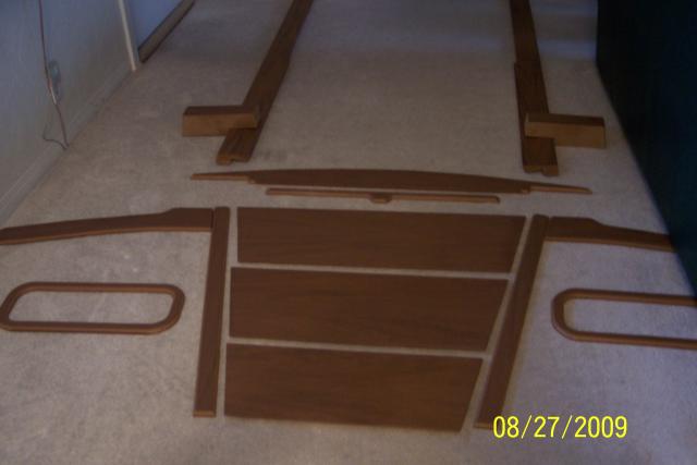

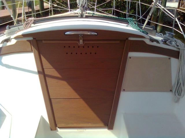

Don't paint it, you will be disappointed. Because I say "life is too short to do your own teak", I recently changed all the deck teak to a synthetic PVC using their deck board and facia. The product is called "Sensibuilt".
This is but an alternative. Here are some pictures of the product pal.

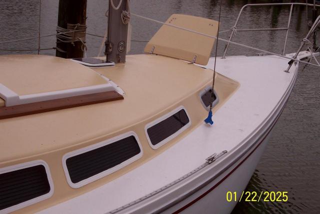

Looks good. My teak was 45 years old and rotten/worn out. Didn't want to drop $700 in materials and have to keep up brightwork so I went with Azek. The synthetic is a lot easier to work too.
Pics are from before I painted the hull.

CR, looking pretty good..I have been slowly replacing my teak with white PVC board. That wood grain, if it looks like wood, might be a good alternative too.

the 'teak' looks fine, more than fine actually, but what happened to the lower shrouds? tell me how you keep the stick up with only uppers.
Jan 6, 2010
1,519
Joe, Shipwreck & JR,
I didn't attach the lowers when the pics were taken. I took the chainplates off and cleaned them. one had to be replaced also. I found a DOW Corning construction chaulk called 795. This stays pliable and I used it for bedding all top deck fittings.
