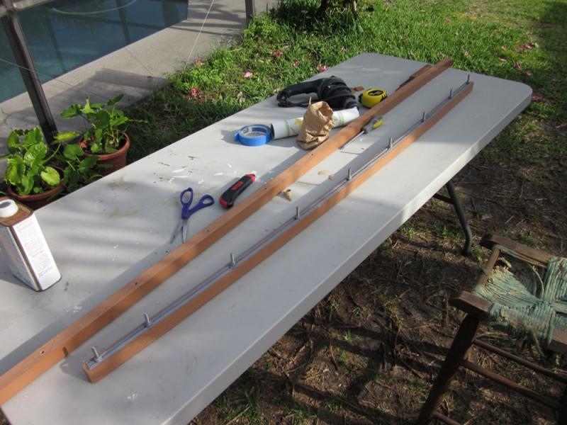

Definitely check the prices and get samples of the manmade products to so you can make your own descision. I was happy with the Azek look, color, etc for $3.08/board foot.
Oct 26, 2005
2,057
- - Satellite Beach, FL.
Yeah, especially when you can get 2 toe or hand rails out of one length!
This is a pic is a section of my toe rail, with screws and bedded, ready to install. I used butyl tale from Maine Sail and was VERY pleased that there was no goop to worry about or clean up.
